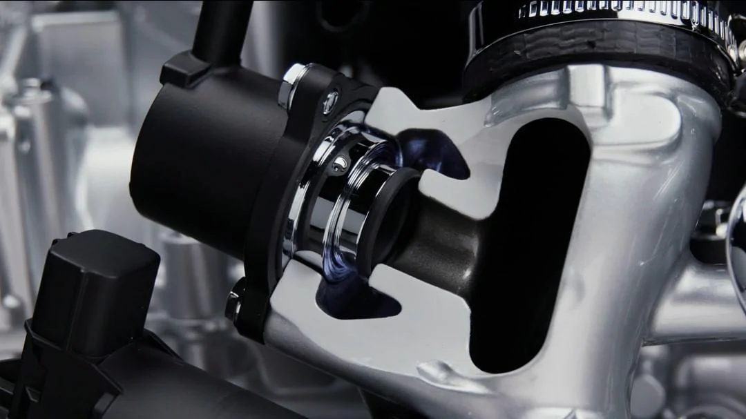

Better surge protection for the turbos, that added boost relief is huge and now BOVs are optional.
Possibly larger impellers, I know with the Qs you can go up to 30% bigger with the stock housing - More gains possible from bolt-ons and it also means stock won't be as stressed.
It appears that the Z is the first in Nissan lineup to have the turbo diverter valve, same principal as BOV. The euro guys (e.g. VW, BMW, Benz) have been messing with the technology and do a bit of mod to get the BOV effect (venting to atmosphere) for the sound.
