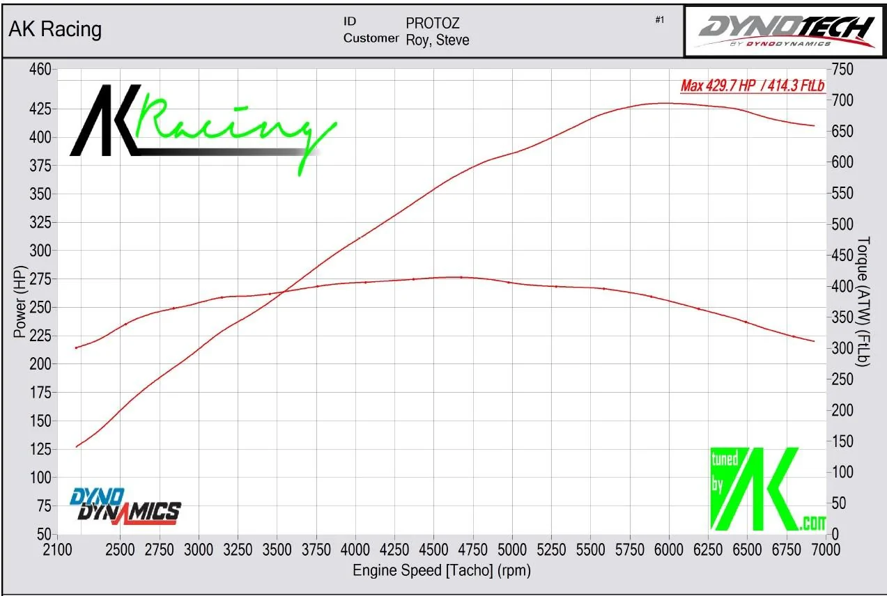

I have been building this up slowly, and testing a lot inbetween modifications, but I'm happy to say that I think I've finished with my 'Stage 1' mods.
I had no pre-planned order to approach this, but just wanted to change one thing at a time that I felt the car needed. In order, this was:
* Coilovers with 1" drop, by MCA Suspension (MCA Reds)
* Custom 3.5" catback exhaust, with Varex valve, by Rob Bliss Exhausts
* Z1 carbon intakes by Z1 Motorsport
* Custom 2" downpipes with 200 cell cats and 2x hotdog resonators by Rob Bliss Exhausts
* Varex Smartbox valve controller
* Tune by ECUTek and AK Racing
The team at AK Racing did a baseline dyno when the car was effectively stock - before I even did the catback exhaust. Then we basically dyno'd it after adding each of the above, again just to baseline without tune.
All of the below are measured at the wheels, and on Australian 98 octane pump fuel (equivalent to US 93 I think?)
The original baseline numbers were 275kw/458nm.
The final number for this 'stage 1' were: 320kw/561nm (429.7hp / 414.3ftlb)
Attached a clean dyno for reference, but I also have a chart that compares the runs at 3 different stages. I'll get this up tomorrow.
I've also thrown up a couple of videos in case anyone is interested. I absolutely love the way this exhaust sounds. Threw on a crackle tune for fun too :)
One thing we noticed is that the first pull was always the best. consistently lost 3-5kw per run. Definitely an issue with heat soak. I've started working with local fabricators to make up intercoolers, heat exchanger, oil cooler and radiator. I'll get these done, dyno again, then swap to E85 to round out my 'stage 2' in the next few months.

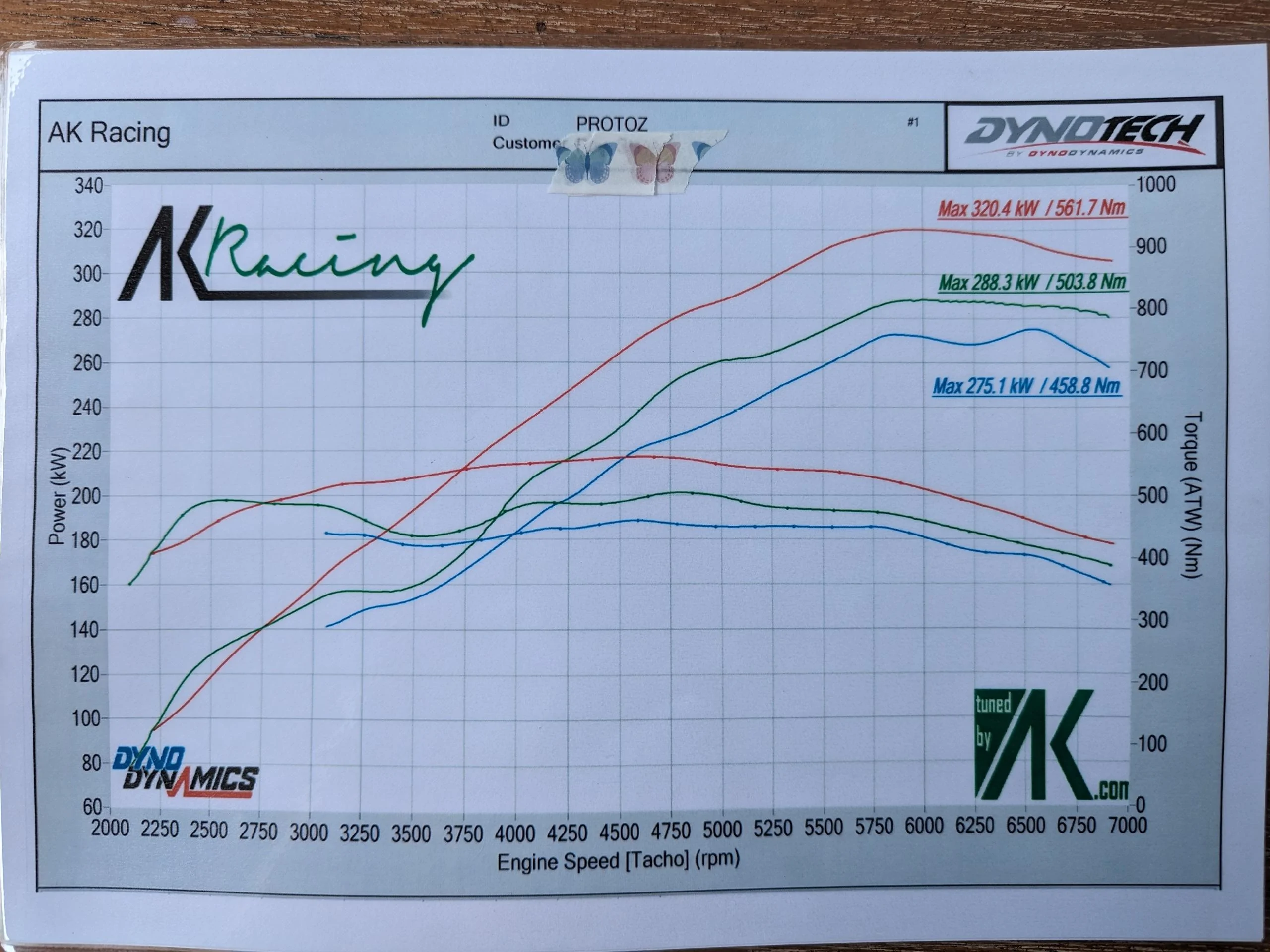

Good, step-wise approach and good numbers. Have a chart of the stock curve to compare, torque profile? What is your goal for the Z, street, autox, road course, drags?
Proto Z
Proto Z
Aug 12, 2022
379
698
Brisbane, Australia
Audi SQ7
Hey mate, dyno plots below.
The one that has three (for comparison) shows:
1. Stock
2. Intake/dp/exhaust, no tune
3. All tuned.
I would like 500whp. That is the only number I'm chasing.
Can easy get more from this platform, but I'm just wanting to build something drivable.
I will track it occasionally just for fun (I'm a shit driver) but really just want a jap muscle car. Not traditional JDM, but just something that looks a bit tough and has the performance to back it up.
I'm also keen to experiment and use as many local techs/fabricators as possible.

45kw and 100nm is no slouch mate. Proof is in that curve though. Well done. How's the butt dyno?
Proto Z
Proto Z
Aug 12, 2022
379
698
Brisbane, Australia
Audi SQ7
Thanks mate, I was happy with this- especially since it was still a relatively safe/conservative tune.
The real story is that curve, as you say.
Driving the car it doesn't feel noticeably more powerful, but man it's smooth now.
Power available at every point in the rev range, and if you roll on from a standing start it feels incredibly more linear now. That word "linear" may not be the adjective some people were hoping to hear, but it's amazing how confidence inspiring the predictability of the power delivery can be.
For me, personally, I'm ok with a shit ton more power, but it can't come at the cost of drivability. The way it provides power now is very encouraging, but you always feel very much in control of that power. Honestly couldn't say the same with the stock setup/tune.
NOTE: I've also done suspension, sway bars and bushings, all of which add to the more compliant road feel. I have not done tyres yet, but changing out rubber and also brake pads and braided lines are all on the way!
