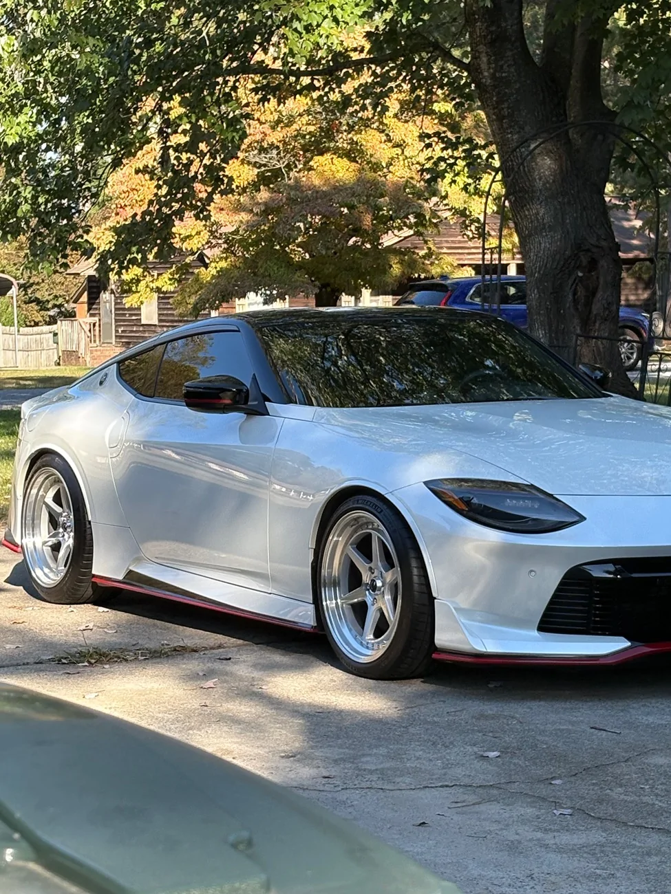

Hello, looking to pick up a set of winter rims and would like some advice since I believe these should work but don't know 100%.
My winters are 295 on the rear and 265 front. Car is lowered on Swift springs. Thanks.
19” Aodhan DS02 Staggered Wheels – 5×114.3
* Front: 19×9.5 +30
* Rear: 19×11 +22
* Bolt pattern: 5×114.3 (5×4.5”)
* Staggered setup
* Previously mounted on Infiniti Q60

they'll work
conservative but thats fine for winter beaters
they're aodhans so who cares what happens to them

I have 19x11 rears with 285 tires, 40mm offset with a 25mm spacer. So effectively a 15mm offset. Clears fine with RSR Down springs, have room to go wider.

I have the same setup as (2cool) . I really just wanted the black wheels off the car so I bought the Aodhans because I’m eventually trade my 24 for the new manual Nismo. I’m on swift springs too.

I grabbed the rims and the rear is 11" wide inside and 12" outside. My summer extreme contact sport 02 is 295/35/19 is only 11" wide max on the stock performance wheel. Will the lips be exposed and the tire a bit stretched on the wider rim?
My winters contiwintercontact are the same size, but 12" wide.
I bought white rims thinking they would be more suited for summer, but should I put the winters on the larger rim? By the way, the offset seems good without the spacers.

You should be fine looks great in white! I have mine in track alignment which really tucked the factory wheels in but the aftermarket wheels just sit perfectly flush.
