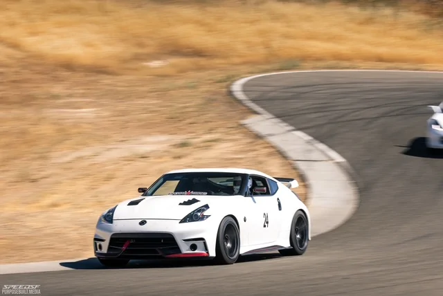

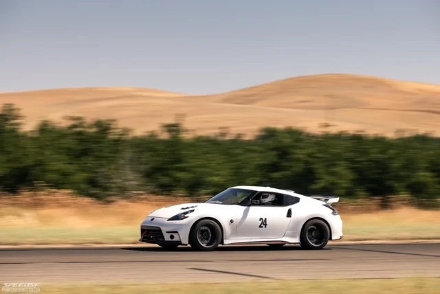

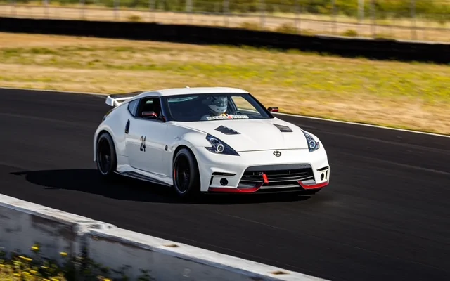

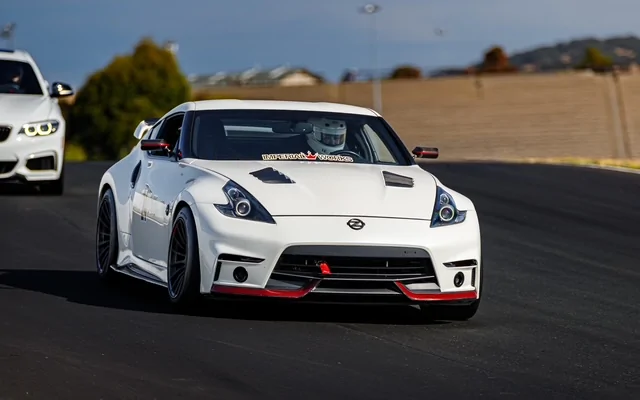

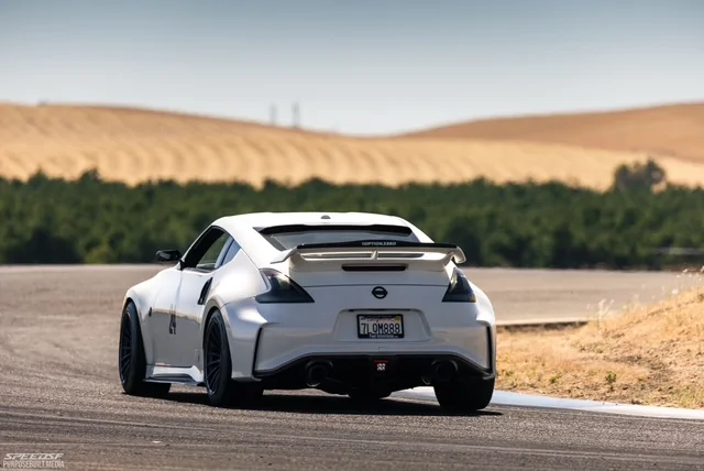

What lowering springs and are you using camber plates? I have nismo version, not sure if it needs those.
lowering springs? No sir
Topline Aragosta Type-S coilovers
SPL Parts all adjustable arms
The Z has double wishbone front suspension, which does not use camber plates. Those are for MacPherson Strut design cars like the S chassis, EVO, WRX, GRC
There is no front camber/caster adjustment on the Z, you must get Front Upper Control Arms, with SPL parts or nismo rebrand recommended

If you were aiming this at me, I'm running MCS coilovers. Ultimately, you'll see 99% the same clearances no matter what you use to lower in terms of coilovers. You may see some inner rub running stock front suspension as the springs are wider if you're going to go really aggressive, but I can confirm the 285's will fit just fine on the front with a +22 offset without any rub at all on oem suspension.
Optionzero is correct that camber plates don't work for our cars. Adjustable upper control arms need to be used. I'm running the Z1 forged arms, which I'll be selling soon here so I can experiment with the SPL as a comparison, but truth be told I expect them to be the same performance in the end. For clearance purposes they will all be the same.

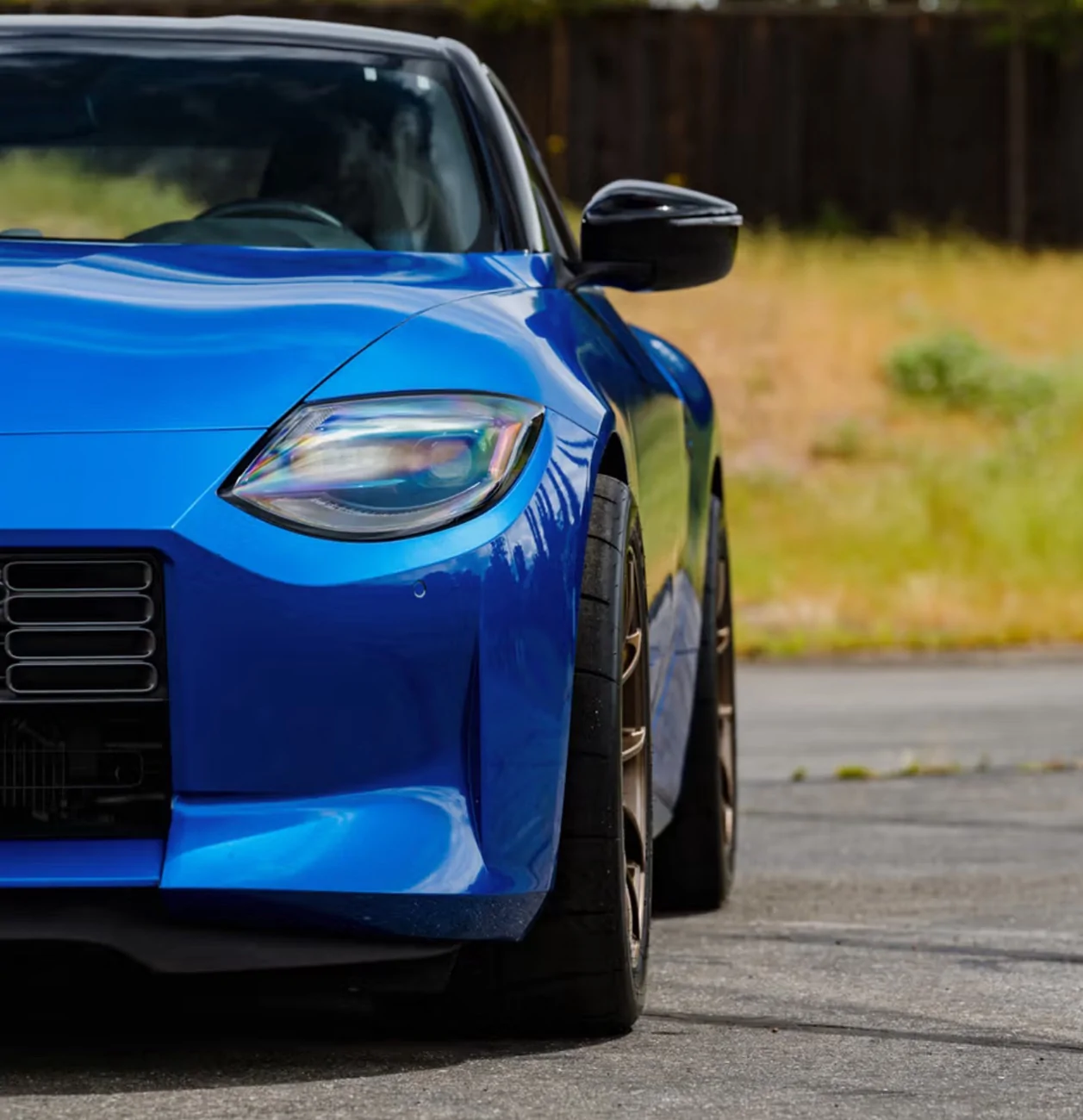

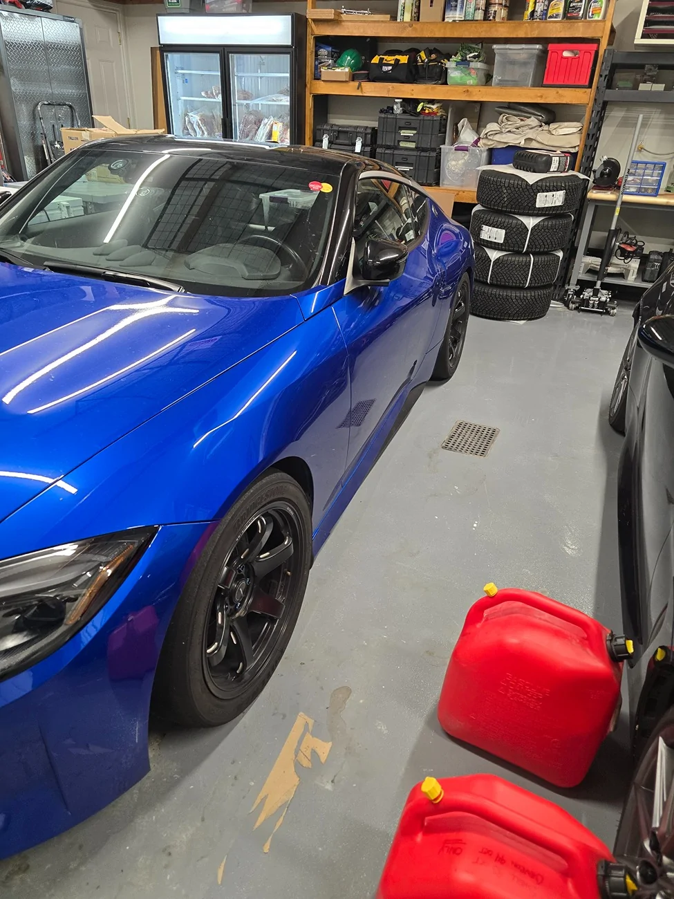

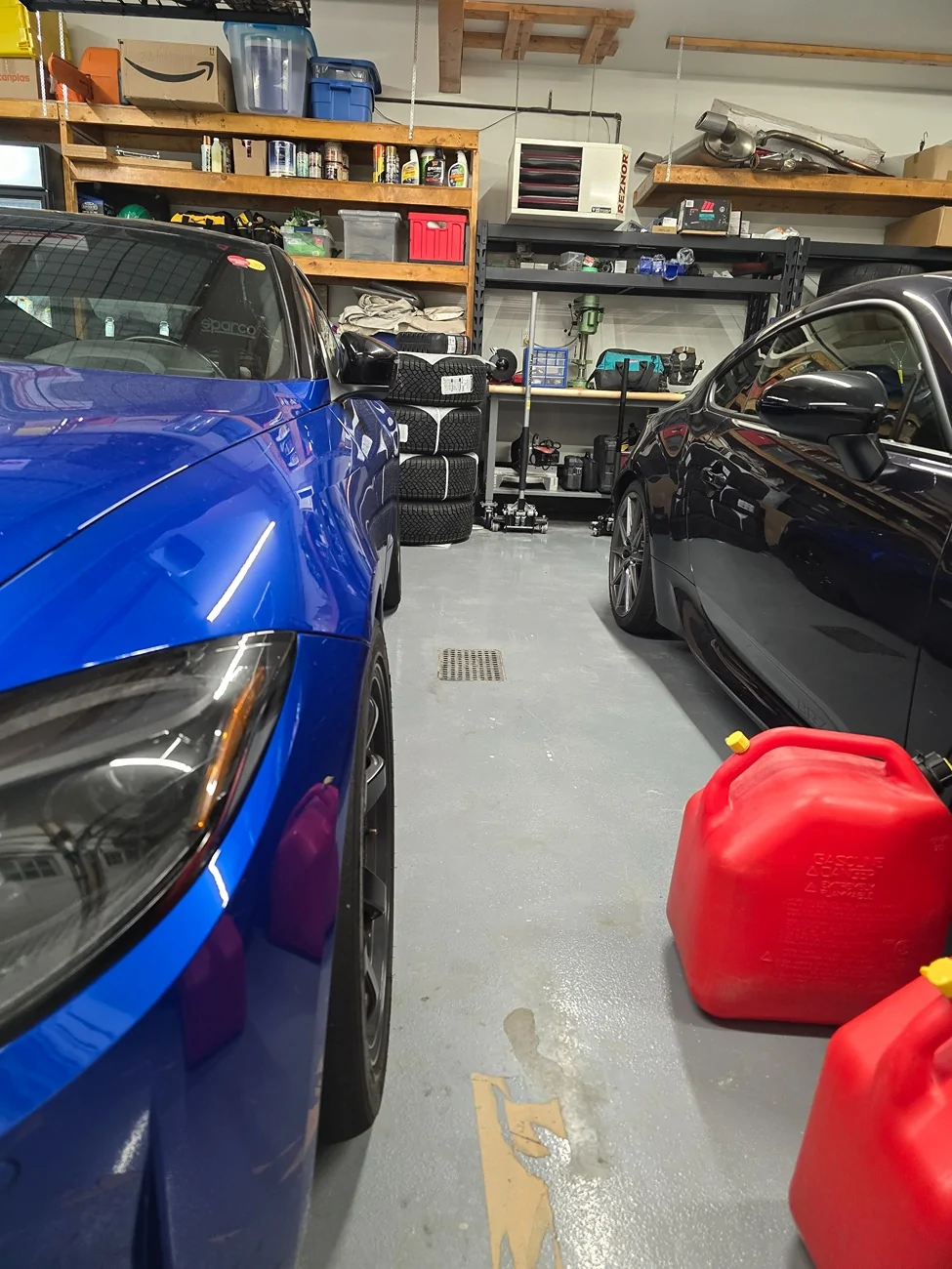

It's amazing how much difference it makes with no camber. Mine are just tucked a bit at the top with -3 camber on +22 offset with 295 wide tires. I snapped some quick pics in the garage. Hopefully these are good enough angles to be useful to you.
You think this setup would fit with stock suspension, but with FUCA's for the negative camber

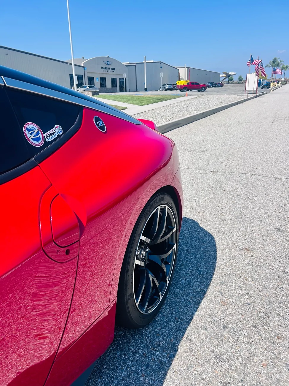

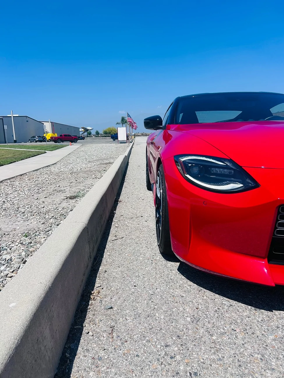

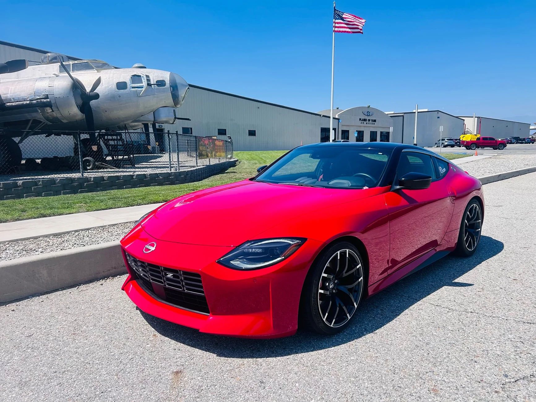

For those new on this thread, here’s my fitment on 19” Nismos which is similar to 18” when dealing with widths and offsets. 19x10.5 +23 V2s square on 255/275 RE71-RS with maxed OEM alignment settings (front camber non-adj) no spacers. Plan to put on 285s square, still plenty room.

Is this with stock suspension/height?

Nope, with Swift springs, spec'ed at 1.1 to 1.2" lowered. That's why front camber is more negative because of the lowering, double wishbone geometry, it's non-adjustable without aftermarket camber arms. I plan to get SPL next step.
