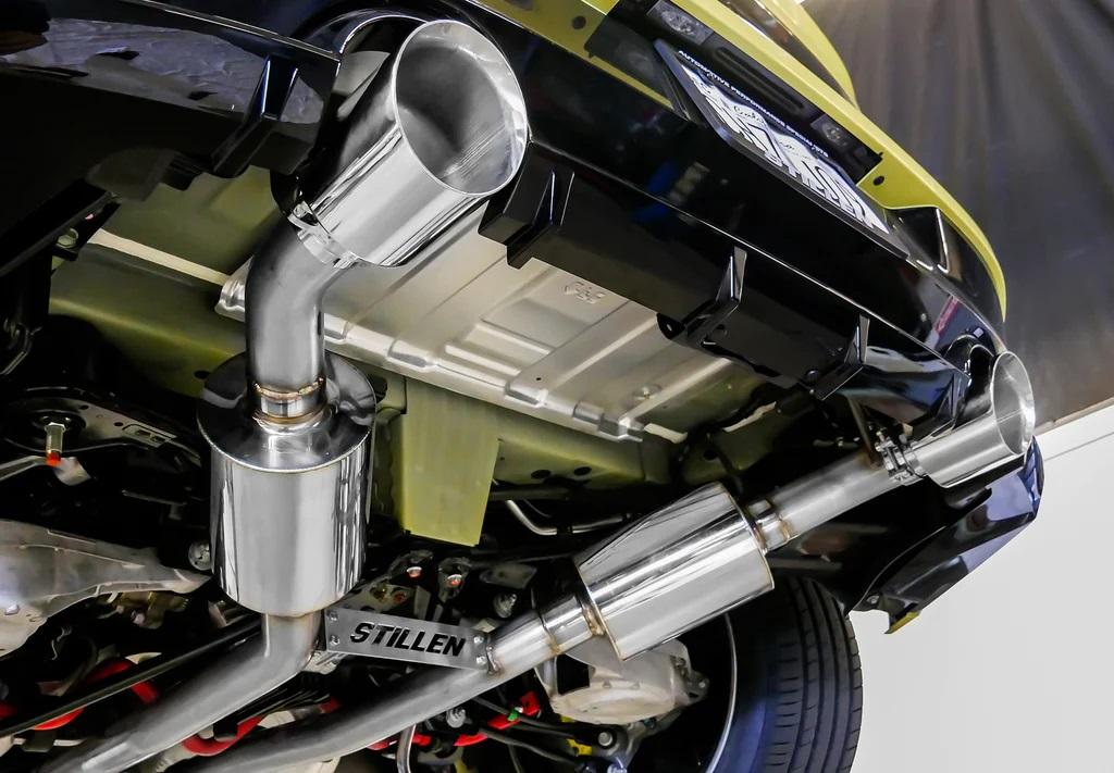

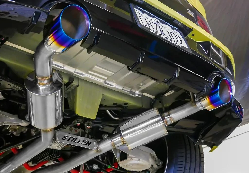

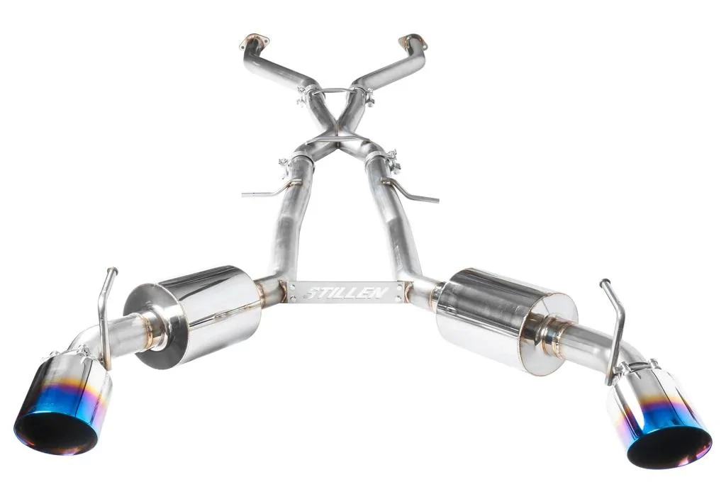

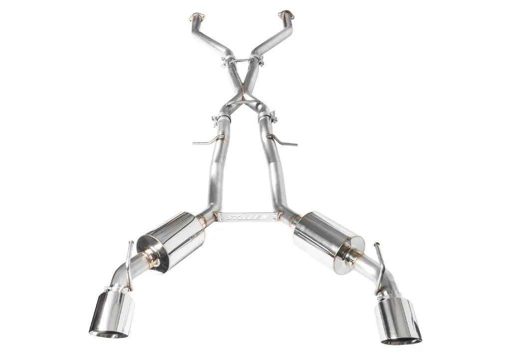

After months of exhaustive testing the team determined that the best design starts with a stainless steel flange precision tig welded to 2.5” tubes leading into a CNC bent and CNC machined X pipe. During the development the team tested a true dual exhaust system and determined that it was too loud and too “flat” sounding. Something very common with twin turbo V6 engines. However, in an effort to get the best performance possible we did not want to restrict the engine by going from dual 2.5” tubes to a single 3” mid-pipe. The perfect solution was an X pipe which offered a cross-sectional area of around 4”. This allowed the team to merge the left and right banks which improved the sound tremendously without restricting the exhaust flow. Additionally, it allowed the team to fit the largest possible collector through the narrow chassis tunnel in the center of the car.

"However, in an effort to get the best performance possible we did not want to restrict the engine by going from dual 2.5” tubes to a single 3” mid-pipe. "
vs
"There is no substitute for physical validation especially when it comes to the Nissan’s VR30 Engine. Numerous Infiniti Q50 and Infiniti Q60 Cat-Back Systems were tested through dyno pulls and extensive data logging. STILLEN’s rigorous procedures even included testing different merge angles between pipes. The result of STILLEN’s rigorous program found a “Y-Pipe” layout similar to what is found on the Nissan GTR VR38 Engine produced the best result.
Jun 25, 2019
"Having developed a wide range of prototype exhaust systems our engineering team hit the dyno to see which configuration produced the best results. After all of the tests were completed, we were a little bit surprised to learn that the best exhaust system was lying in front of us the whole time. The twin turbo V6 Nissan GT-R favors a dual into single back to dual configuration and after our testing was complete we learned that the Infiniti Q60 VR30DDTT does too. This exhaust system features a 2.5” Y pipe which flows into a 3” mid-pipe. The 3” mid-pipe then carries the exhaust gases to the rear of the vehicle where it branches back into 2.5” dual rear exit. "
-Feb 18, 2019
So was Stillen's validation off from 3+ years ago, or are they just responding to customer demands?
