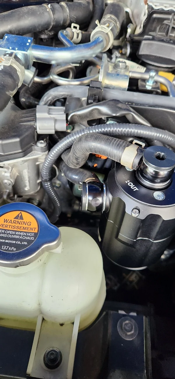

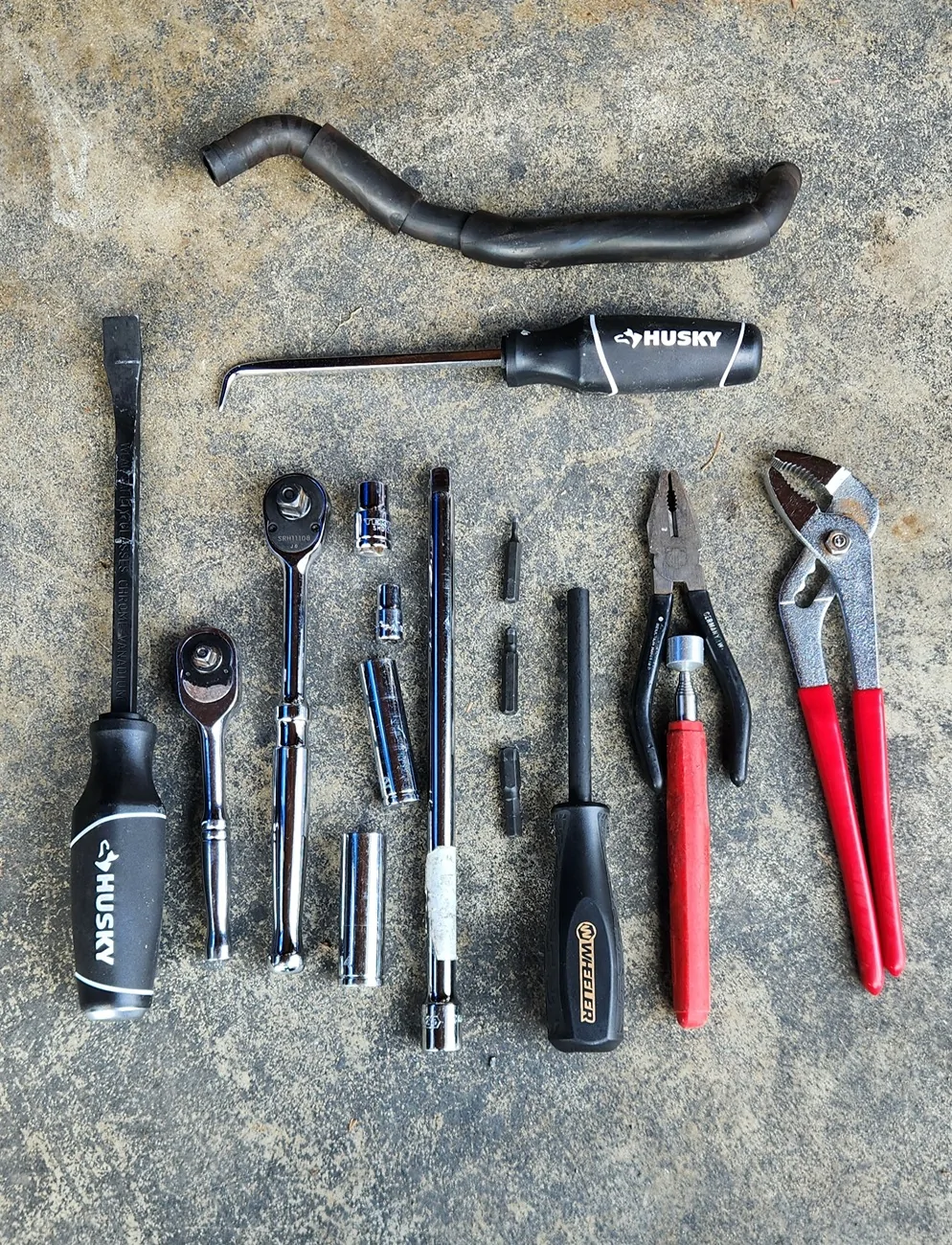

I reused the OEM clamps. They fit great. Dont use the supplied allen screwdriver. Its not the same fitment as the allen head screws. I threw mine in the garbage. Tools I used in the pic, and you may not use them all. Pry bar will be your friend when installing the lower coupler to the bottom of the intercooler.
If you get snake style hose clamps, get the ones for the fuel lines. They are smooth on the inside and wont chew up the hose
