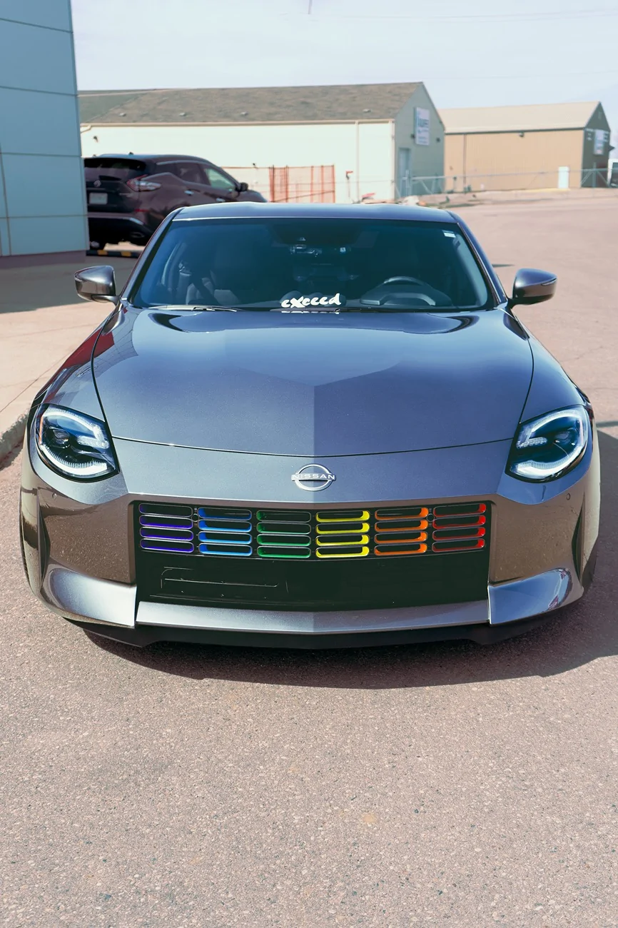

Since no one else will ask, what's with the grill?
