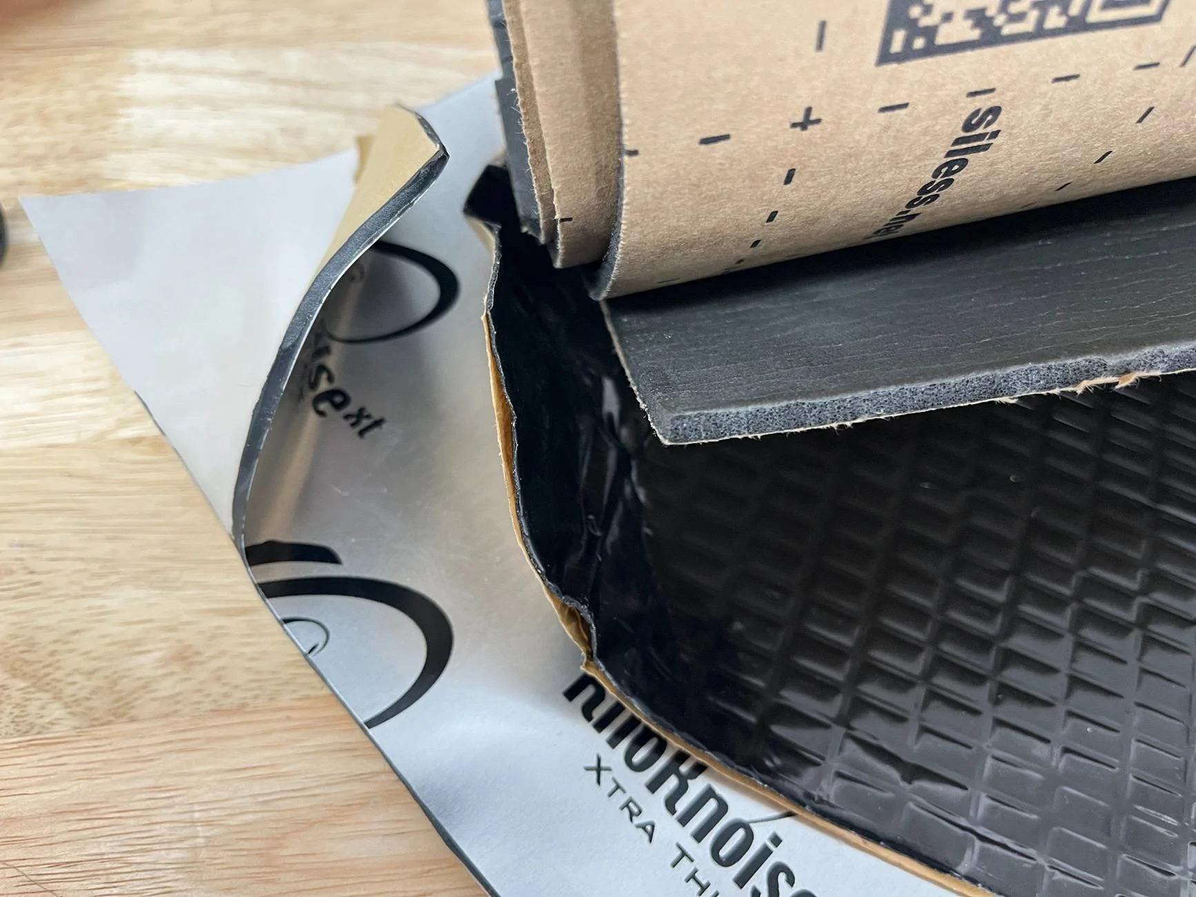

The puffy stuff you used might have been closed cell foam, I use that in certain areas as a supplemental layer or I use cut down strips of it to hold down factory wiring in places where it looks like it might be wiggling around. 98% of what goes down is the thin aluminum/rubber butyl backed sheets. None imped fitment of clips, carpet, seats etc.
Here is a pic of what I used on the Z:
Far left is absurdly thick at 120mil/3mil. This doesn't sound like a lot but it's a bear to roll so I only buy a little of this and affix cubes here and there to build up the thinner stuff as needed. This stuff works very well.
Middle is the workhorse, this is about 50mil and really easy to cut and roll out. You can mold this stuff into position with your fingers. It all should be rolled of course but its very easy to work with.
Far right is the closed cell foam I mentioned above. It doesn't actually deaden all that well by itself but synergizes very well with the aluminum rubber butyl backed products.
