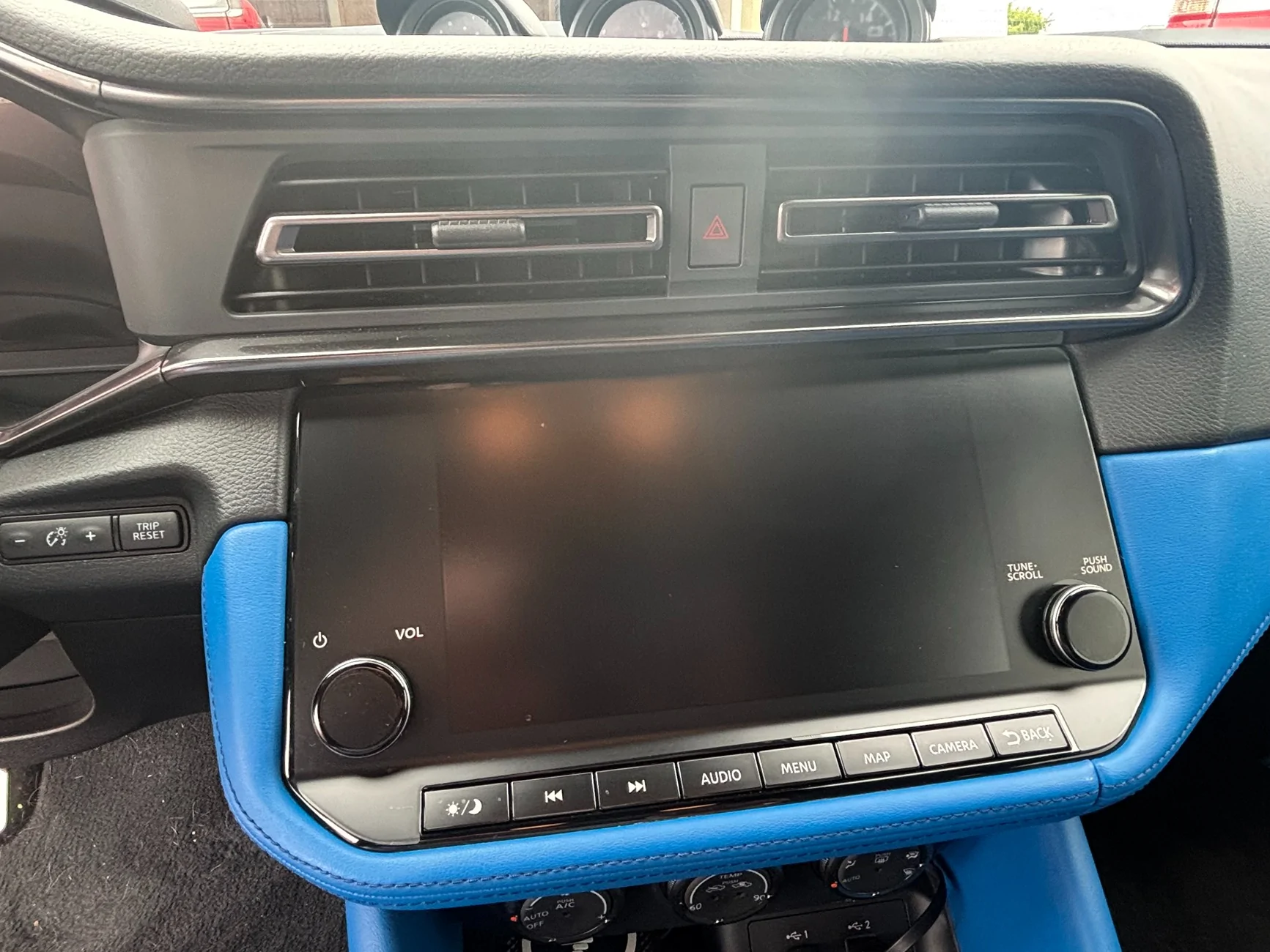

    • Infotainment screen: Went on smoothly and was easy to align using plenty of slip solution.
    • Buttons: Used slip solution (avoided the tack/plain water method to retain adjustability, per instructions). Alignment was finicky, but the slip solution worked well for fine adjustments.

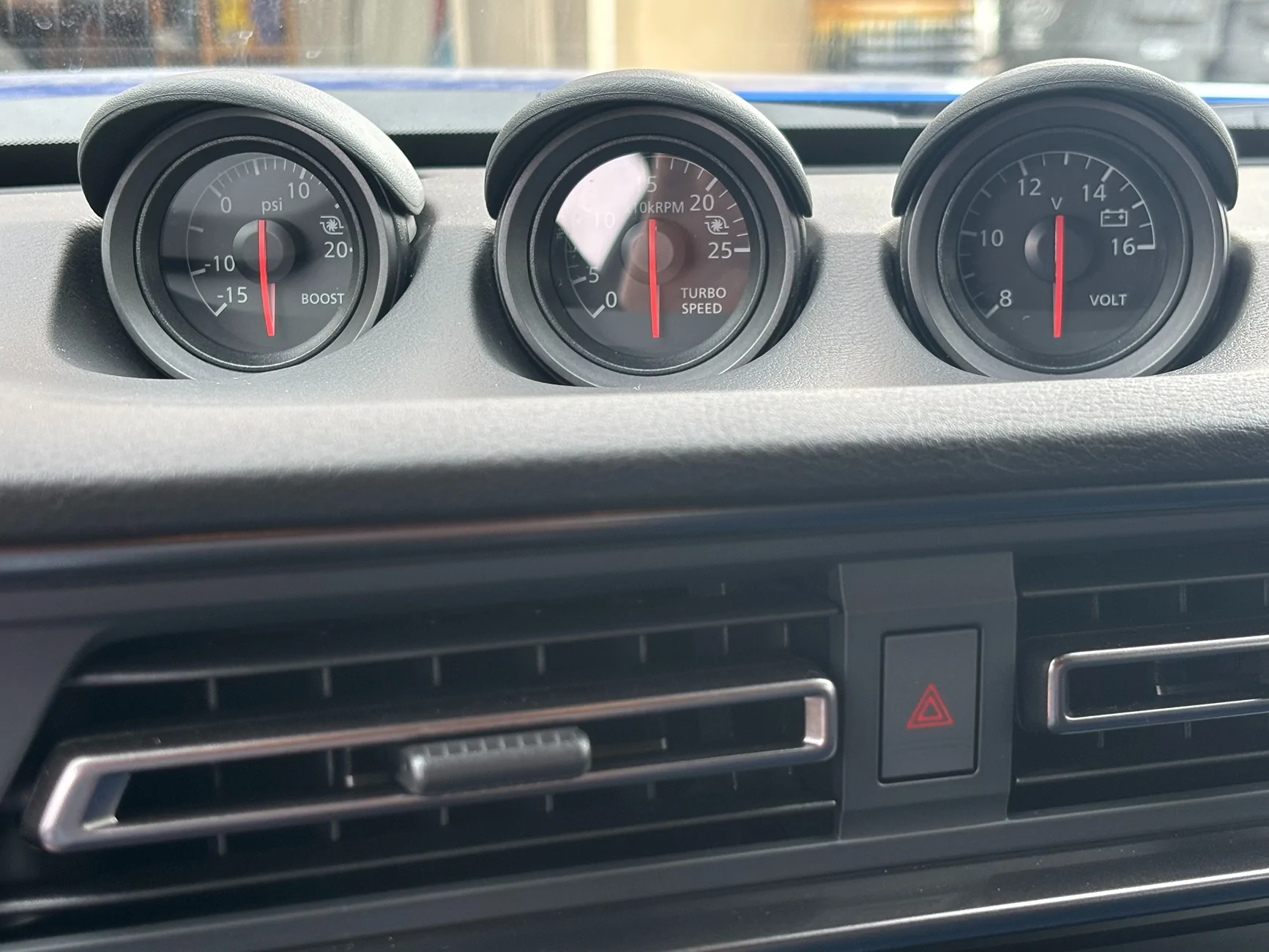

    • Center gauges: Difficult to center and to remove air bubbles. I couldn’t use the supplied squeegee, so I used a soft‑edge pry tool and my finger. I wasn’t sure the matte film would suit the center gauges, which are clear lenses rather than layered, backlit LCDs.

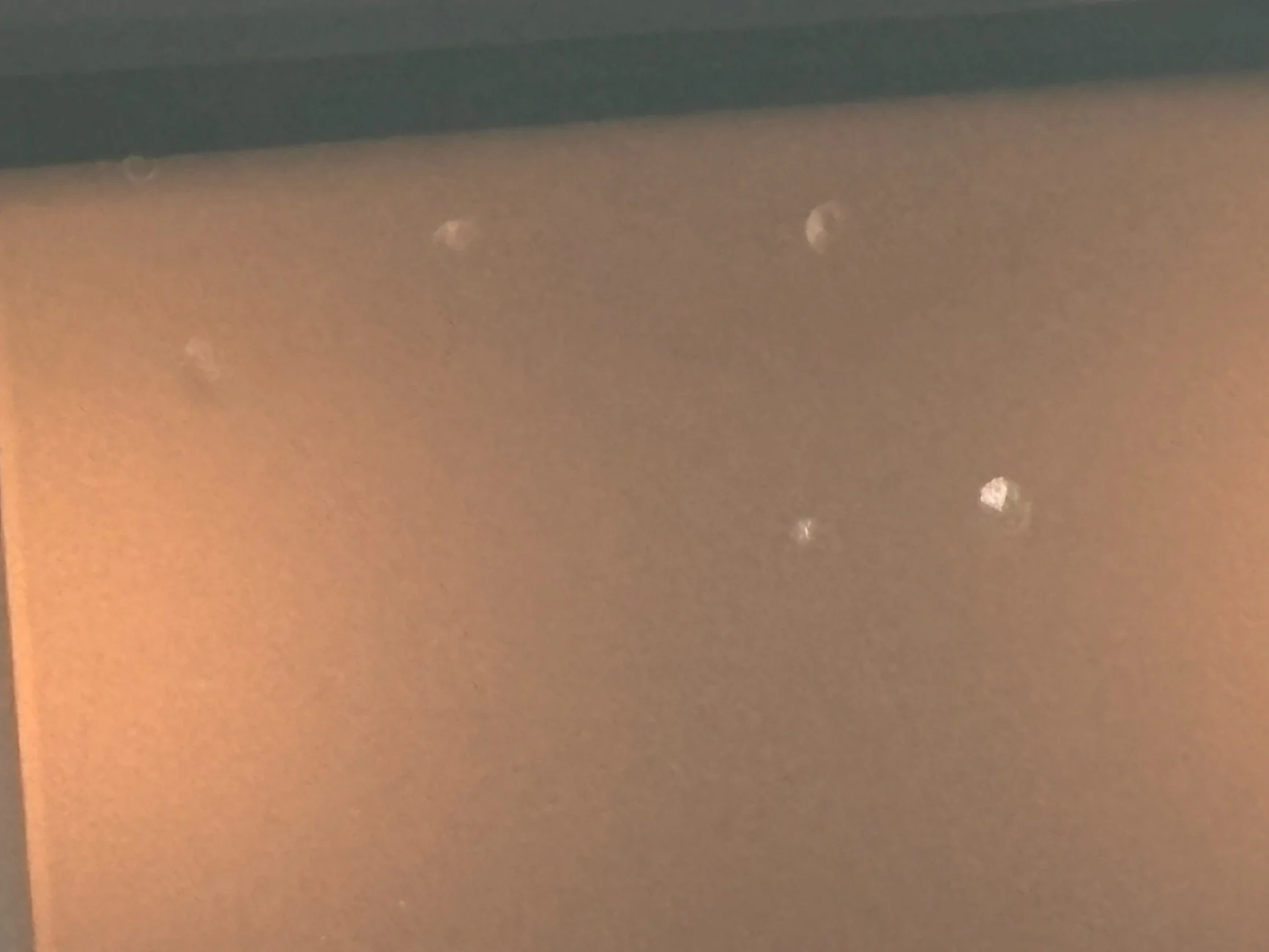

    • Small bubbles appeared on most surfaces. I resisted the urge to adjust. The instructions say this is normal and that bubbles usually dissipate after a few days.
  • After 1 week:
    • All bubbles disappeared without using a heat gun. I did leave the car in the sun for a day or so to warm the cabin.

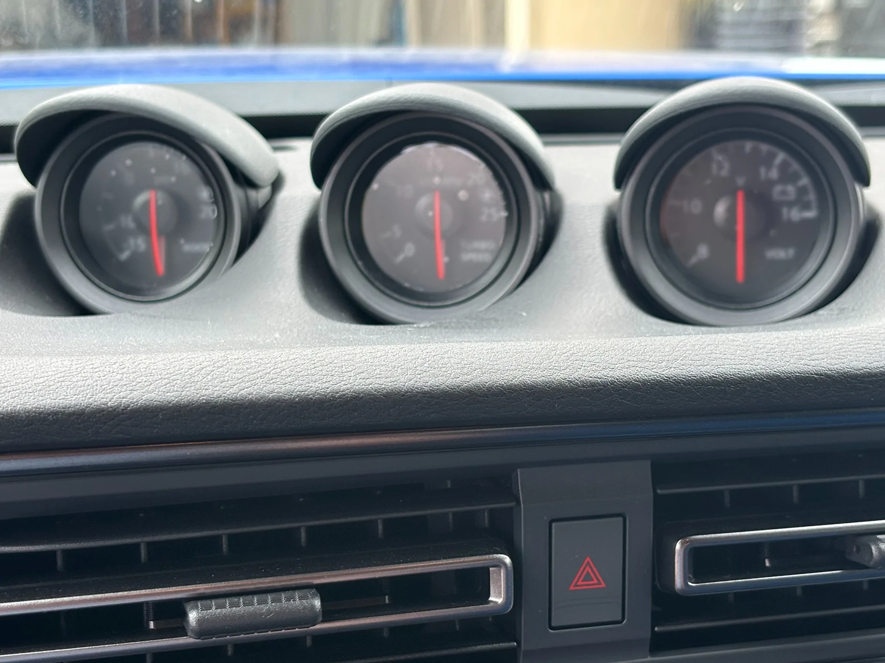

  • Center gauge outcome:
    • The center gauges did not turn out well. Even after a week, some bubbles remained, and the matte film made them hard to read. I do not recommend matte PPF on the gauges.
    • Removal: I warmed the cabin in the sun, used slip solution where possible, and (with my wife’s fingernails) lifted the film. Some residue remained, but a little moisture (spit) and a very soft cloth removed it. I’m leaving the gauges stock.

    • I’m happy with the overall result: no fingerprints, no bubbles, and only a slight reduction in infotainment screen resolution—worth it to me.
