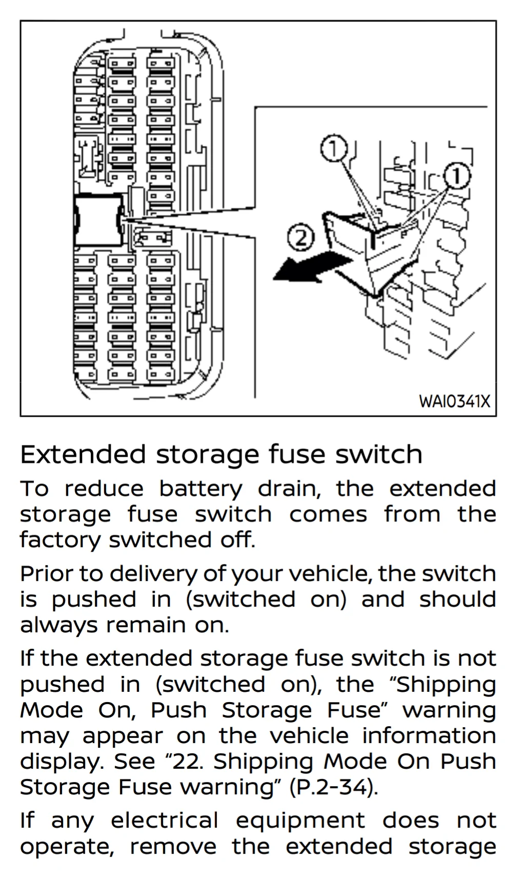

I was driving in Williamsburg last night and I randomly lost some of the car electronics and this error popped up on my dash.
"Shipping mode on push storage fuse"
I pulled over and looked in the driver's side fuse box. I didn't see anything out of sorts, and when I started it up again the error was gone as randomly as it appeared.
So I guess I am good for now but wondering if this is an indication of some electrical issue I should look into further.

There's a section in the manual about this. It might guide you to the specific area of the fuse block to inspect.
