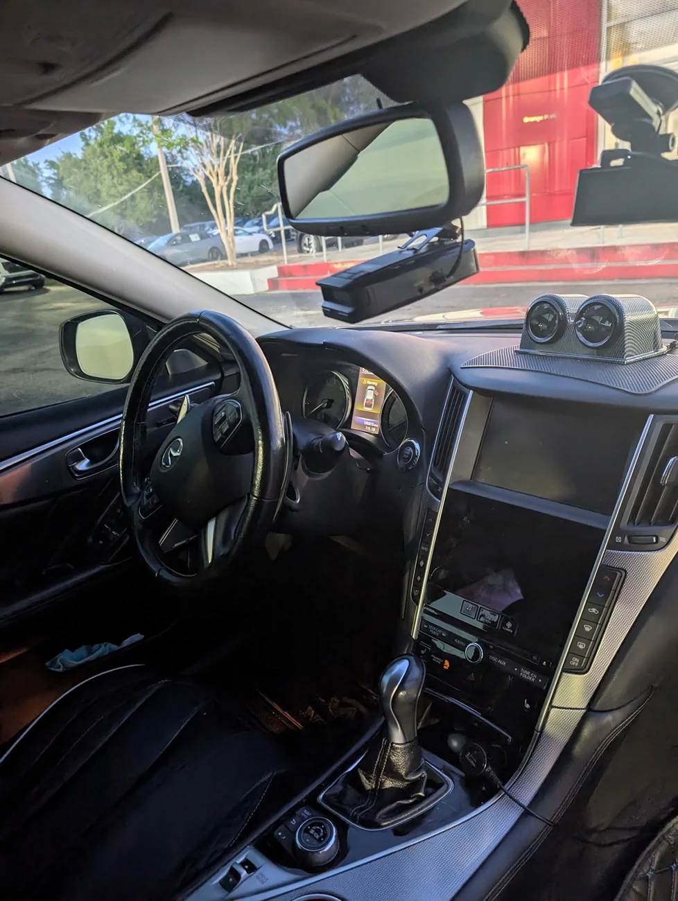

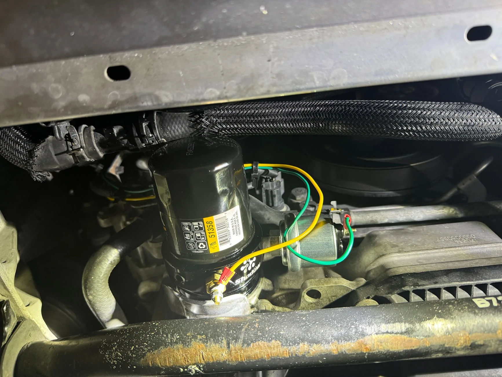

I want to watch my oil pressure and it is my understanding that only manuals get the oil pressure on the sports dash and there is no way to change this, even if I had to pay the dealer. Wanted to absolutely confirm this before I moved to other options.
If it's not possible to change the gauge than I would want to swap the battery voltage meter for oil pressure. I know two ways of doing this.
1. Oil filter sandwich plate with a standard NPT port and the wire ran up to the gauges. I ran it this way on my q50 and it was pretty easy so I could just copy that.
2. Posi tap into the current oil pressure sensor from the front of the engine, maybe follow that wire all the way up and not have to run the wire all the way down.
Attached are pictures of what I did with the Q. It was more about function than form...On the Z I want to make it look good.
