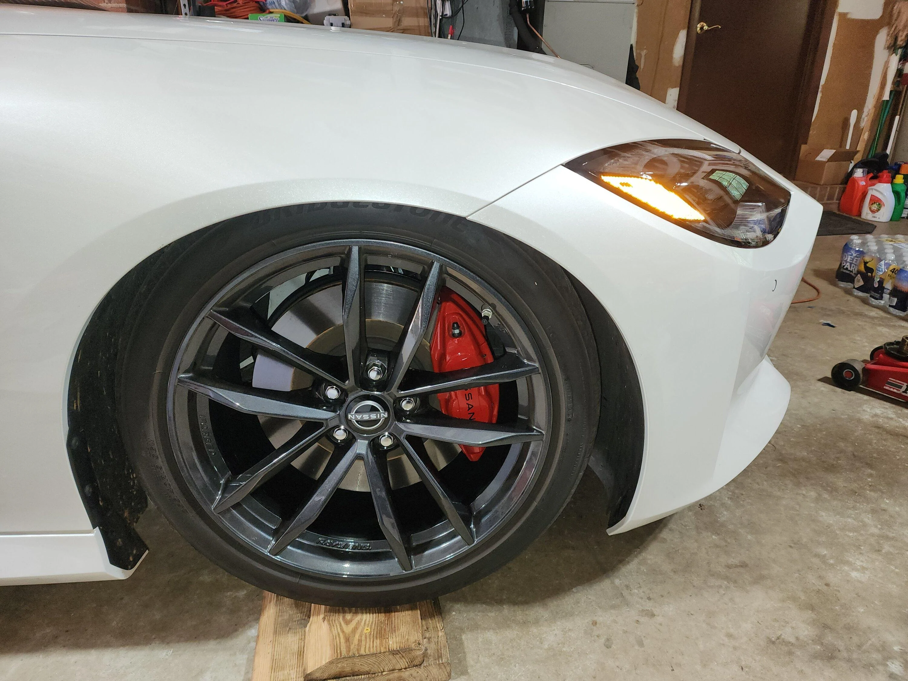

They feel great. Apples and oranges compared to the factory suspension. Adjustment is easy considering you really only have coilovers on the front. The shock spring setup in the rear is easy to adjust. I found that I could not fall within the "spec" range on the instructions. To get any clearance. I bought mine from nissan wholesale direct. So I don't think they did any setup before I got them. This was the ride height out of the box. Right at the min, 13in from center hub to fender.

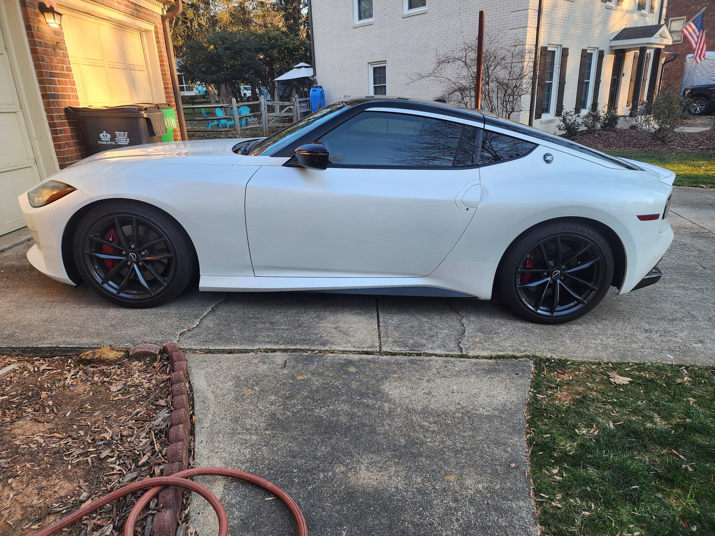

I did get what I was looking for as far as ride stiffness adjustability. They give you 16 settings. You can set it to feel like a skateboard, or just as almost as soft as factory. The spring rate will never let it feel as mushy. Ride height is a little different. You would get more adjustability with rear coilovers over the shock spring set you get for the rear. That being said the front on the other hand you can slam all the way down so you can get your of your driveway. But if you only want to drop it a couple of inches and still be able drive the car, the nismo coilovers work great. I've not come across any camber issues. Where there was not enough adjustment. This is how I have mine set up at the moment

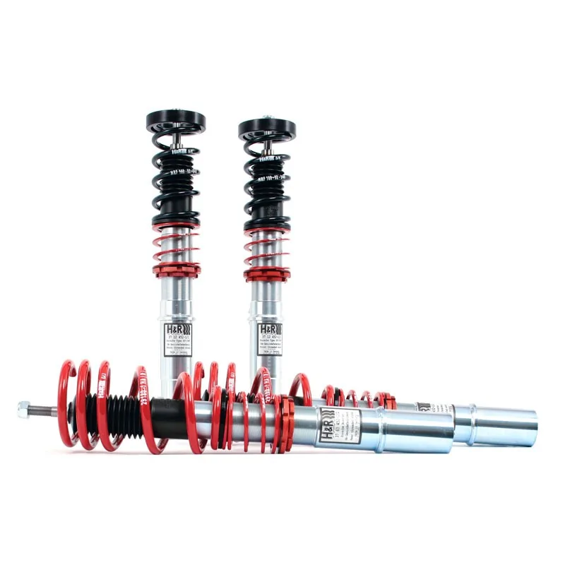

They look like H&R rebadged to me..
