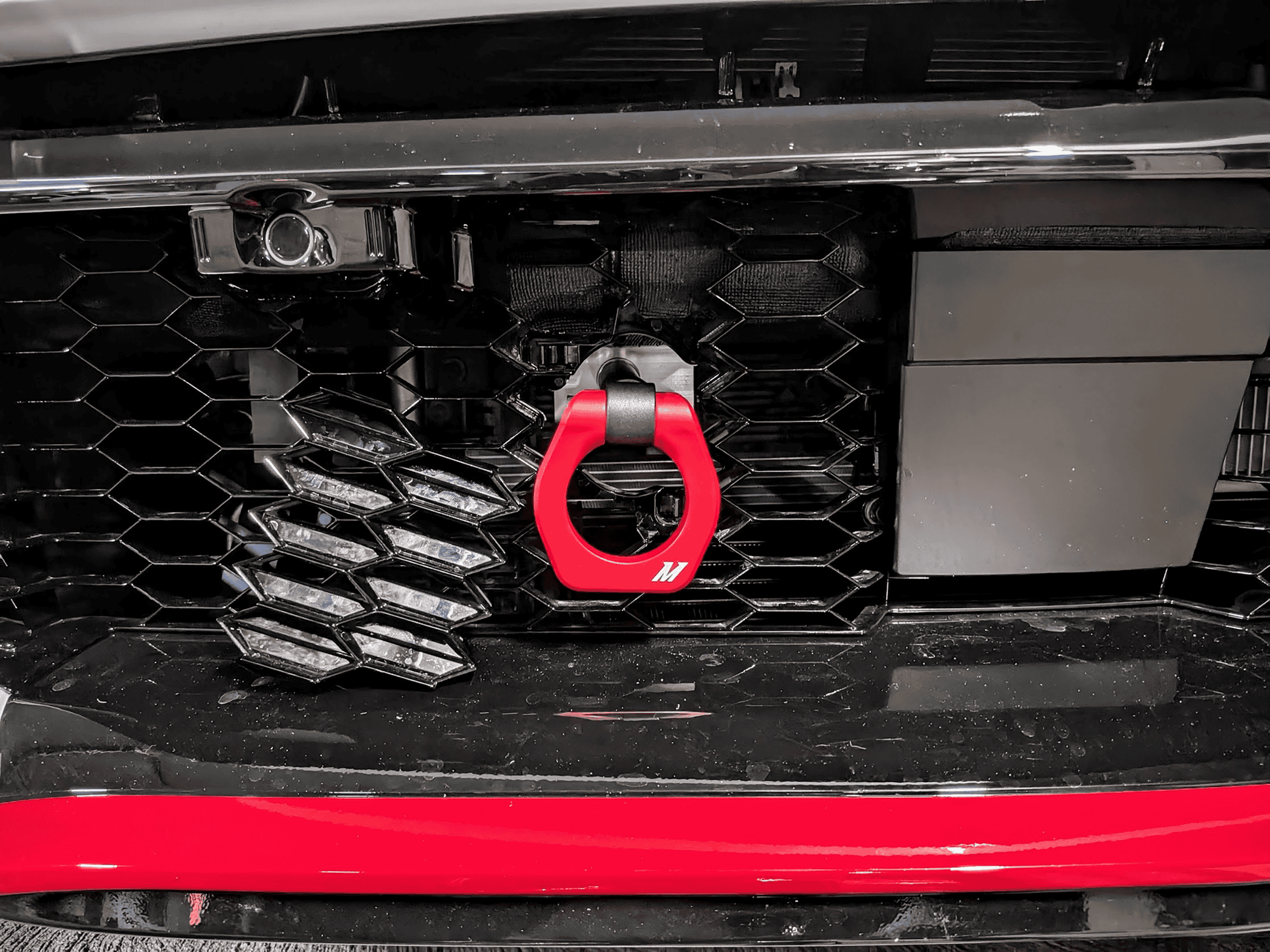

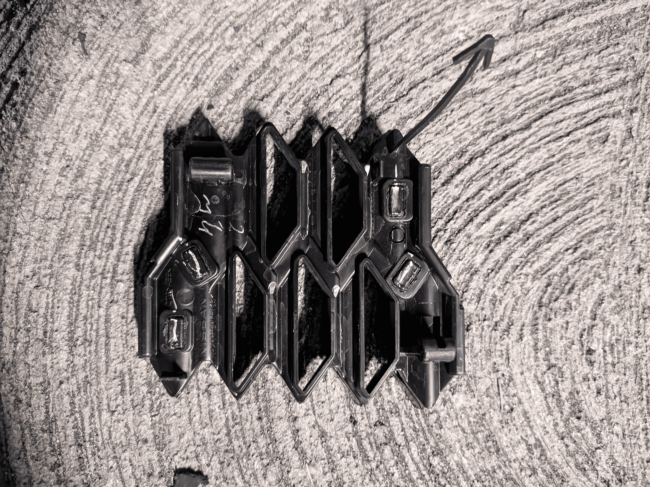

I had the same question about the tow hook. Baffled how it is not included.
I took the risk and bought a Mishimoto tow hook to test fit. It just clears. Odd how the front part is clipped on. It looks like I can remove it with some effort but don't want to break it off.
See pictures below.
I took the risk and bought a Mishimoto tow hook to test fit. It just clears. Odd how the front part is clipped on. That does not feel right for a track day. It looks like I can remove it with some effort but don't want to break it off.
See pictures below.
Thanks! It's hard to tell what's going on with the clips, but it looks like it's clipped on the top left and the bottom right. Did you just grab that piece and pull it straight out using brute force? It feels like it's going to break, so I stopped. Is there a trick?
As far as the door hanging, that tether should have an arrow on the end to prevent it from falling off. You can probably pinch the "arrow" closed to remove the tether and cover completely. I wouldn't leave it hanging like that because you can lose or damage it if you drive the car like that.

Yeah it is two clips, top left and bottom right. I was also nervous about breaking it. Almost stopped, but it just did not make sense to me it would not come off, so I pulled harder and it came off.
Right you are about the end. It is an arrow and does seem like it can be pinched close to pull out.
Perfect, thanks!
Do you happen to know the overall length of the Mishimoto tow hook? I am trying to figure out how it compares to the OEM one

Thank you! It is definitely a decent amount longer than the stock one. I think the stock one was 7 or 7 1/2" +/-. It's quite a difference. I'm second guessing if the stock one will fit, because the nose is a little longer on the Nismo.

It turns out I did receive a stock tow hook with my car. It was in a package with the front license plate frame I did not install. So now I have both to compare.
You are correct. The oem tow hook is short. It does fit but barely. I don't think I would be comfortable with using it although I do think it would perhaps work.
I
I also did remove the cover fully. It is not hard once I worked it out.
I
Thank you so much for going above and beyond to help me out!
That's exactly what I needed to know. I wasn't sure that the stock one would fit with the extended nose, but it looks like it would (but barely, lol)
