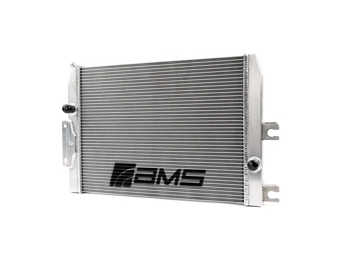

AMS- 198% core size and 200% fluid capacity @ almost $1000

AMS
$950
2x thick (32mm?)
198% core size vs. stock
200% fluid capacity

I've installed the AMS on mine, i've seen the Mishimoto and CZP first hand...
If I could go back, i'd for sure get the CZP. Welds were tight tight tight tight tight. And the core size was actually surprising. For something made in Indonesia, 100% Recommend
Mishimoto was questionable, the welds looked alright imho, nothing the be excited about, but i guess thats the qc you'd expect from China. Sure, designed and engineered in Delaware, but most of their products come from China
AMS, self explanatory, Welds were excellent (other then a pair of HFC a friend had ordered, it looked like a noob just getting into welding did them) Designed, Engineered & Made in Murica (f*** ya). ALTHOUGH not ALL parts are made in the states, so you'd have to check before hand.
TLDR. CZP best bang for buck

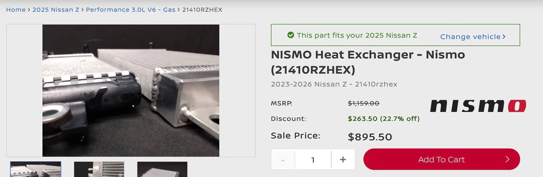

I think you can easily search around and find the Nismo one for $900. Ive had it over a year now on my 24 Nismo Z and the install was easy and it looks good. I think all will do the job, pick the one color matched to your preference (black or gray) and budget. Cheers
