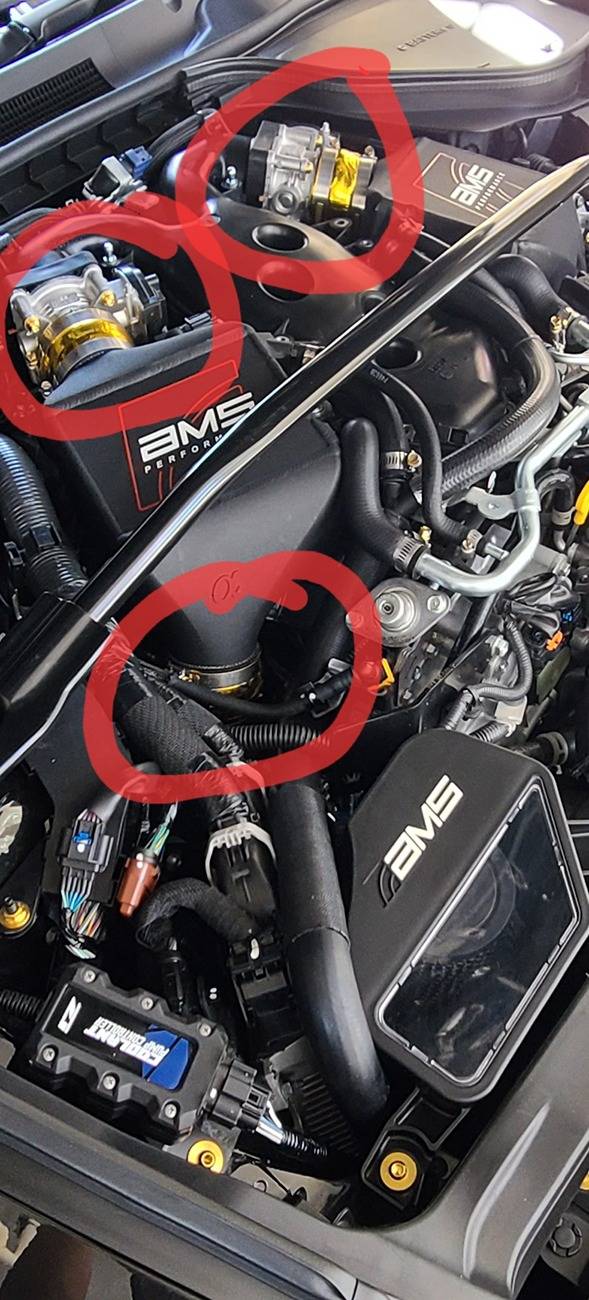

No knocking or oil pressure loss, still running normal. I noticed the car runs normally sometimes, then it does the same thing again. Which is giving me a ECU problem as a symptom. Other then that still going to check for exhaust leaks
By charge pipes I assume you mean these?
They're on pretty snug, the only other thing I can really think of is the throttle body to intake manifold
