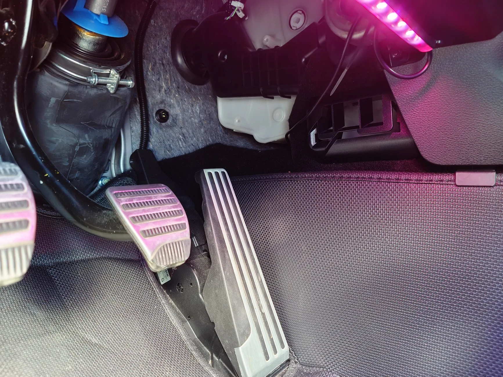

I just did this a couple weeks ago. There's a gap in the footwell that you can use, above the gas pedal area, that goes to the passenger side.
Edit: attached photo

Interesting. I ended up removing the cupholders, shifter plate and side panels and was able to thread the wires through that based on Nissans manual for their ambient lighting kit. Took a bit to figure out but once I had it it was super easy.
