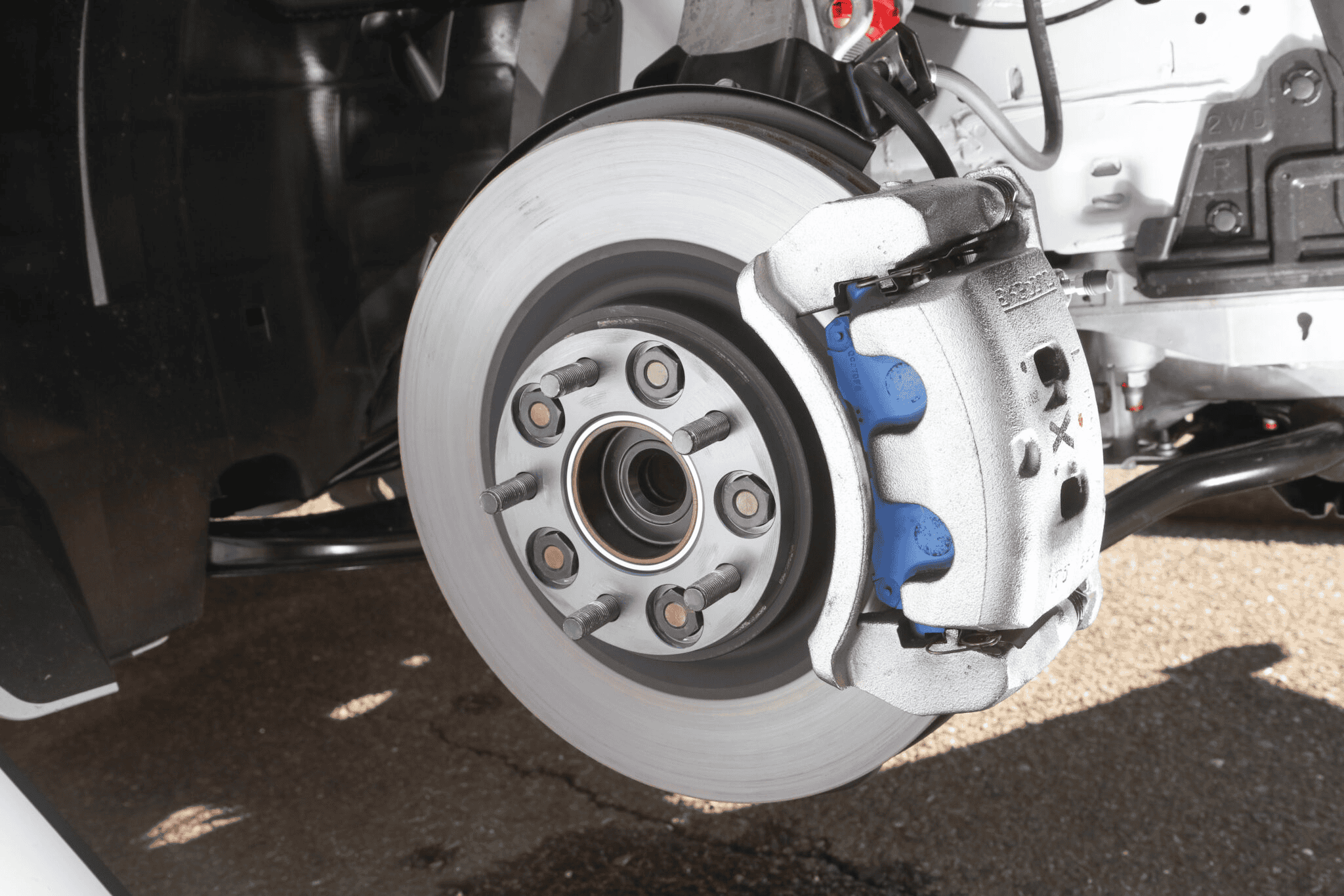

this car as a full time attack build but they are still rocking the sport calipers :confused:

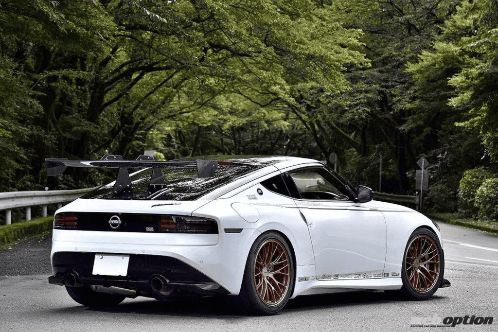

Very well done square setup, I'd go for that. Wonder if major fender rolling req'd?
70
2,035
4,344
Yep, nice setup: RW007 (19×10.5J+35)RE-71RS(285/35R19)
That's what I'm running in the rear as well. Decided to go staggered 265 19x9.5 in the front as Ill only see the track a few times maybe. I'm a rookie so does a square setup cause a dramatic difference?
Most are on an 18" sq set up. Removes some inherent understeer, you can rotate tires, much bigger selection of tire specs. A second set of back up tires or rain set up is much easier too. Plenty of street/race cars retain staggered set up... ie corvette, porsche, etc.
Jah_Happy
Feb 4, 2022
738
1,371
Gotcha. Appreciate the insight!
