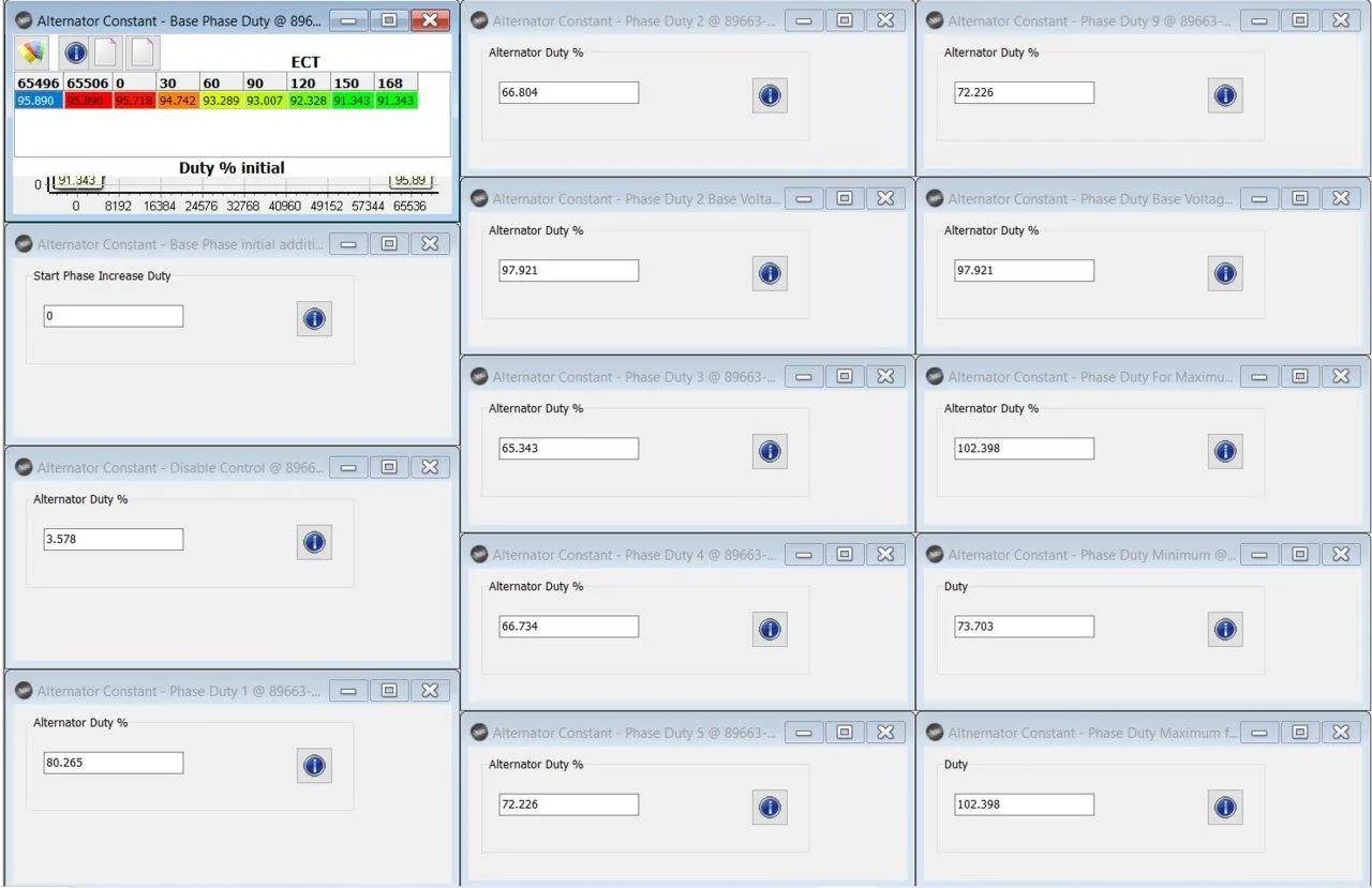

It usually requires a deeper dive than just the basic scanning tools allow, this is an example of the alternator duty cycle settings to adjust for an AGM in the 3rd Gen Tacoma.
