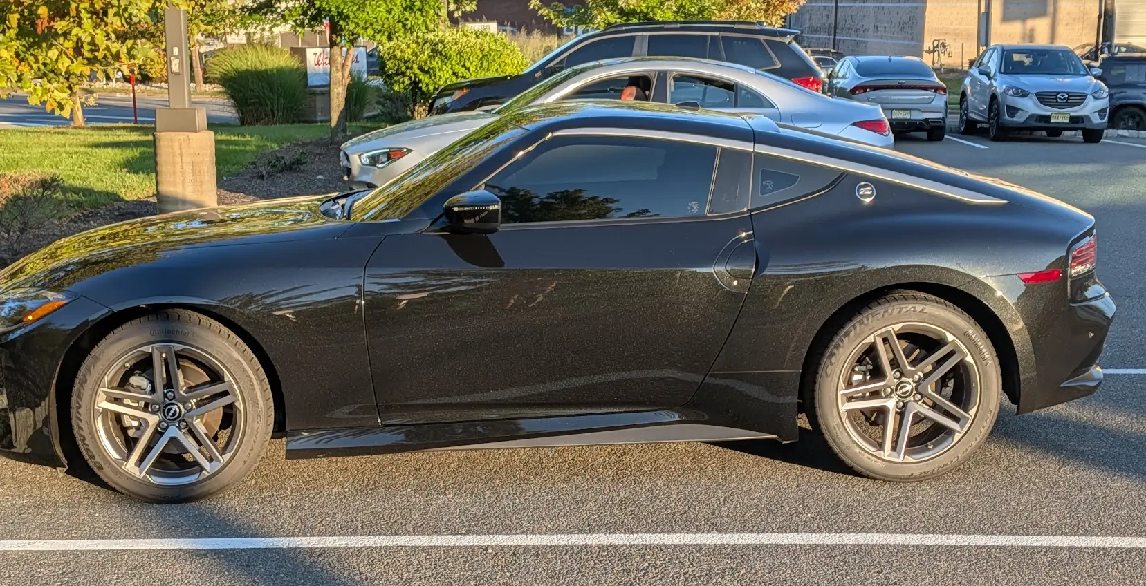

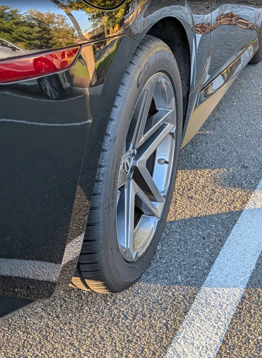

Looking good with the meaty tires 😎🤙🏽
The fronts are 245/45 the 275/40 are the same height. they just stick OUT a bit.
Might go with 18" rims with the correct backspacing to get rid of the gap. Will reevaluate then if I want to go lower.

Looks great! plus drive around all year and not to worry too much about NJ potholes.

10mm or 12mm spacers with your rear tire set up will be perfect. You will need to install 50mm extended studs

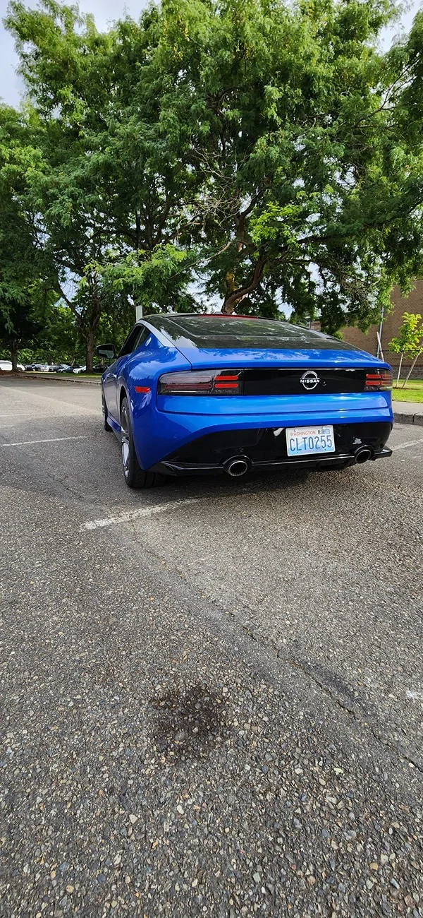

This is mine with 12mm rear with 245 for your reference on backspacing
15mm front is perfect with 245s. Im going to switch it up to 12mm fronts with 265 wide to keep the tires under the fender
