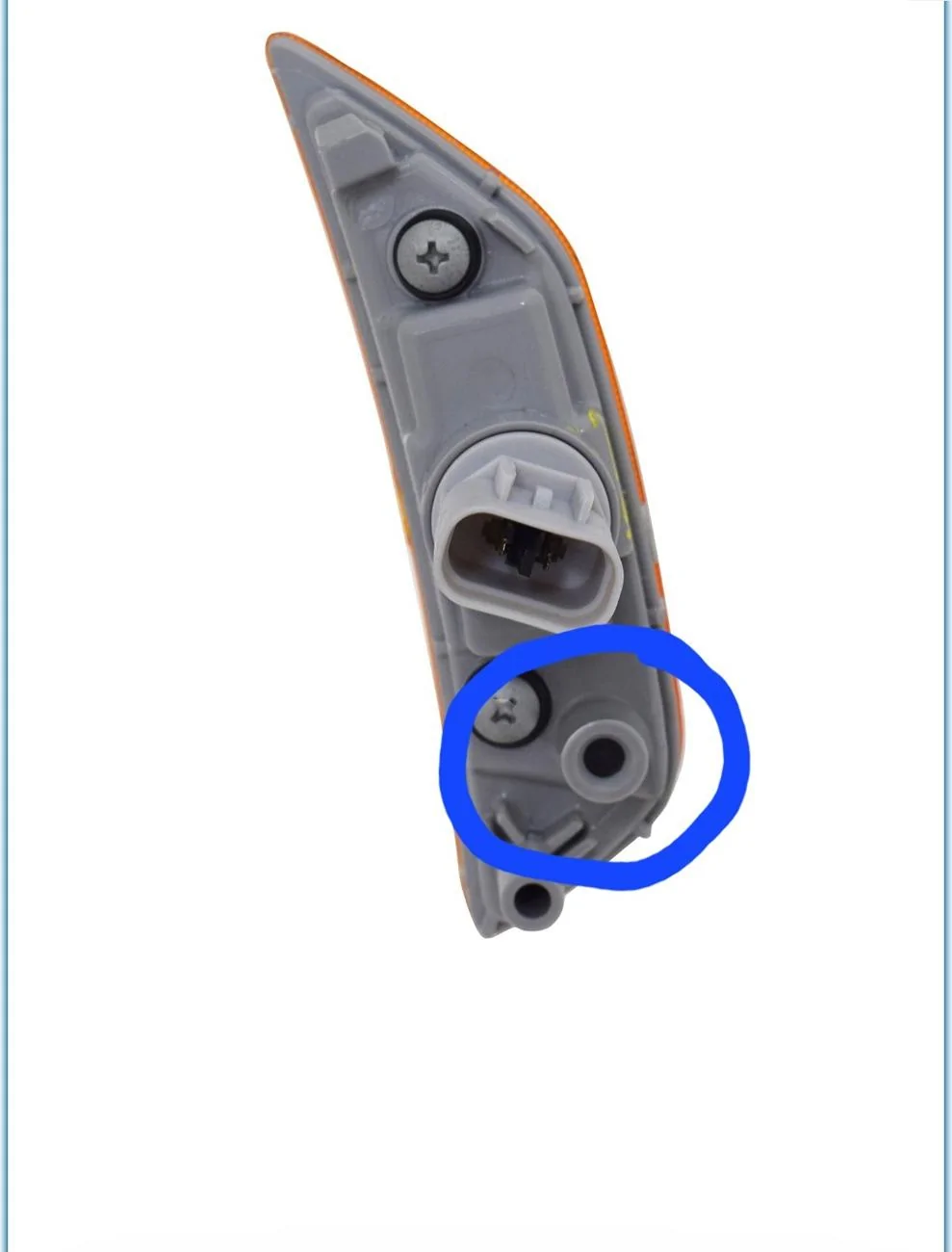

They are screwed into the bumper tab from inside the bumper. Screw/nut could be coming loose. Might see if you can get access to it from under the car. Otherwise, bumper removal is required
Here is a pic for example. Not a Z marker. Circled in blue would be where the screw would attached the bumper tab to the housing of the side marker
