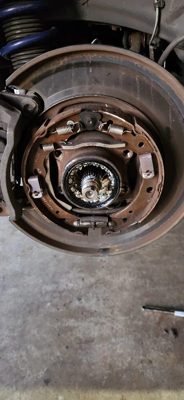

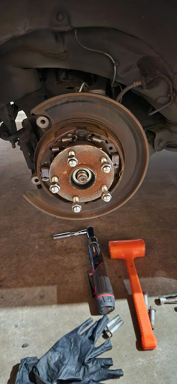

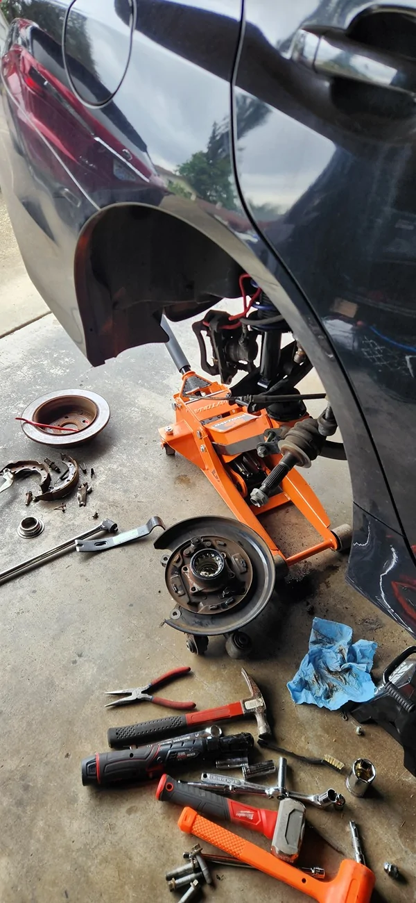

'16 WRX rear hub assembly wants to play games. Shit was screaming like a banshee down the road and needed to be done. I used a slide hammer and it pulled the inner hub and left everything else in the knuckle. Its fucking seized in there good. This method would have kept the ebrake assembly intact. I decided to not fuck with it anymore and removed the knuckle assembly and going to send it with a 20 ton press.
Should have removed the knuckle assembly to begin with, but all these video's built my confidence to take it on. To find out, there were more video's that showed me to never fuck with a Subaru again
