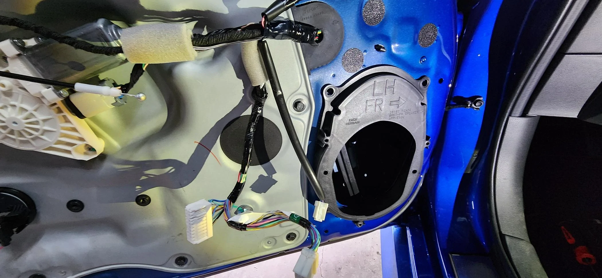

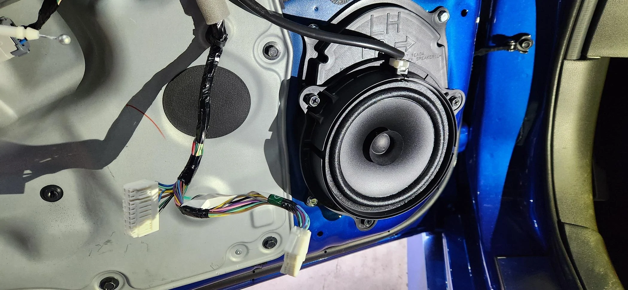

Heres some pics of the front on a Sport

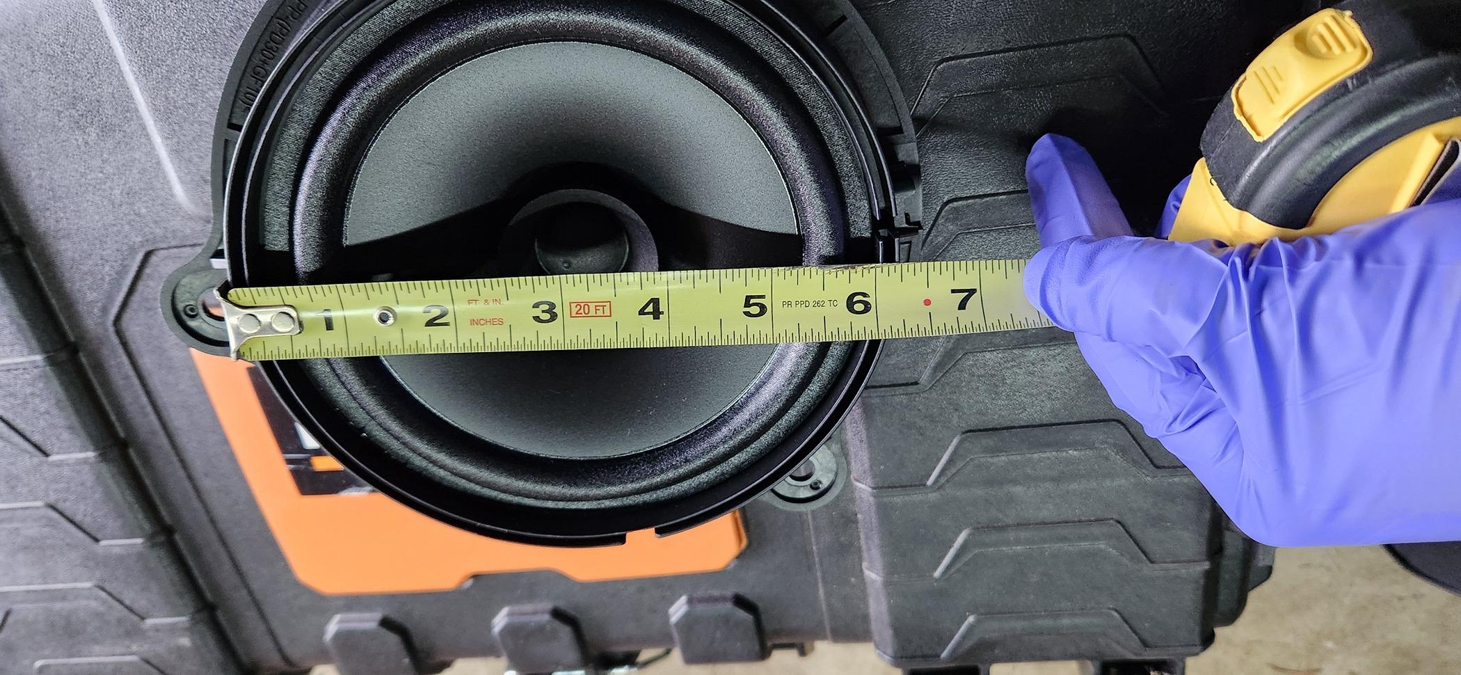

Quick update:
The rear speakers on the sport are 3.5". The size is 3.5". No more, no less. 4.5" is right out. [/Monty Python Holy Grail reference]
So, for SPORT audio. These are the speaker sizes:
- 3.5" rear speakers.
- 6.5" door speakers. (Need a new spacer, as the stock spacer is PART of the stock speaker).
- 2.5" dash speakers. (You CAN make 2.75" with a little modification to the clamp nuts.....)
