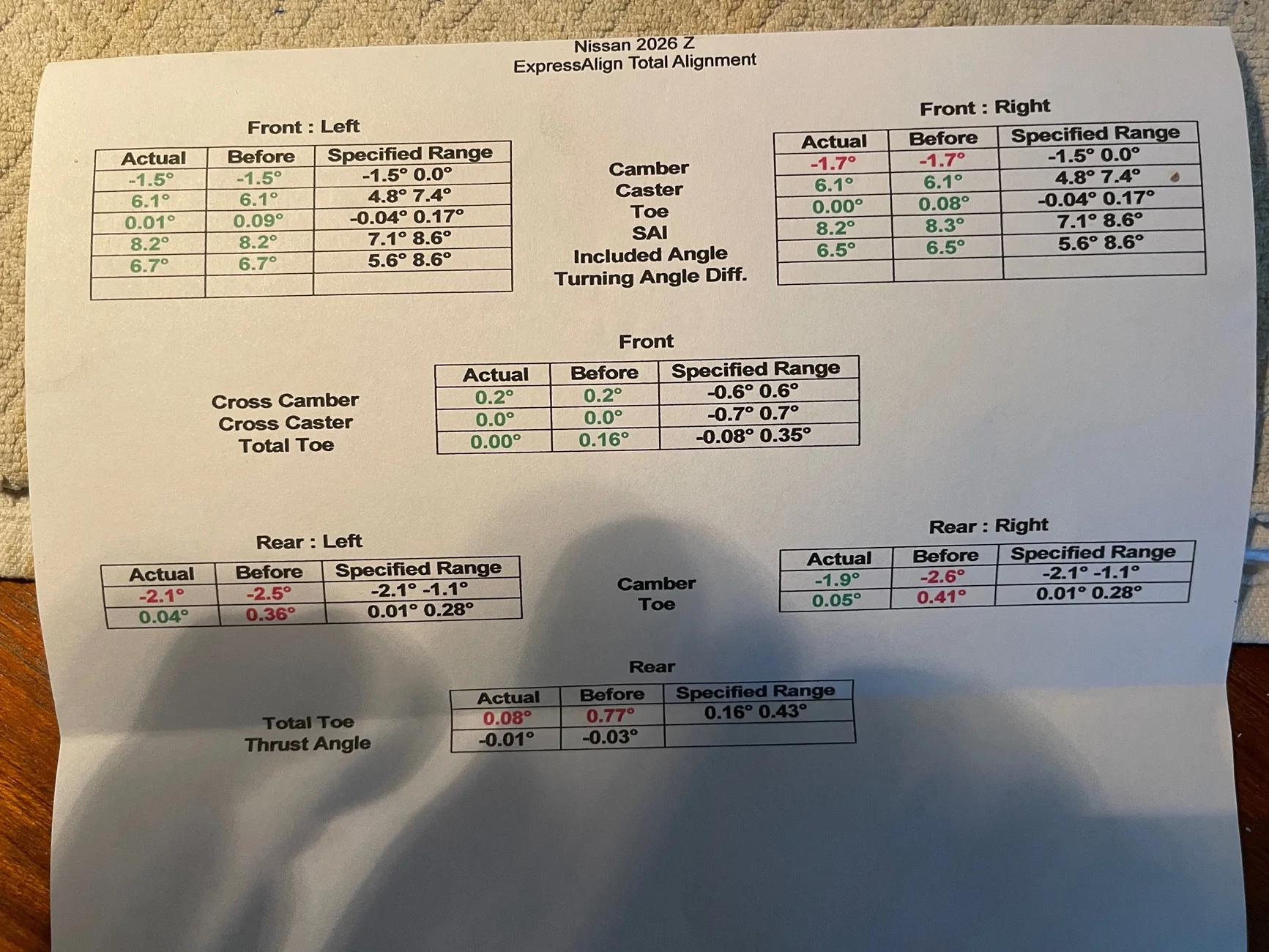

I am very pleased with the way the RSR springs made the car looked as well as the improved performance. Keep in mind I have 15mm/20mm spacers F/B.
Today I had an alignment done. The technician was the same person who did my Miata a while back. He was very engaging with me throughout the whole process. I had some specific alignment numbers in mind. He was very patient to make sure I was happy with the numbers.
Here are the final specs on my alignment.
