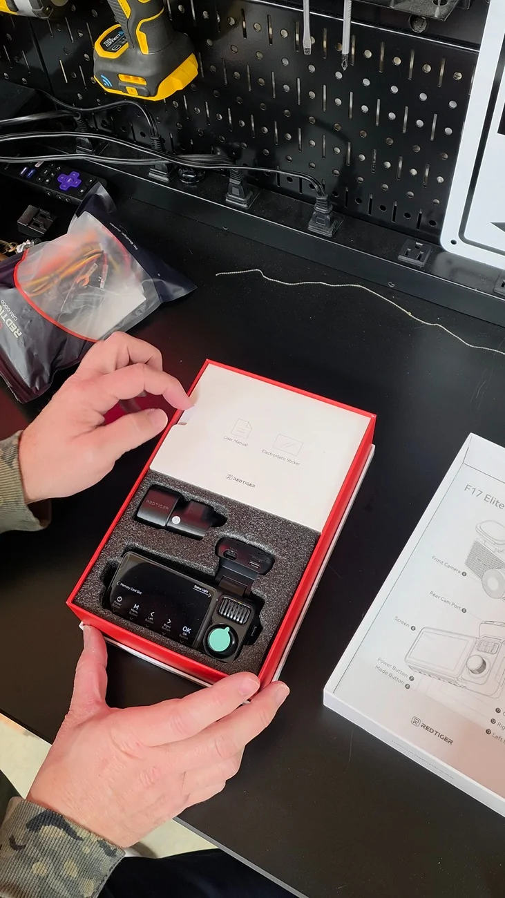

First things first the packaging is amazing. Everything was neatly tucked into its own foam compartment. The boxes all the accessories came in were labeled so you didnt have to go digging for anything. Instructions were extremely helpful and easy to understand. I also reached out to RedTiger to ask about a hardwire kit. I didnt want it plugged into the 12v port.

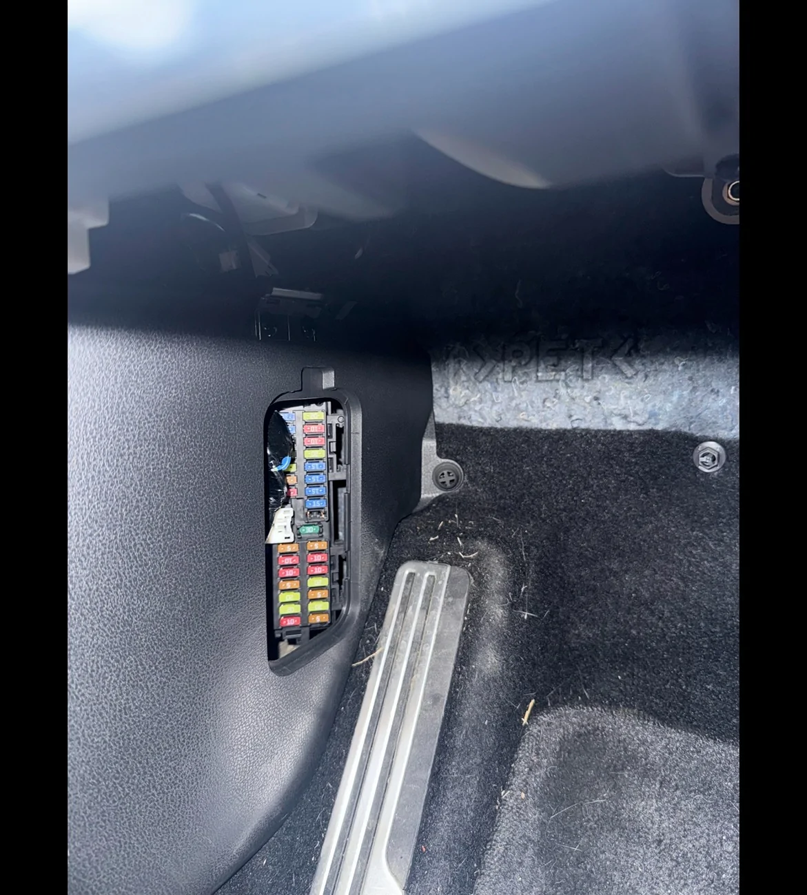

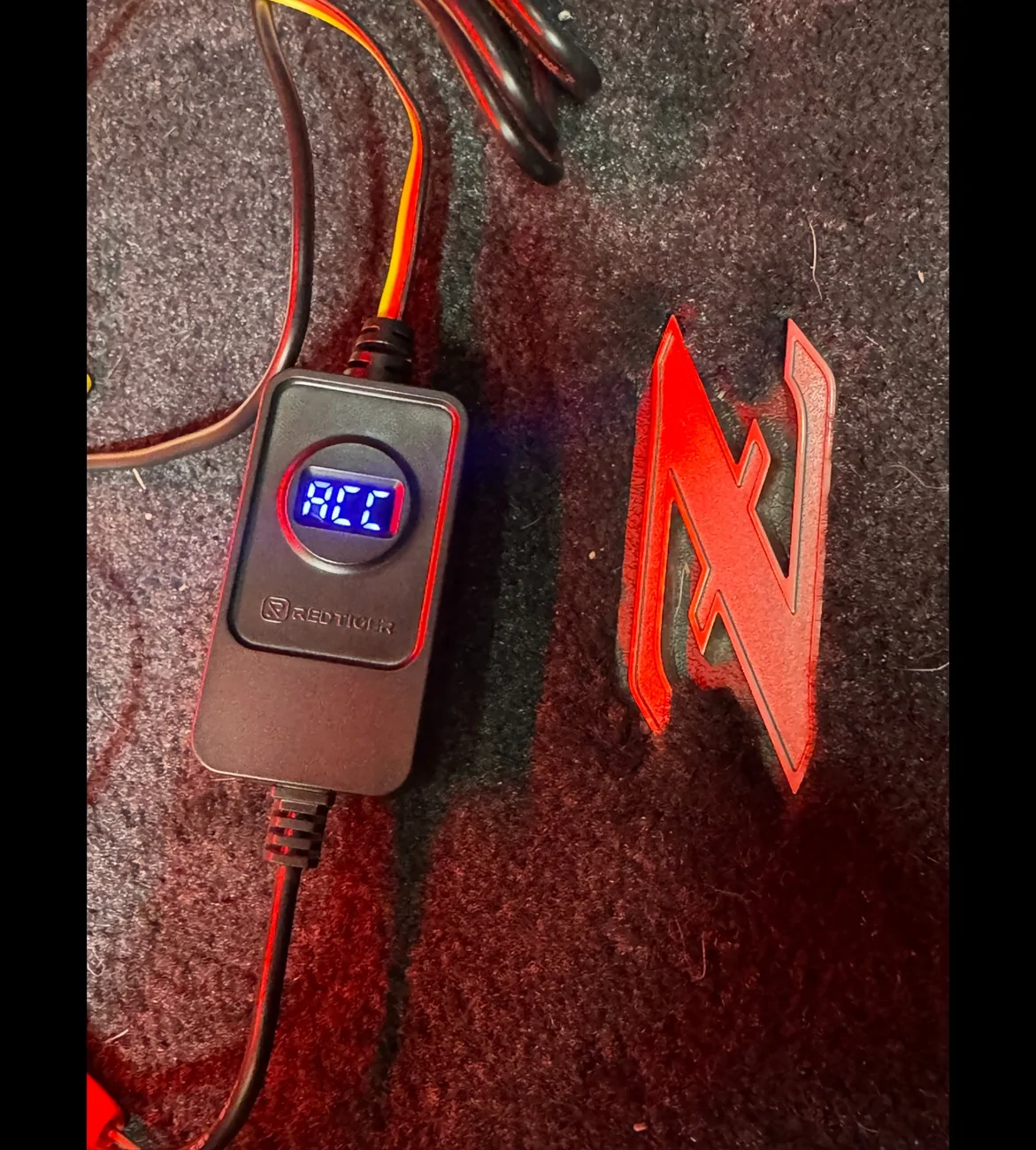

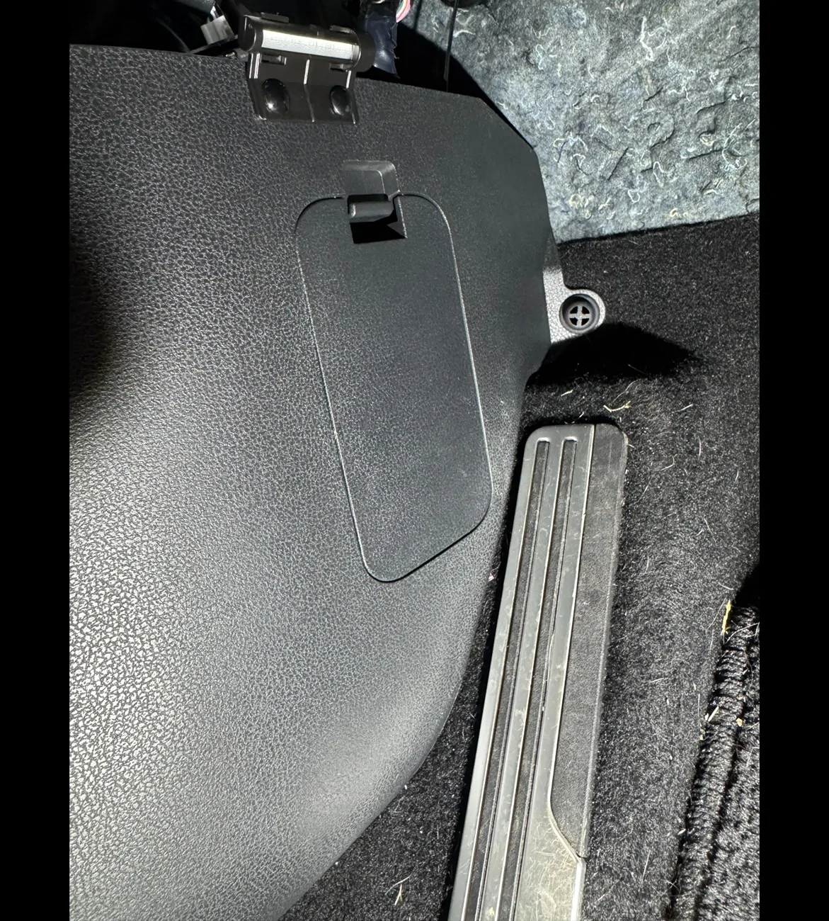

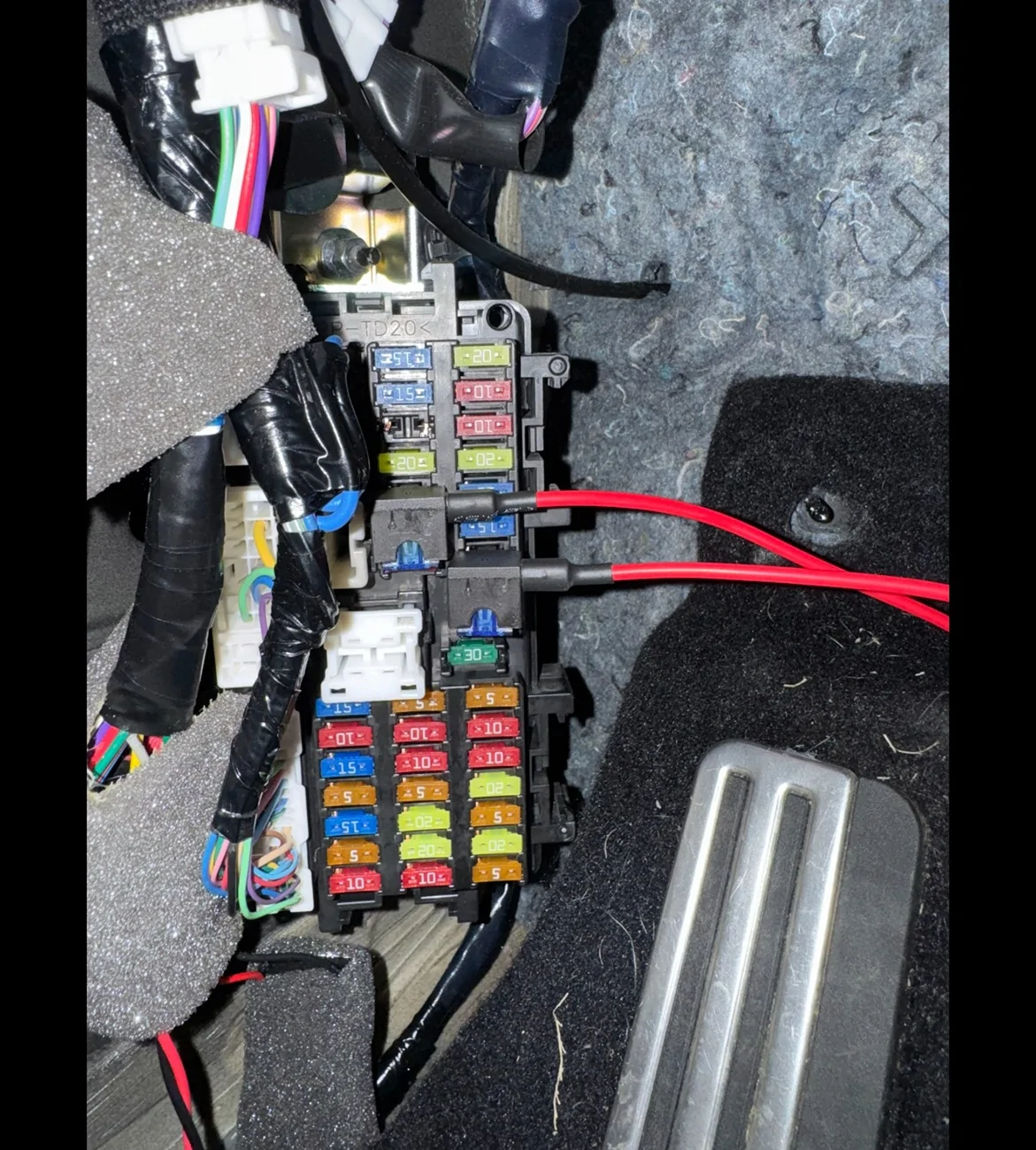

So to start off the install we located the fuse panel on the driver's side and removed the panel covering the fuse box. Using a multimeter we checked for a fuse that had constant power and used the fuse taps that came with the hard wire kit and tapped that location. Next we checked for the ACC fuse and used the fuse taps at that location.

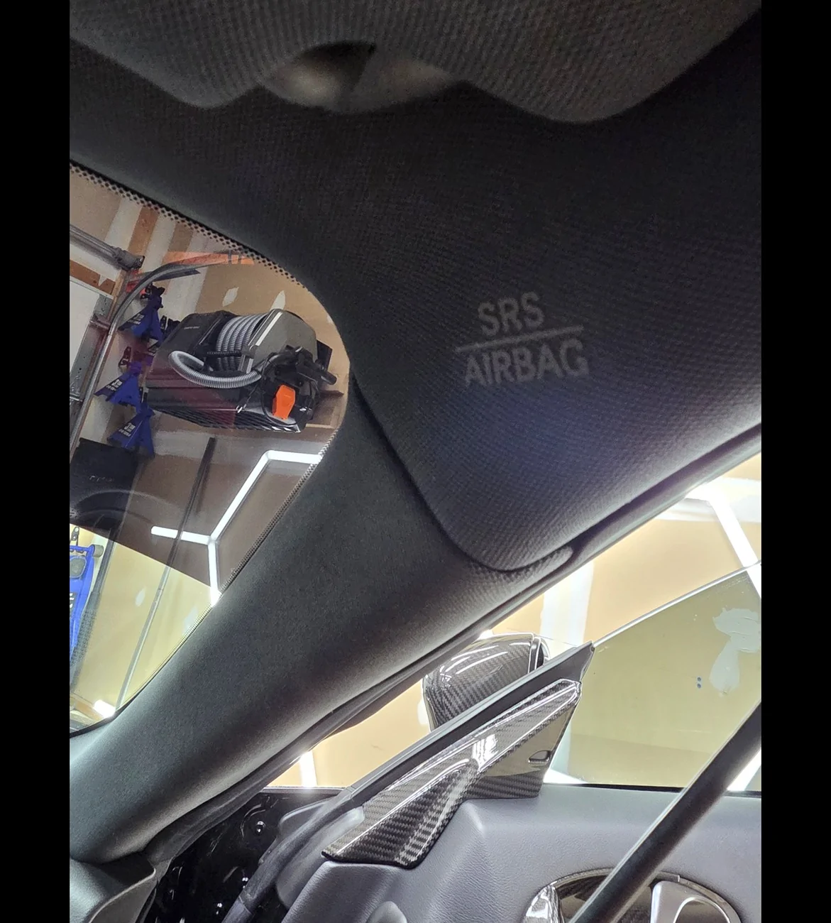

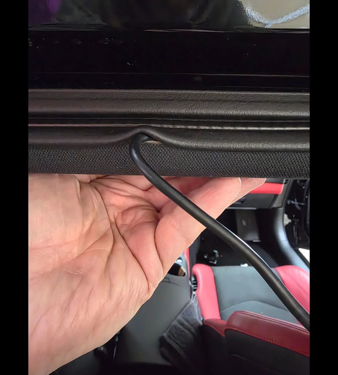

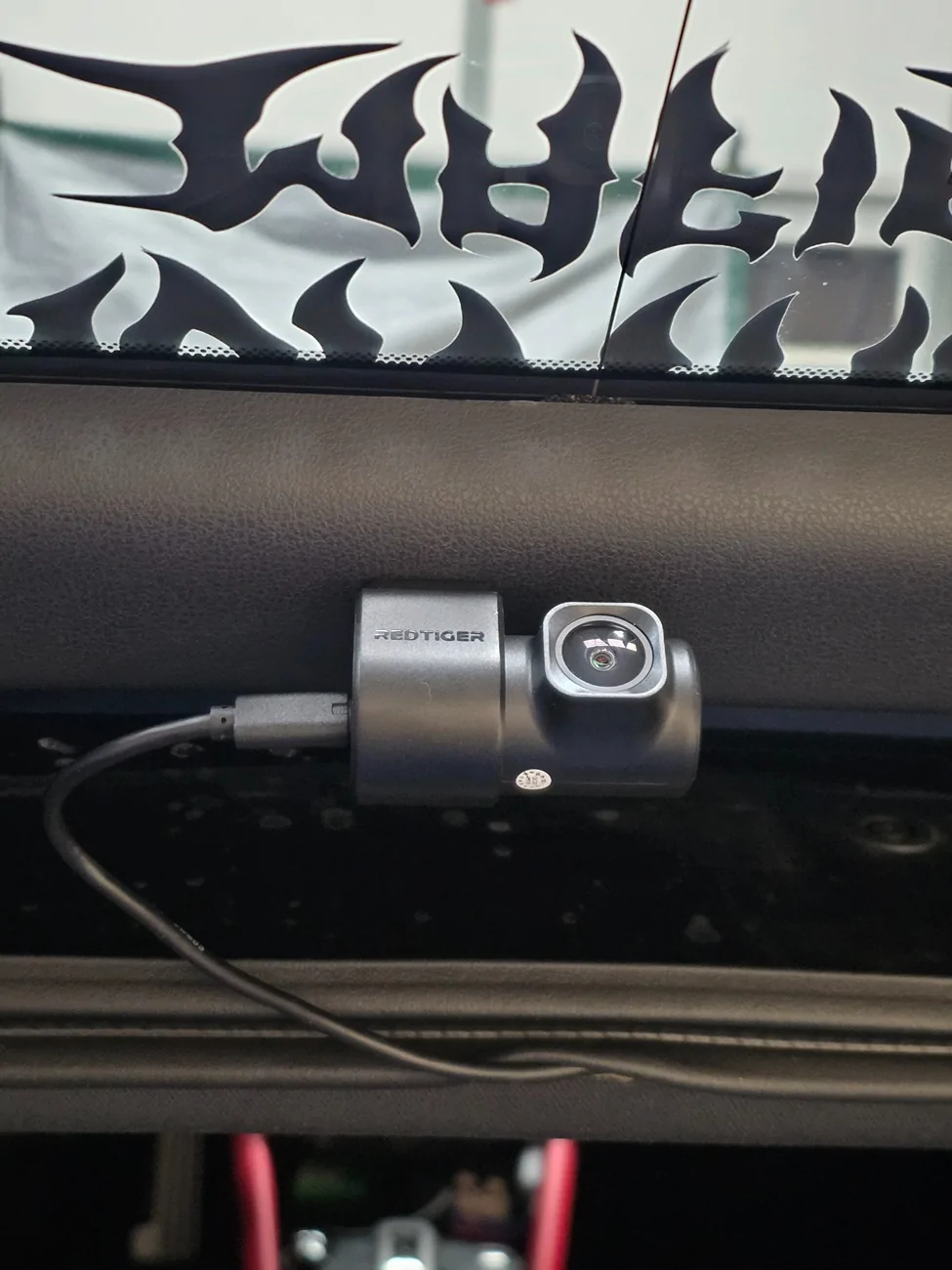

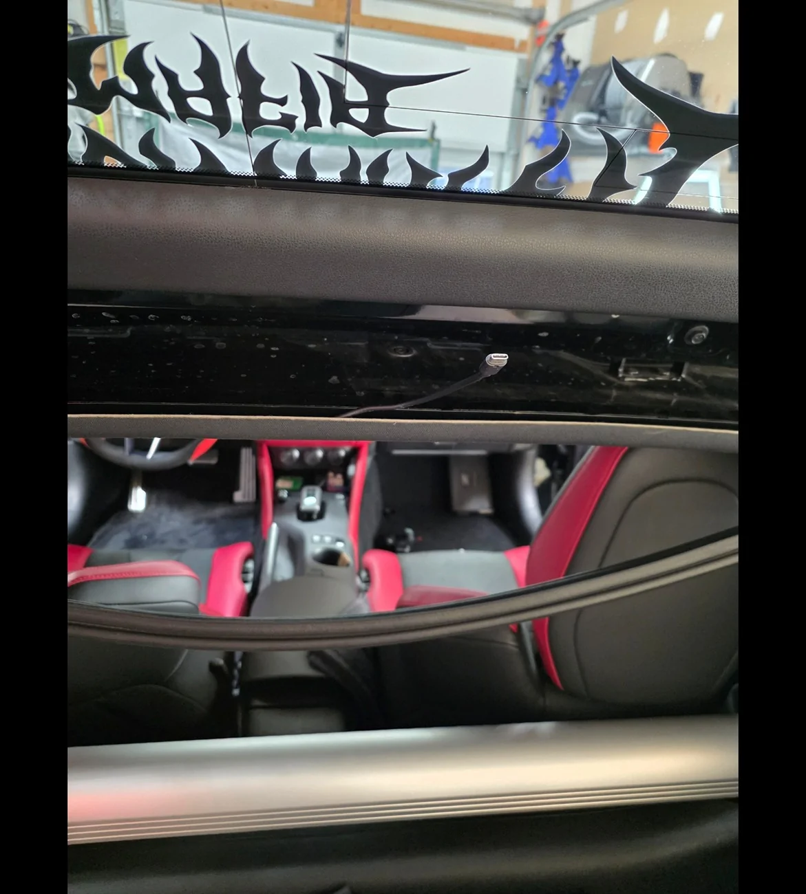

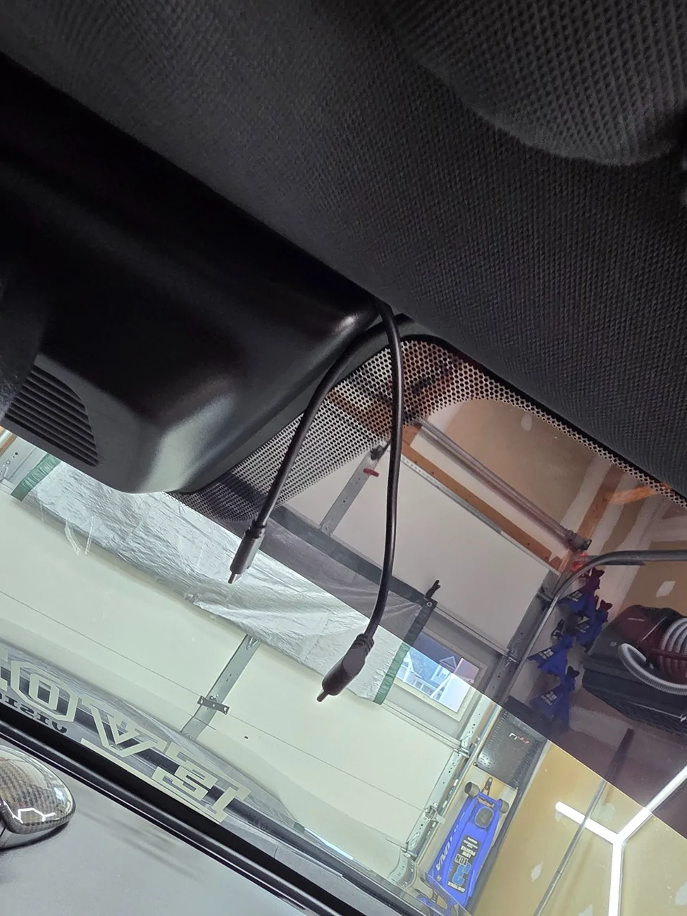

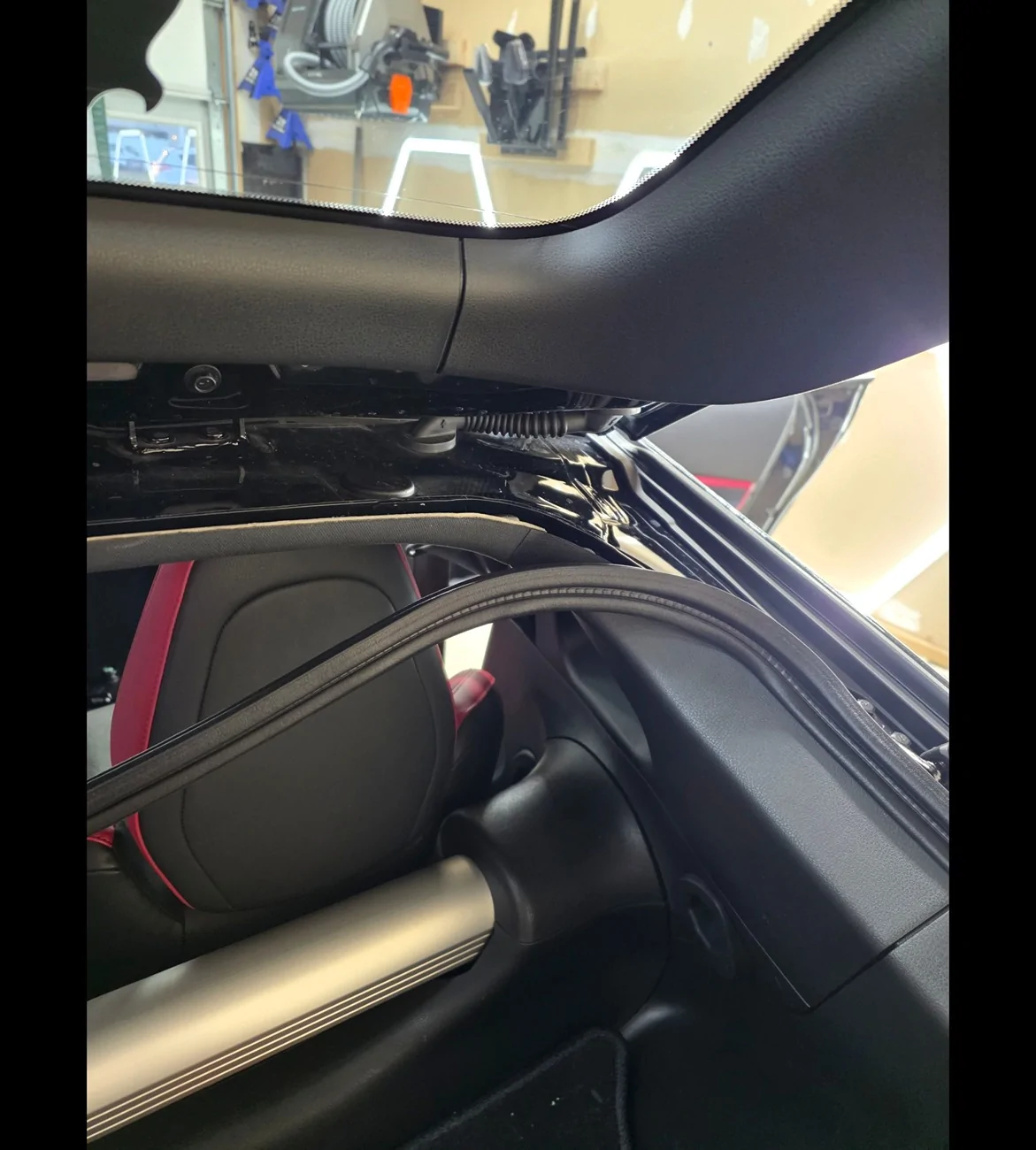

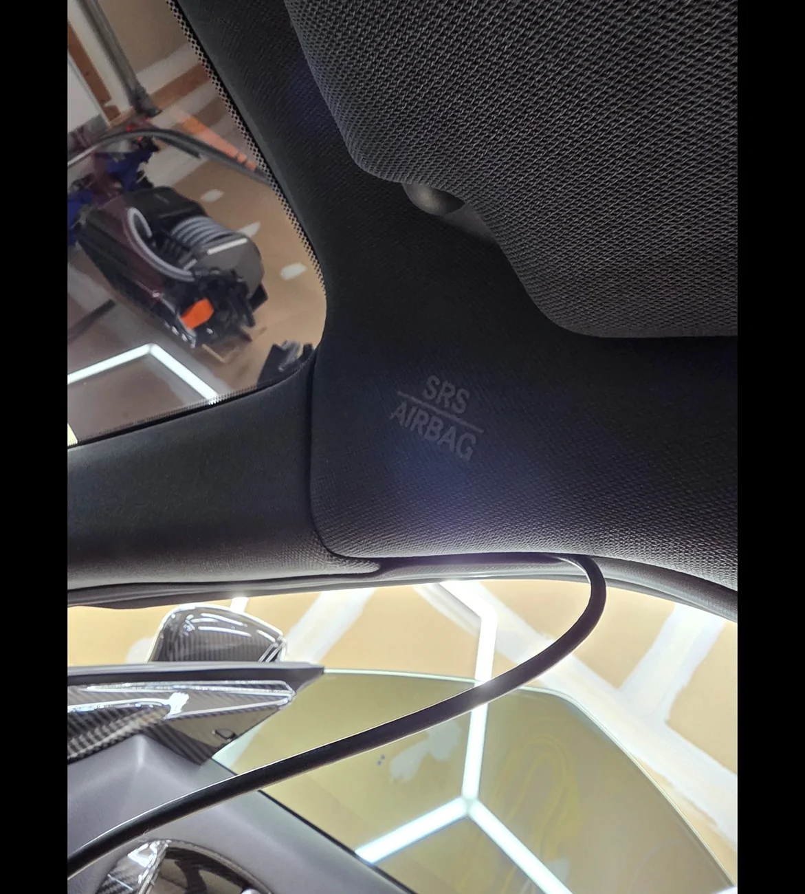

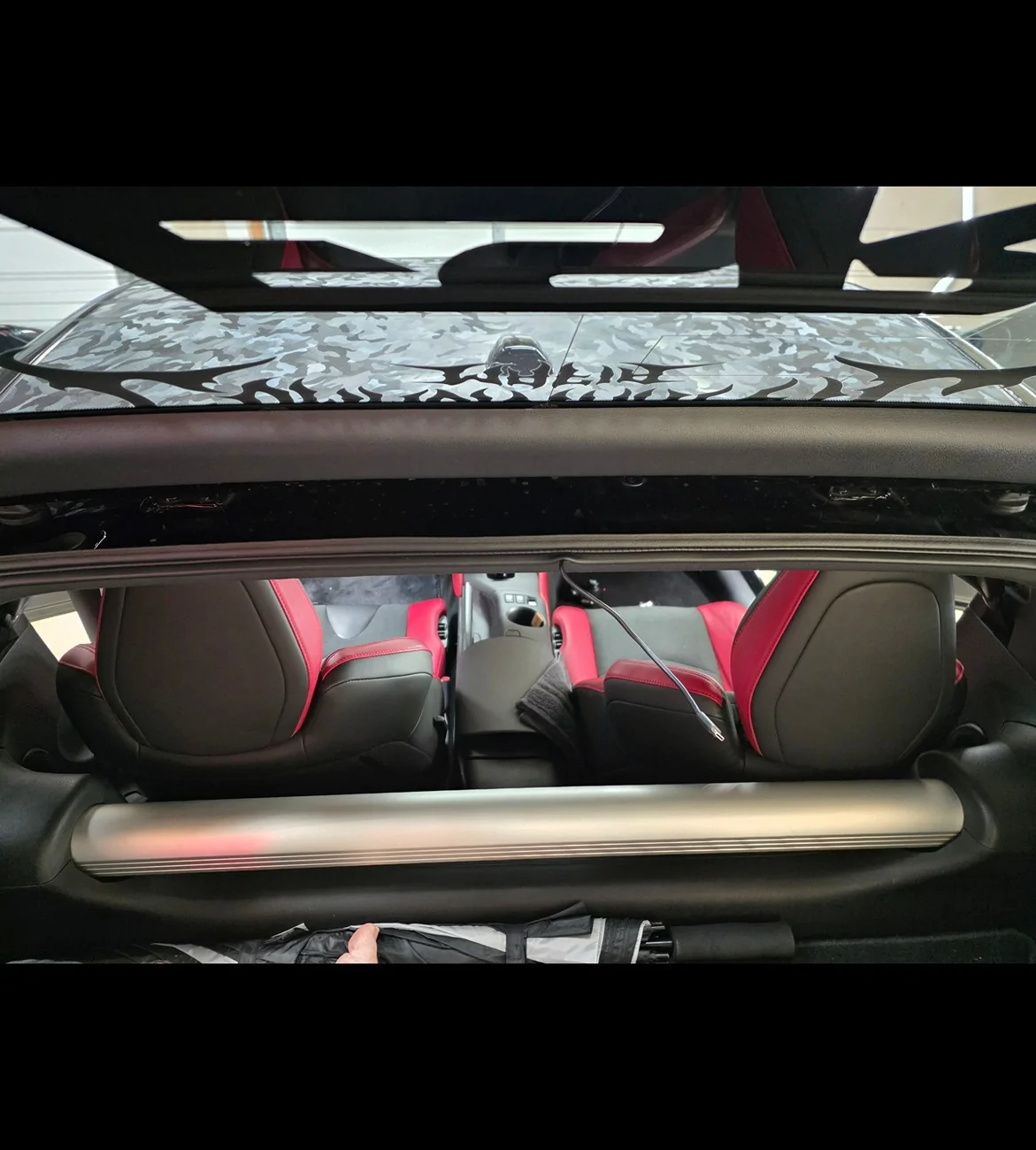

Once the camera was working we started the install process for hiding all the wires. We had to attack it from both sides of the car. The front camera power was run along the top of the windshield on the driver's side and the rear camera was run along the passenger side of the windshield. We neatly tucked it into the roof liner as we went across the top to either side. Once on the driverside we hit the pillar. My wife ran it down that pillar tucking it as she goes. Once to the dash she tucks it along side of the dash and thats it for her side. No wires to see at all. On the passenger side I have to take it to the back. So I ran mine along the roof tucking it behind the roof liner and working my way to the trunk. Now for the Z there is alot of extra cable Once you get to back. So tucking is a chore. But not impossible. I chose to zig zag it. What I mean by that is I ran the cable all the way to one end of the hatch and then all the way to the opposite side. Then brought the end back to the center of the hatch. That worked out perfect and I didnt have a weird bulge in the roof liner. Oh I forgot I had to pull the rubber seal up to be able to tuck it. Once it was all good I pealed the sticky off the the rear camera and set it in place.

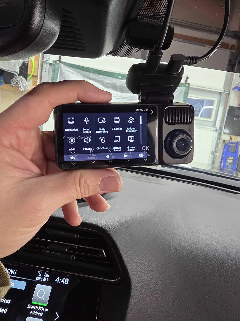

The front camera was just a simple find where you want it and set it. I placed mine out of sight while driving so its in just the right spot behind the rear view mirror. The interior camera still captures both me and the passenger. Once we set the camera in place the fun began.

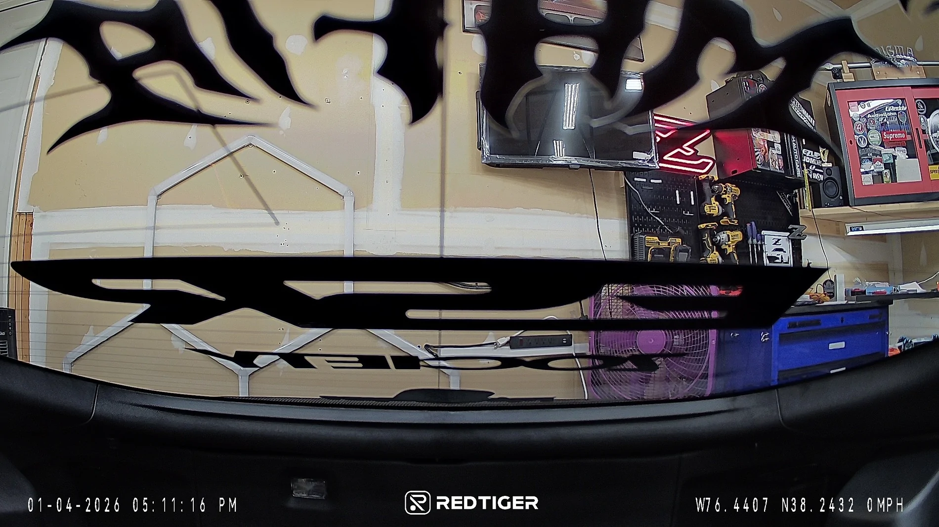

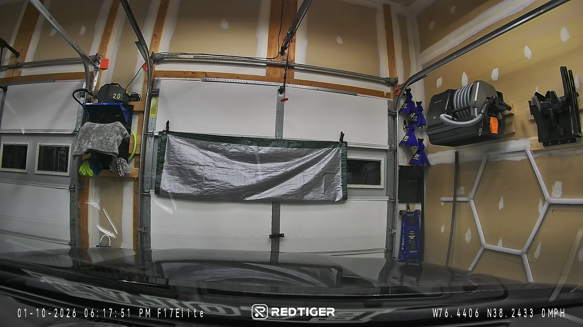

Set up was a breeze. I went thru all the menu options and set it the way I liked. Once all that was done I just couldn't believe how crisp the picture was. The cabin view was amazing to. The rear camera is also good I have to clean my window of all my decals now to get the most out of it. But the picture is still amazing.
This is the front view.
The rear view. Sorry gotta remove the decals.

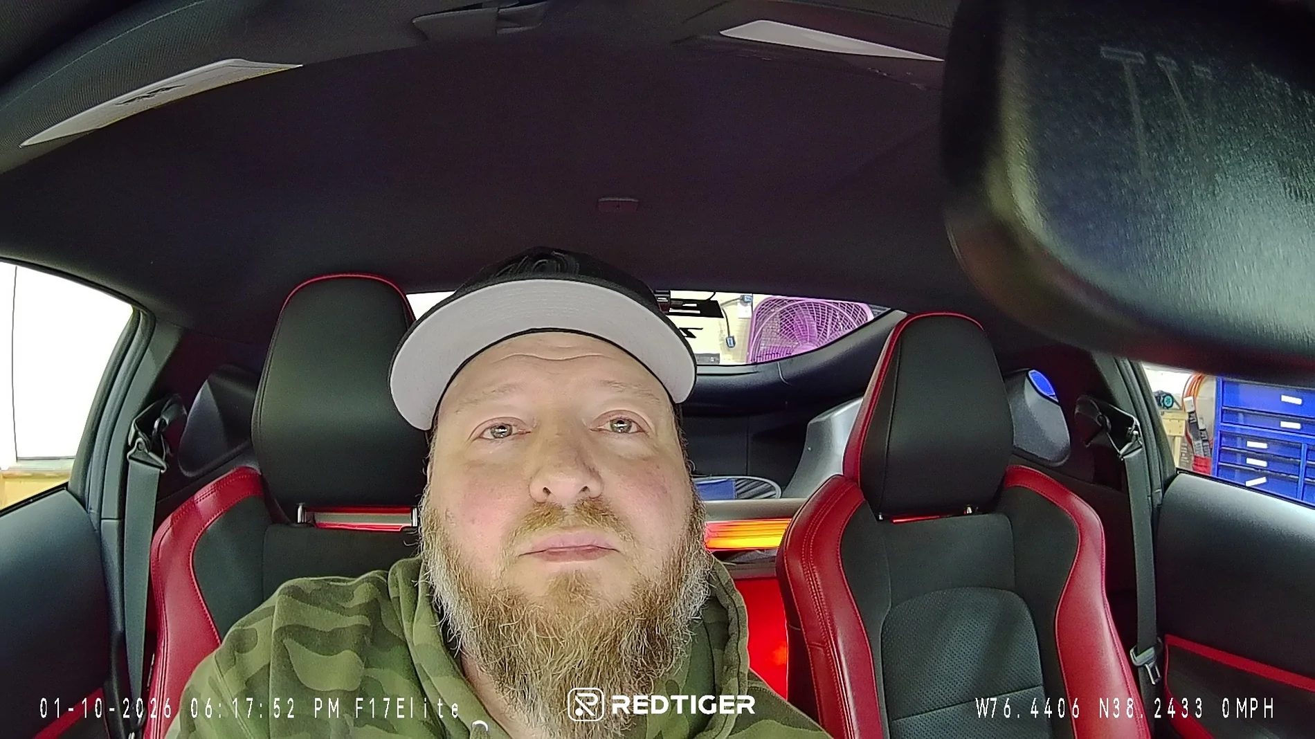

The cabin. Hey fam. Lol.
