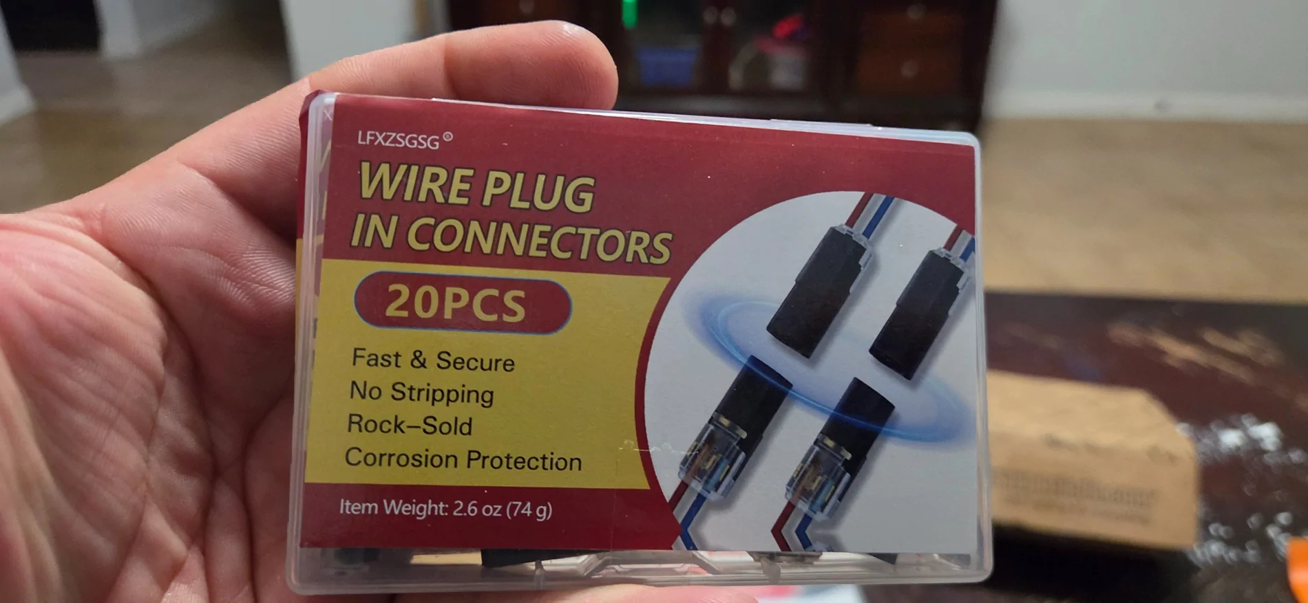

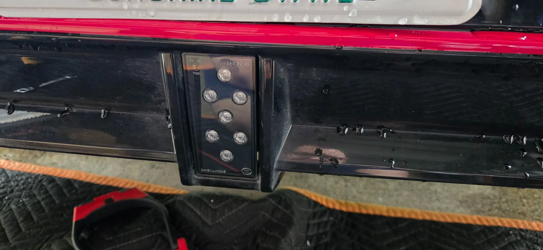

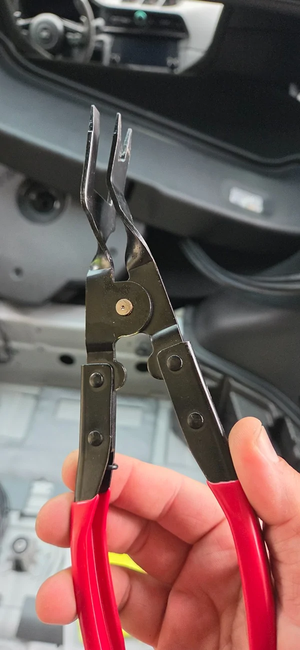

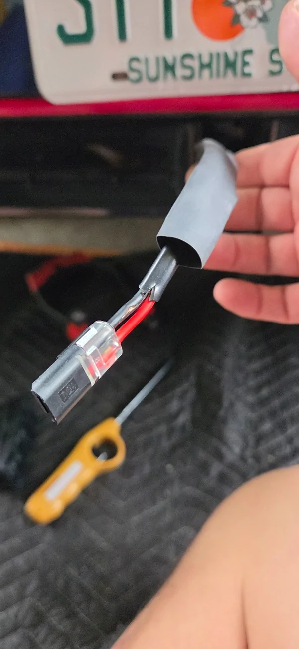

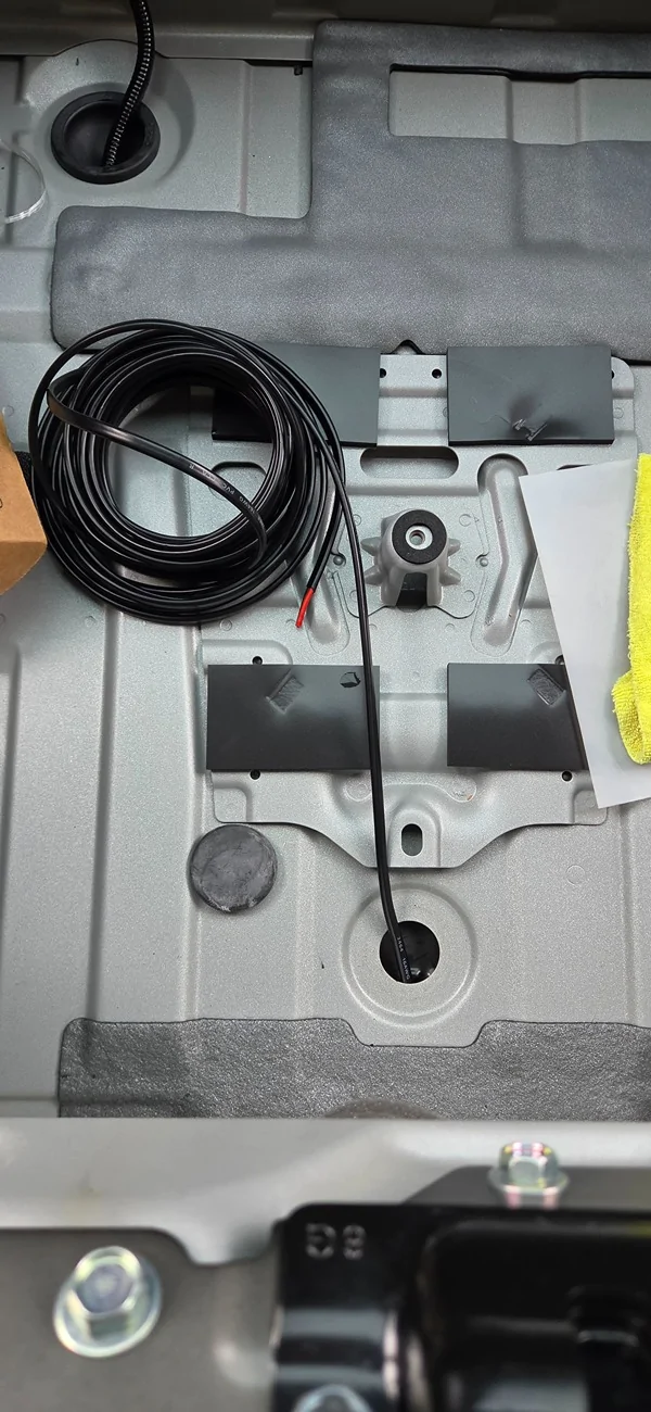

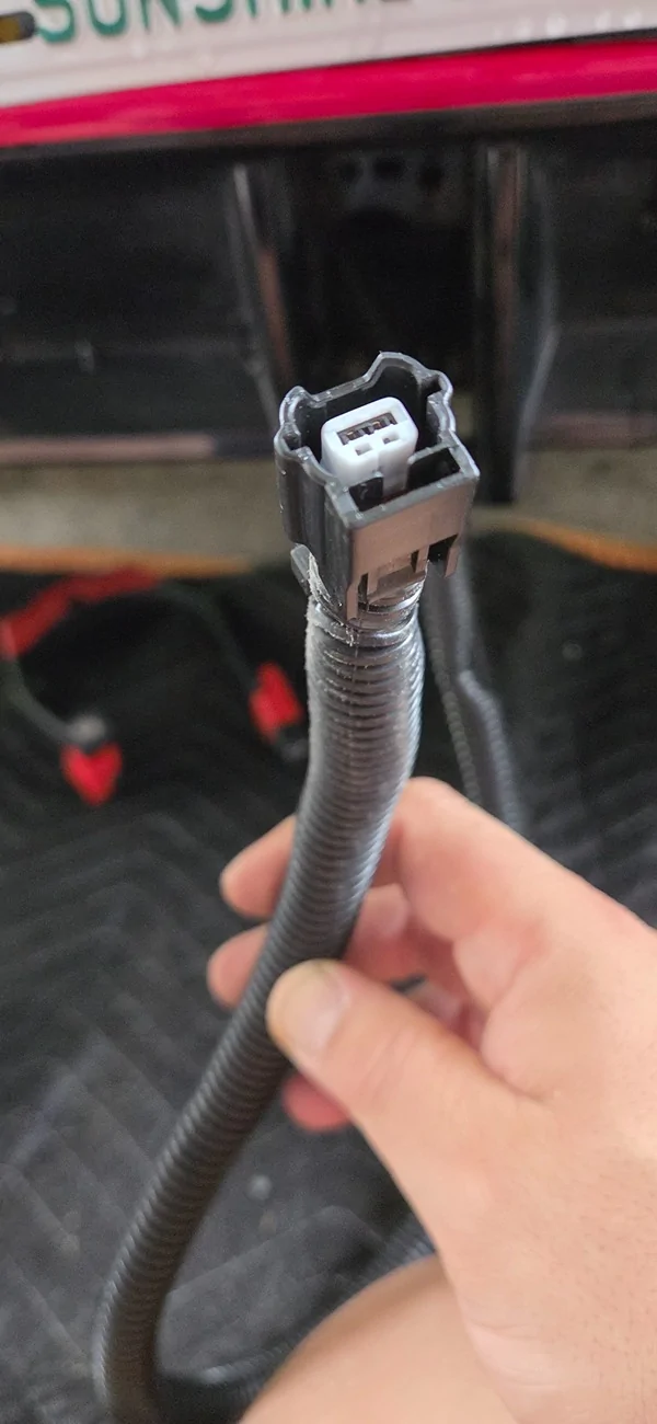

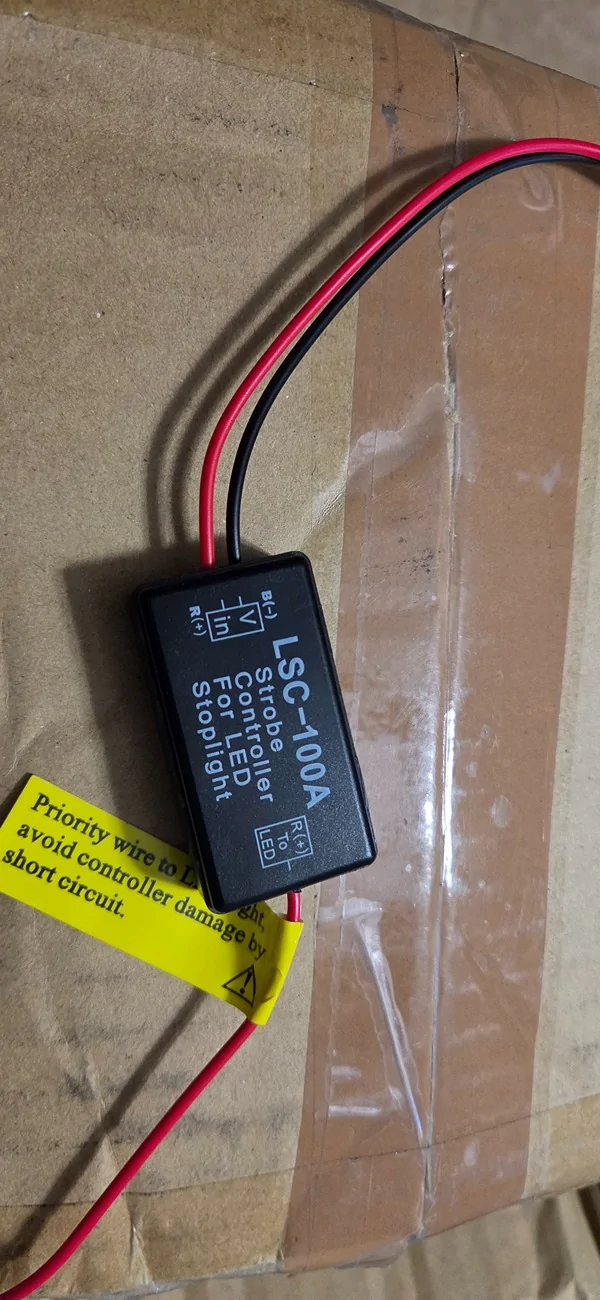

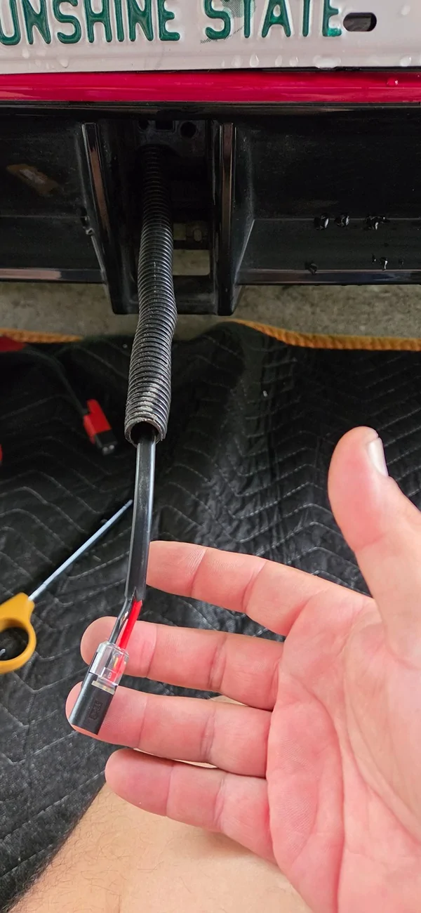

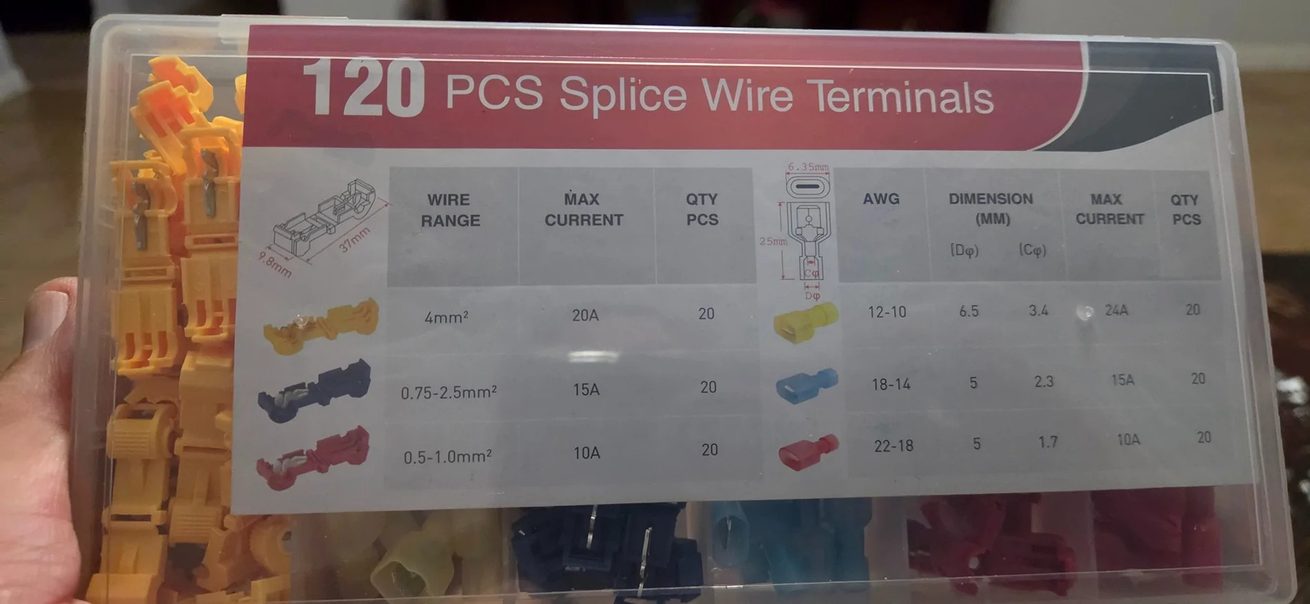

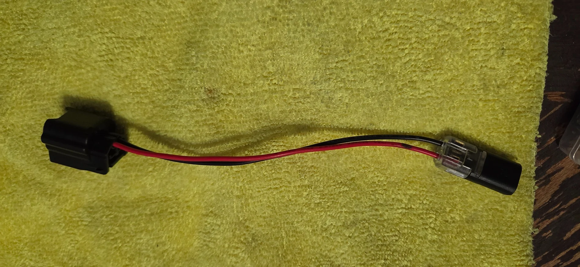

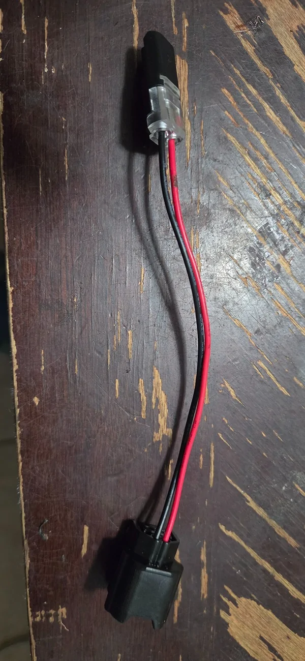

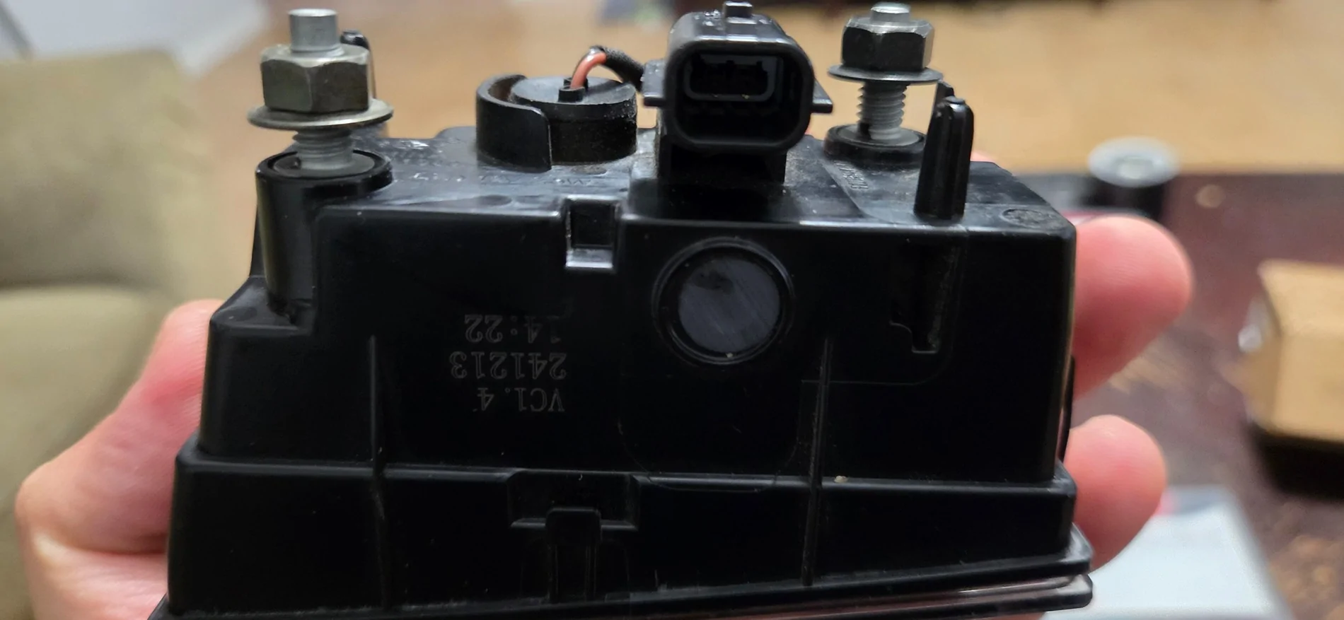

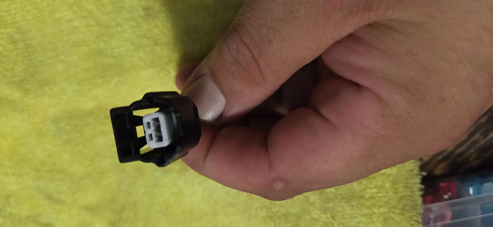

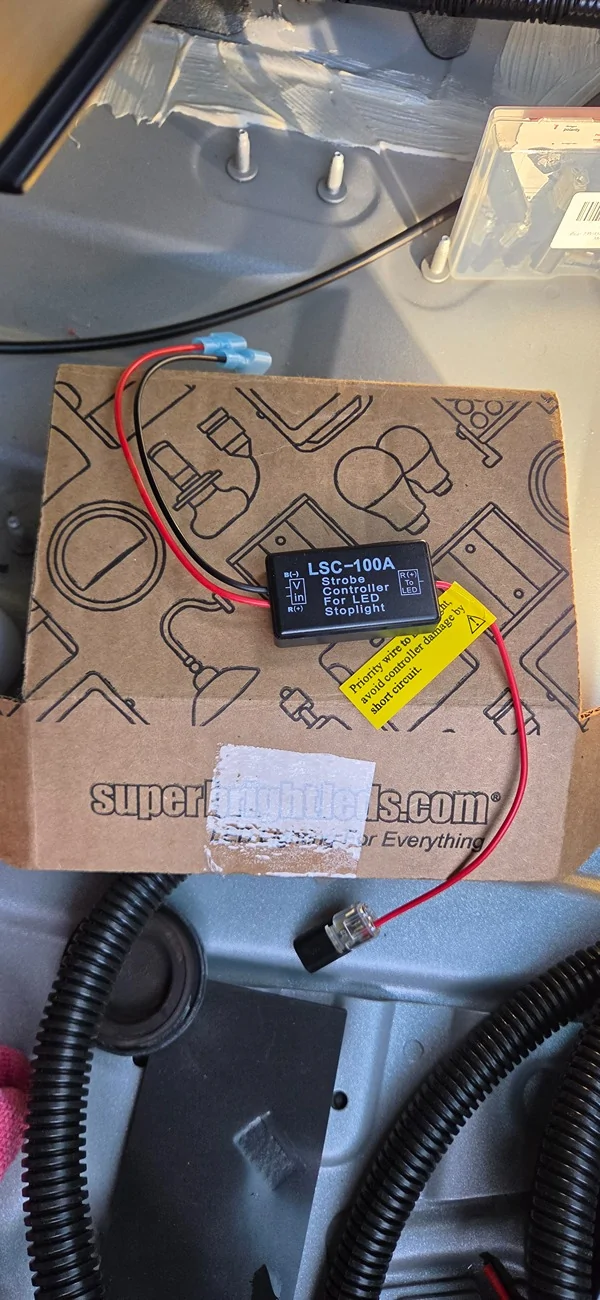

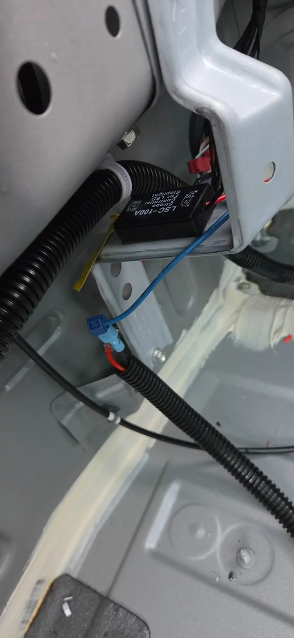

Took some work in gathering parts. Light from buyee.jp, cheapest around 200 and connect from Amazon same as the ac connector. T fitting and connectors for the wires all from Amazon. Tap into the white with green wire on driver side and run down the center grommet and TAKE YOUR TIME. any questions hit me up. Shot out to 5280fairladyz for good pointers. I added the strobe module for an extra F1 touch.
