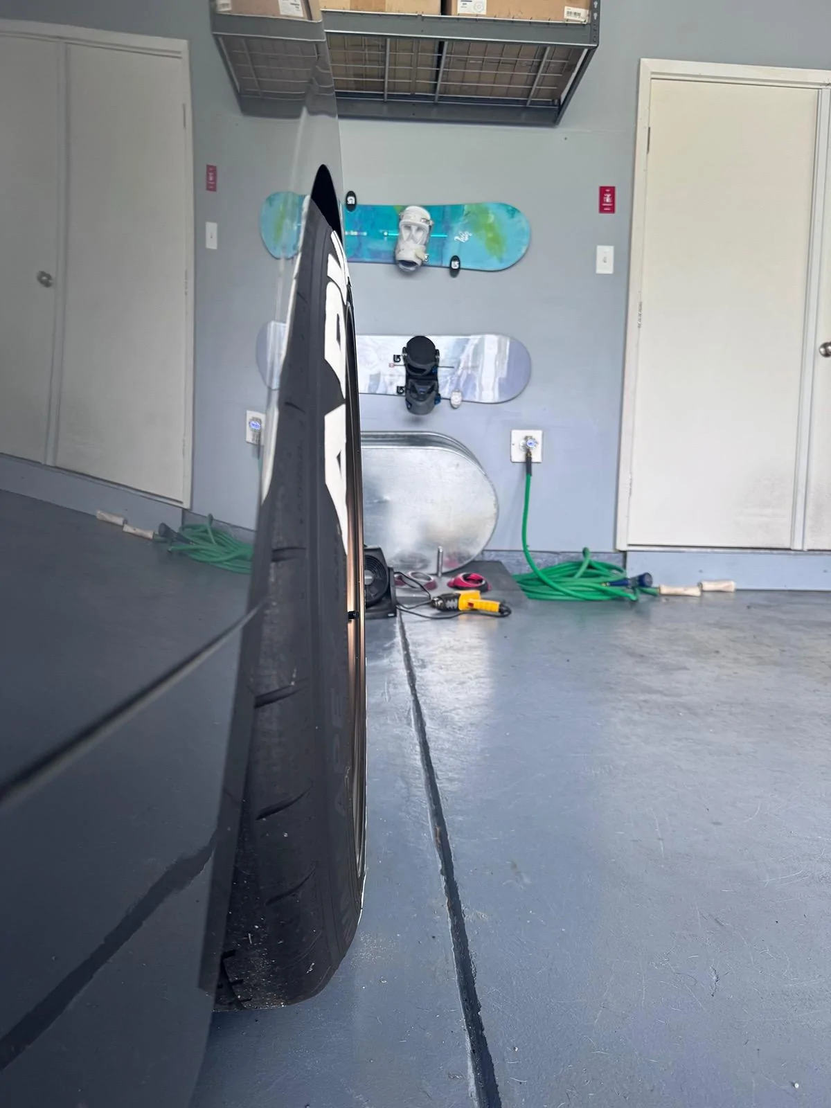

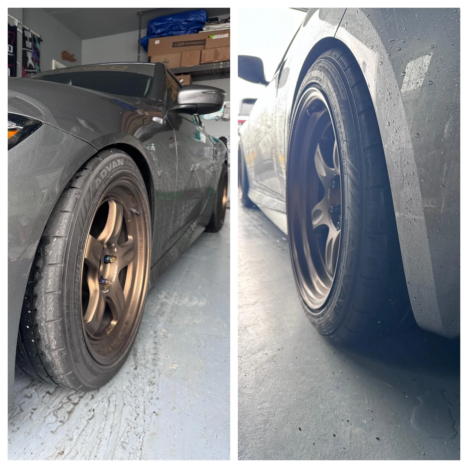

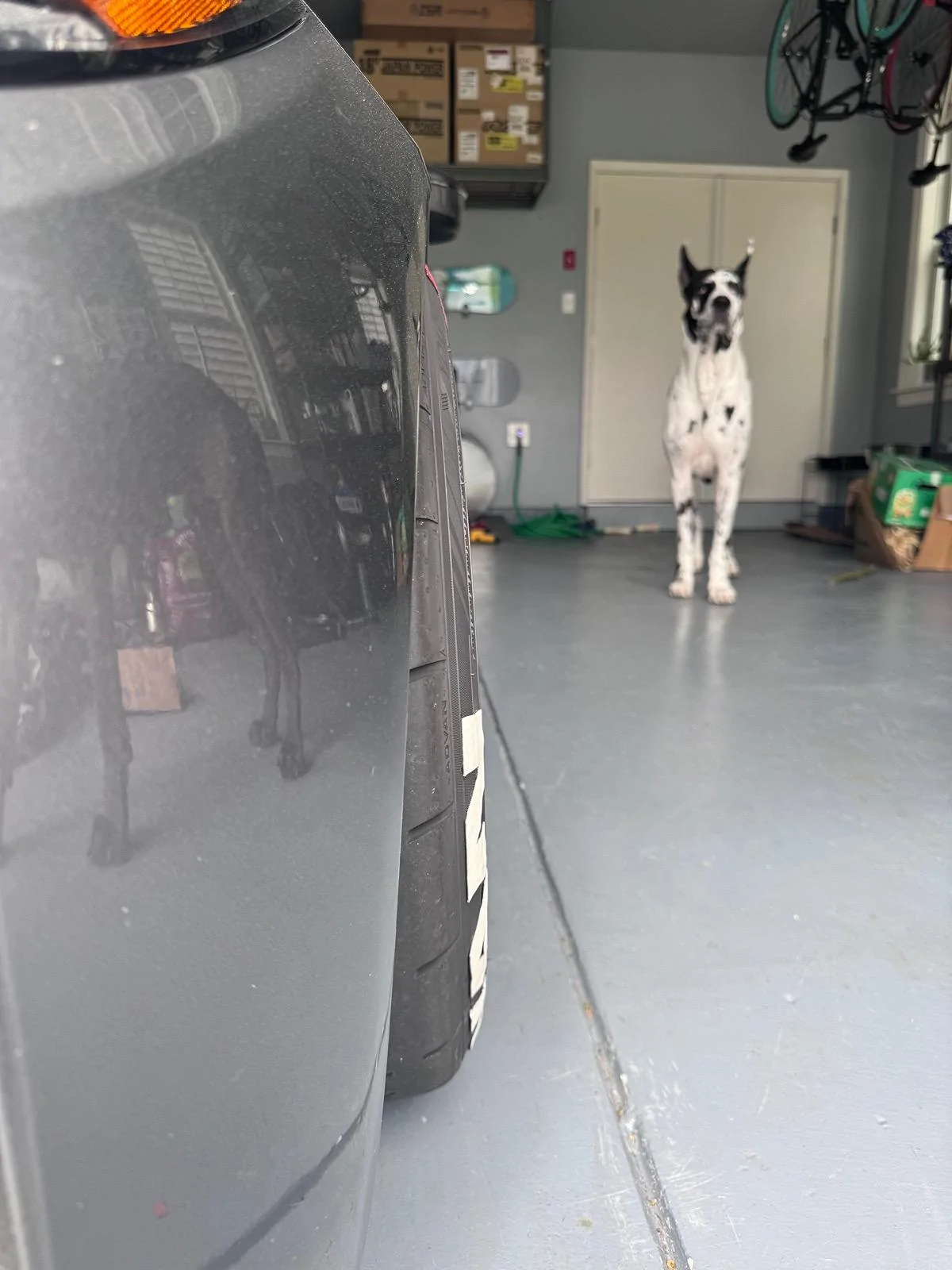

Probably seen my post(s) regarding spacer sizing and which to go with. I decided on 20mm with extended studs with my wheel / tire specs. In case you have something close, this is what you’ll end up with:
Wheels: 18x10.5 +15 Rear
18x9.5 +20 Front
Tires: 275/40 Rear
255/40 Front

Looks nice and flush! Good move on the extended studs 👍 Would it rub on full compression? Stiffer springs? OEM fender lips already folded? I'm looking for a square 18" setup for tracking.

Not sure yet because it was rainy all day yesterday and I couldn’t do any hard cornering. My guess is that it will a little but yes….im on stiffer springs (coilovers), no oem lip in the rear but I left the fronts alone for now.

looks great
how much did you drop it?
is it rubbing?
Thanks! There’s a little more than a finger gap in the front which rubs a little (depending on the bump I hit) and no finger gap in the rear which doesn’t rub. Camber is -2.6 front and rear

I think my tire lettering helps JUST enough to see some of the tire poke
