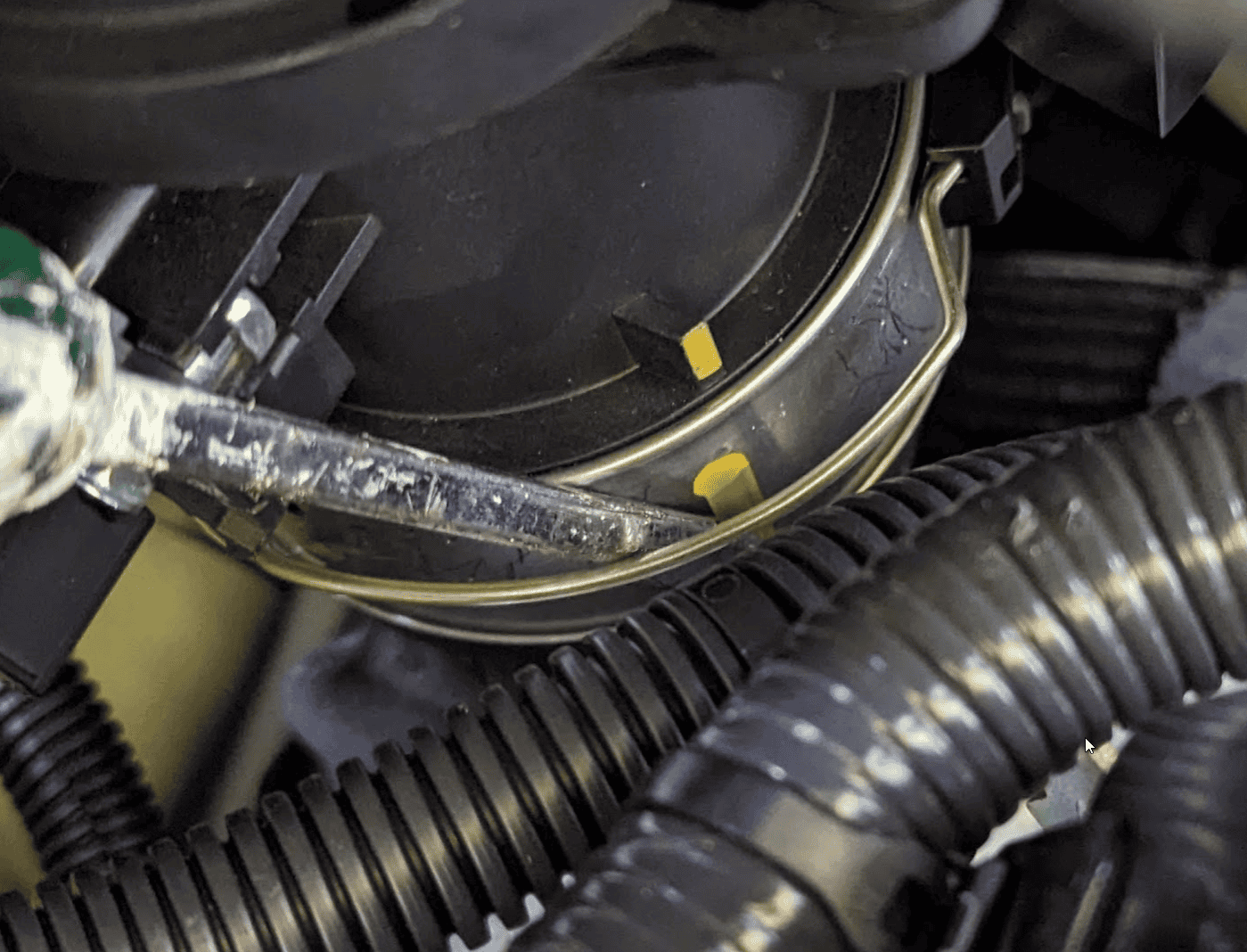

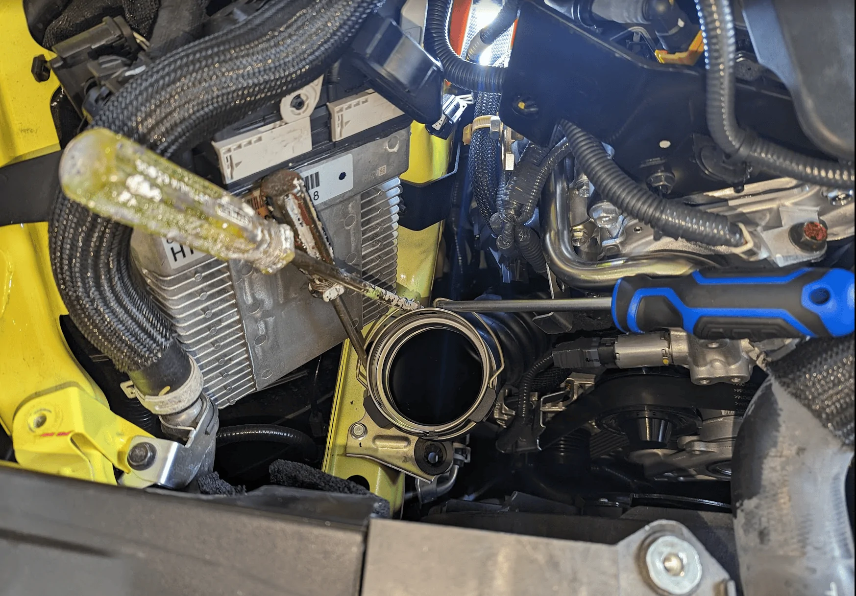

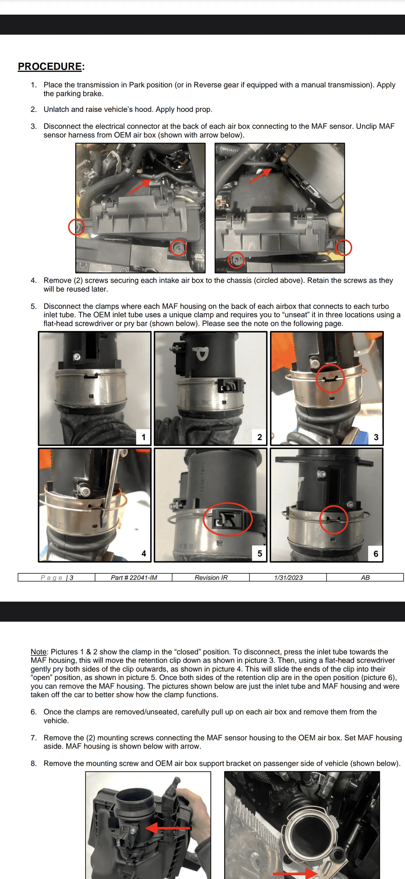

Thanks for that!
I did actually have it already (sorry, shoud have said, but thank you for taking the time to post it up!)
The issue was I couldn't get the clip in image 1 to move down to it's position in image 3.
I could easily pop the side out (2 to 5) but they wouldn't stay out, and the front clip at 1 was not disengaging.
Worked it out though - need to get the screwdriver in like they say, but it needs to be inserted in a downward motion right next to the front clip in image 1.
I have changed out one side now, and will try to get some better pics to help anyone else struggling with the swap.
Thank you again!

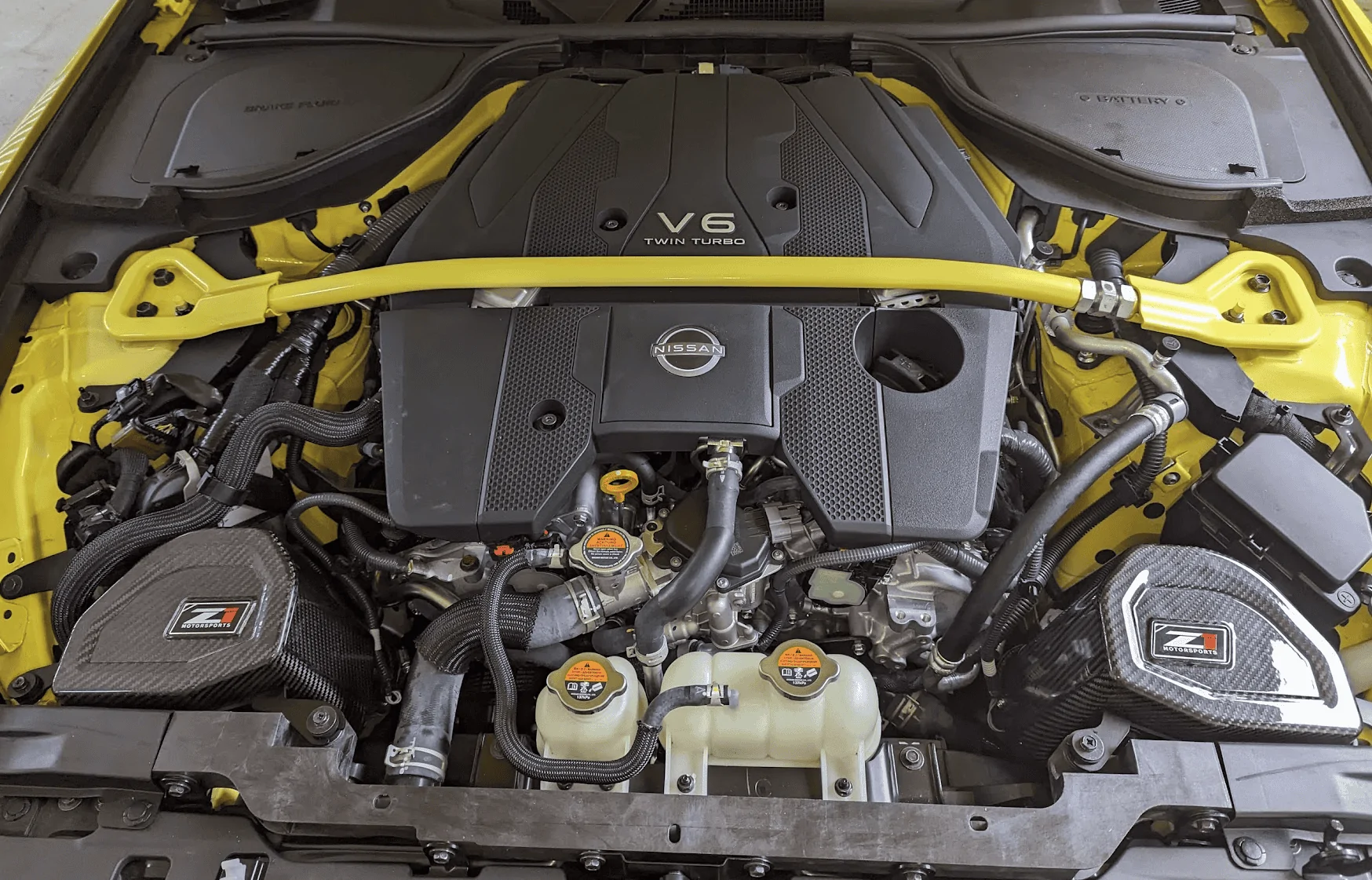

Finally got them installed. Even after knowing/seeing exactly how the Intake Tube to MAF sensor retaining clip works it was an absolute nightmare to get off.
Cannot hear any difference in intake noise from inside the cabin, and don't have any friends, so can't test external revs! 🤣
Will dyno in coming days.
