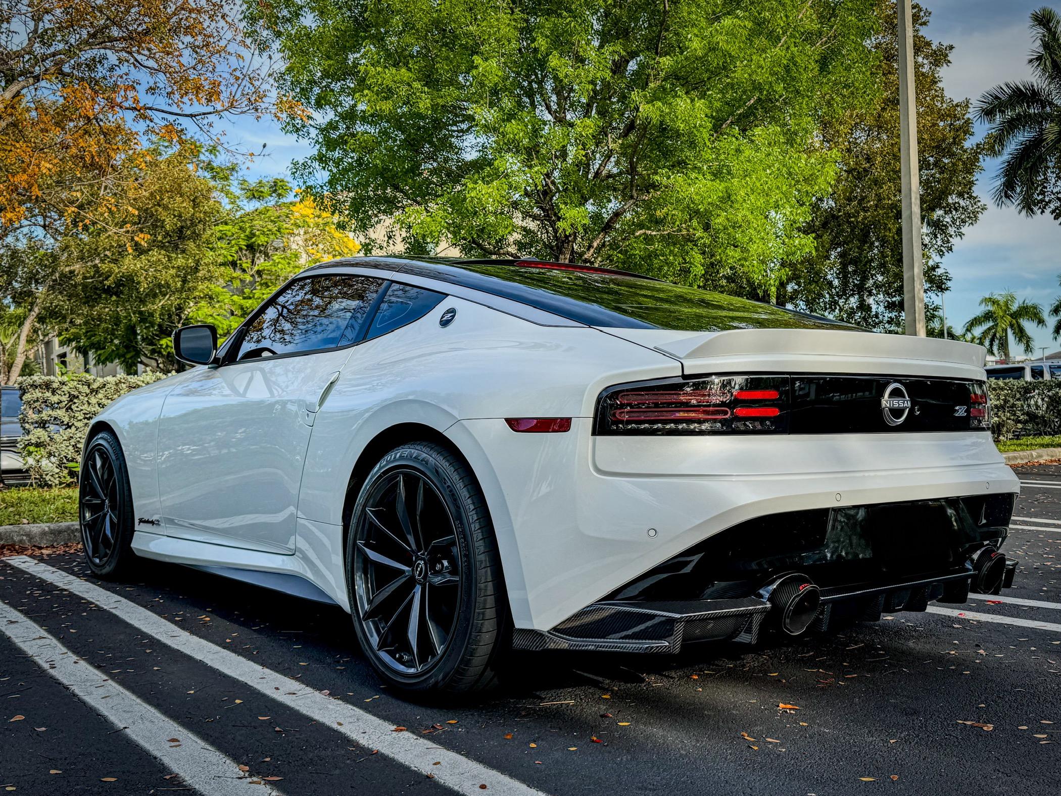

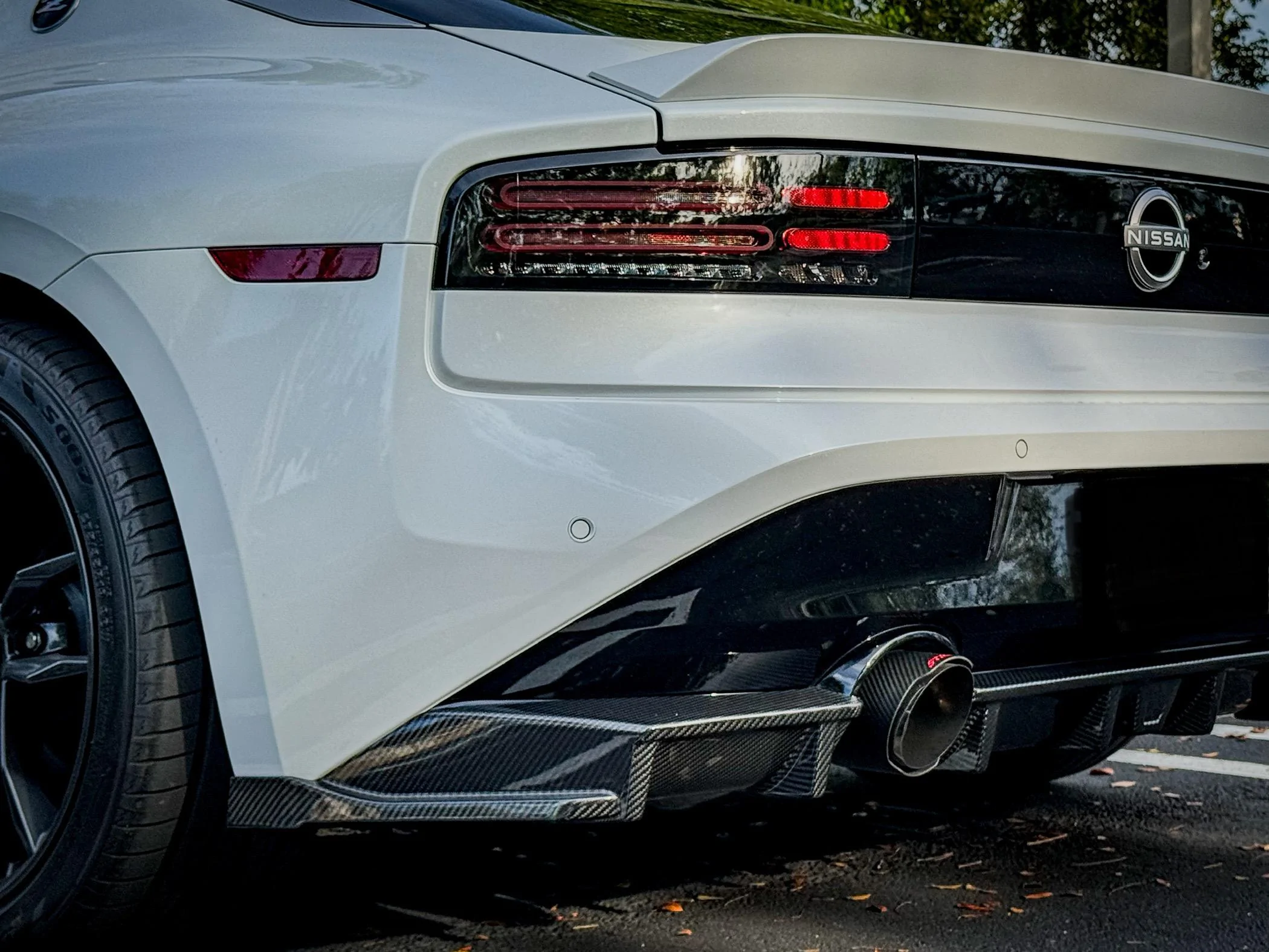

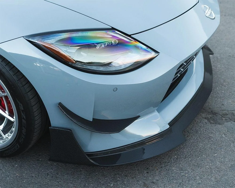

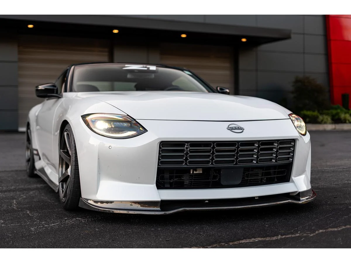

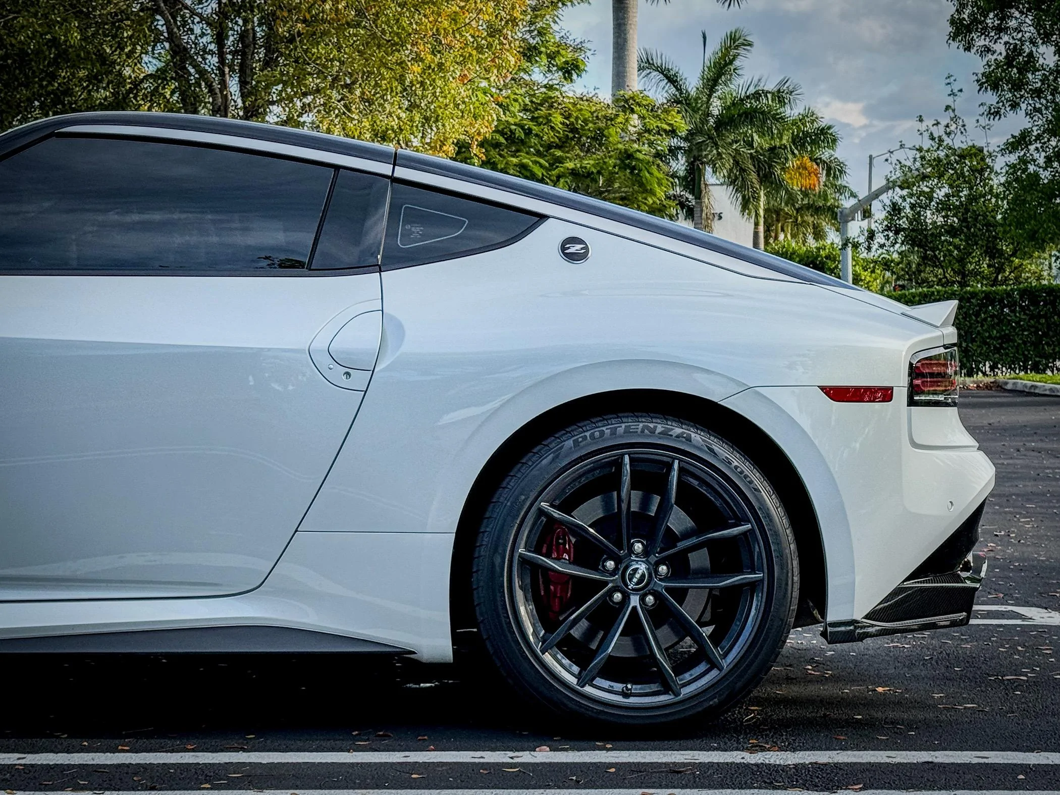

Started my aero kit journey! Might be mix and matching the Vivid front lip and side skirts with this Z1 diffuser. I really like how aggressive they look.

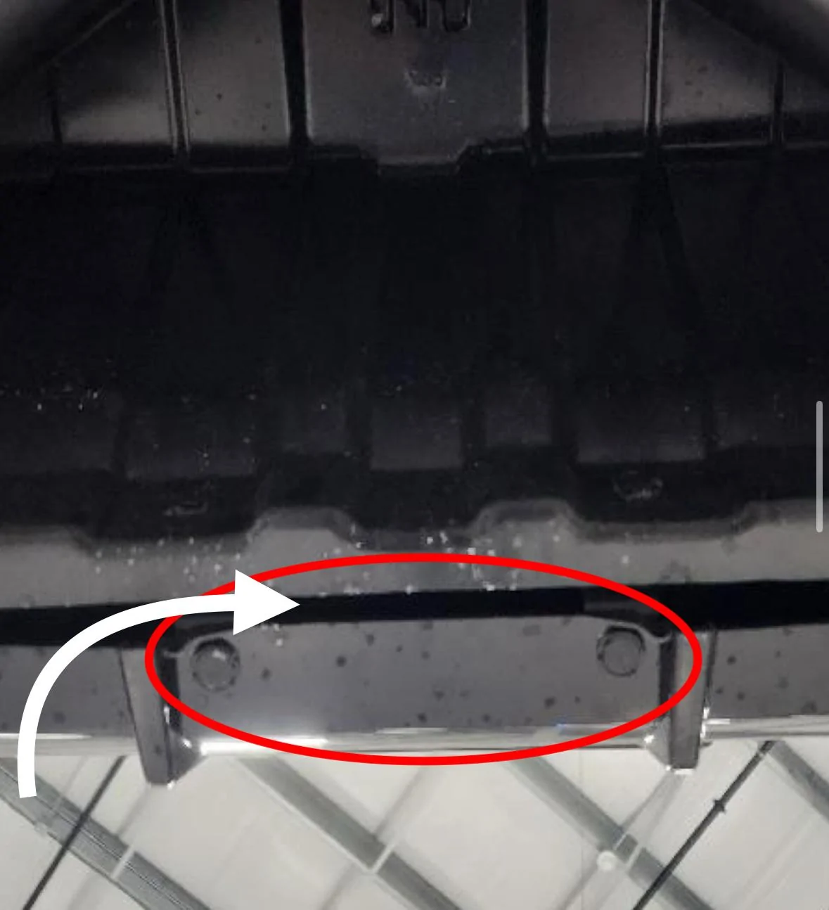

Initial thoughts. Good quality perfect fit. The only thing I recommend is that before installing you remove the Floor Pan Heat Shield above the mufflers to be able to pop the OEM push pins from the top. The gap is too small to pop in without removing it.
Cheers, let me know what you guys think.

Bad ass. Looks great with the stillen CF tips
