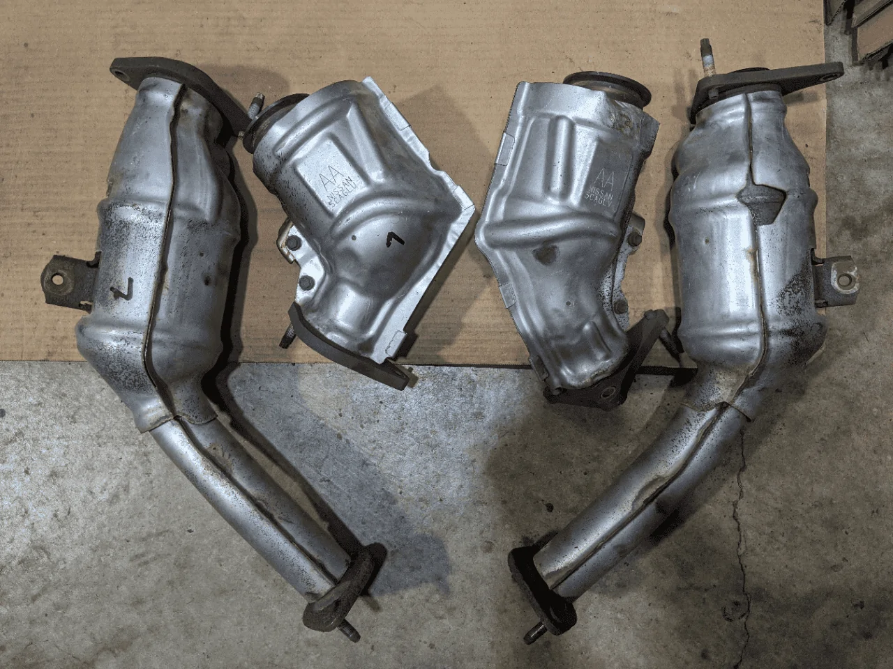

In the VR, the downpipes are split into an upper and lower. Each has it's own catalytic converter. So I guess the total of cats on the car would be 4. The O2 sensors I believe located after the first upper cat right off the turbos
You can buy just the lower downpipes, leaving the OEM uppers in place on the turbos and use the OEM O2 sensor in the new lower downpipe. Or you can replace the entire unit with one complete downpipe right off the turbo, with or without an aftermarket cat. Technically, you are eliminating two of the 4 cats by ditching the lower downpipes, however the lowers are after the O2.
