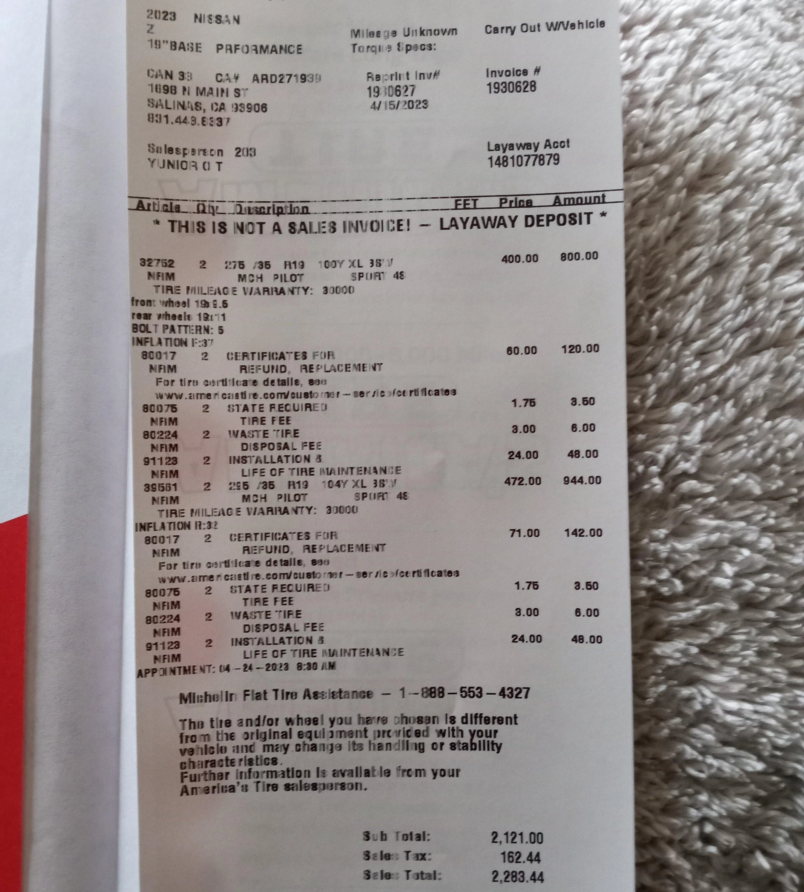

So I recently bought a set of Michelin Pilot Sport 4 S. 275/35/R19 100y front and 295/35/R19 104y in the rear.
My question is does it matter that they're R? And not ZR? I thought any tires with a speed rating over 150mpg would have to be labeled ZR. (100Y has a speed rating of 186mph) So I'm confused.
When I ordered these direct from Michelin these are what they had.

A "ZR" may sometimes appear in the size designation, as a sort of nod to the prior rating, but it will also be used in conjunction with a W or a Y. When a Y rating is enclosed in parentheses, it means that the tire is capable of speeds in excess of 186 mph.
1,861
4,166
Your PS4S is a Y rated tire '104Y' you're good to 186mph, go for it! ;)

Hahah I was exactly like this when I bought my ps4s. I got the same size as oem and both ZR. You’re good
