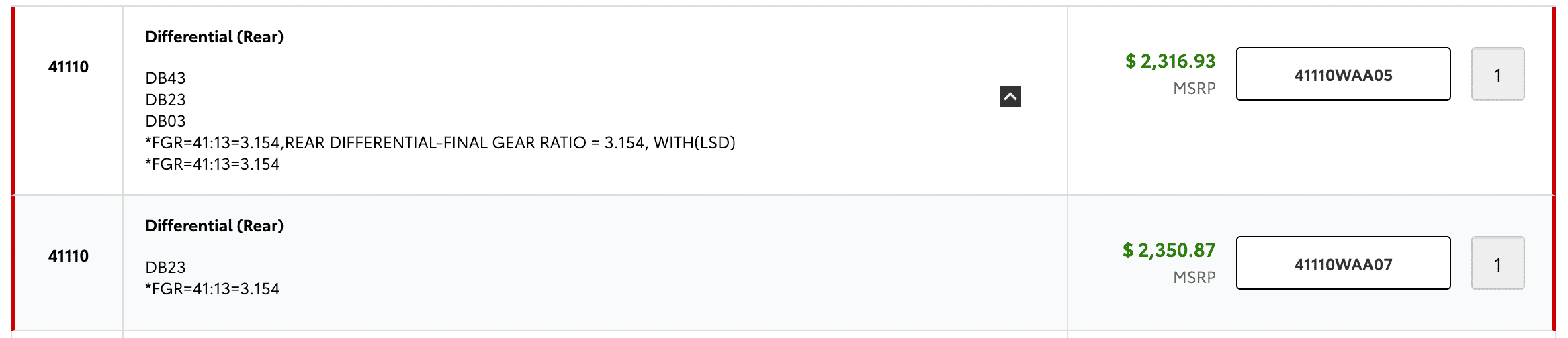

Apparently, the 4 banger has an open diff as well. 😂
The 2.0 Supra in the US has an open diff, no LSD.
I'm not sure why people get so pressed about the Z's existence. It looks like a fine car that has a number of compromises depending on what trim you get, just like the Supra is. Nissan just chose different things to compromise on.
Personally I feel a base model manual Z offers better sports car value than the 2.0 Supra, but if I'm buying a car so I can modify it to make it better, I'd start with a GR86 which is a better driver's car than both the Z and the Supra. But some people want horsepower, so they'll get the Z, and some people want a nice interior and better NVH, so they'll get the Supra. Sounds like we have plenty of good options in the market these days.
When the 2.0 was launched all those years ago, I asked the Toyota USA team and they confirmed that it was an open diff.
I had a press car for a week and did a LOT of driving, including drifting. Unless the clutches were smoked on that thing, it was an open diff. Drove completely open, absolutely 0 lockup on accel/decel in both dry and wet.
So I jacked the car up and checked in Neutral, and sure enough the tire spin test confirmed it was open with the other side spinning opposite. The M-Performance Diff that should have been available is a clutch type (not a Torsen) so it should have spun in the same direction.
So unless they've added an LSD since then, its certainly open.
Good idea.
These are the two part numbers for diffs for Supras. WAA05 is the eLSD in the 3.0 Variant. As you can see, it says "WITH(LSD)". The other is WAA07, and does not mention LSD.
