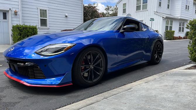

  • Nismo Front Bumper

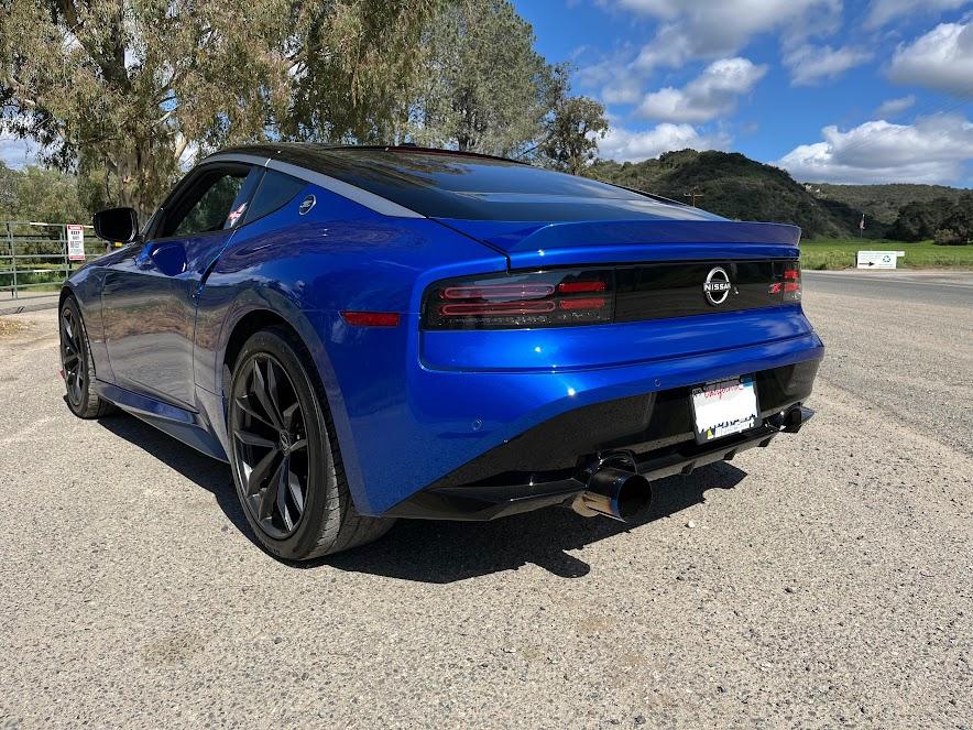

  • Tomei Expreme Ti Single Exit Exhaust and Y-pipe

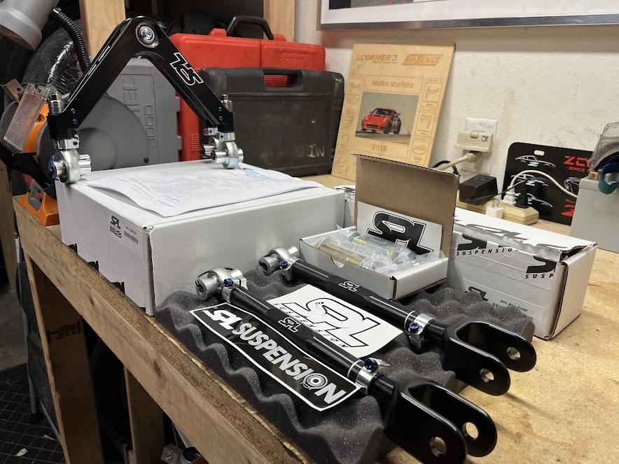

  • SPL Parts Rear Camber Links and Eccentric Lockout kit

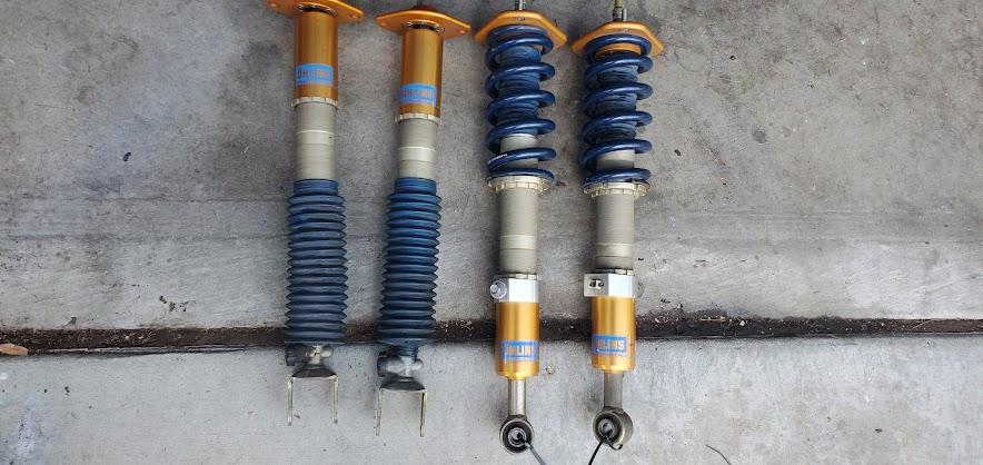

  • Ohlins Mines ESTA Coilovers w/ HyperCo springs

I’m interested in hearing you car, and seeing a db reading. I’m eyeing the Tomei exhaust and am curious how loud, it may be. Thank you in advance. I’m following your build.

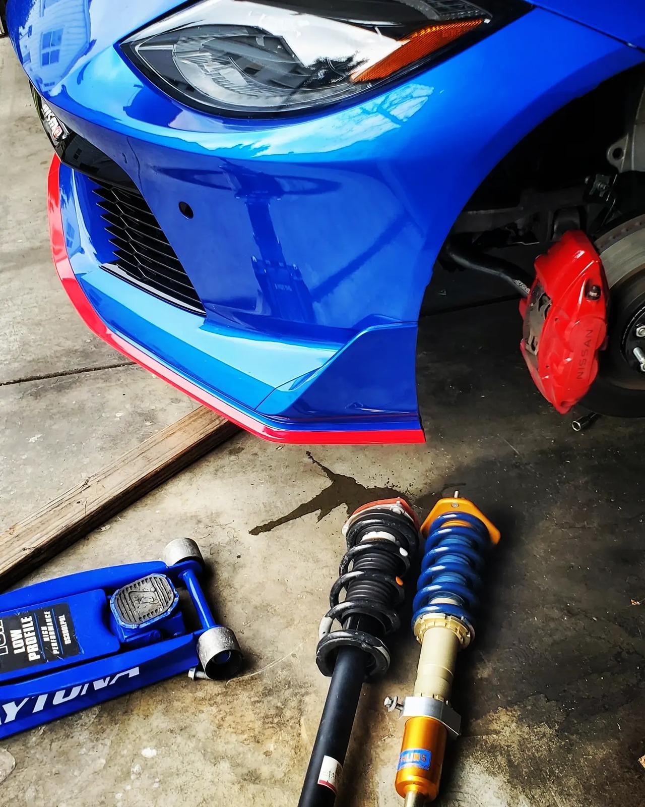

  • Ohlins Mines ESTA Coilovers w/ HyperCo springs (Hoping to knock these out this weekend)

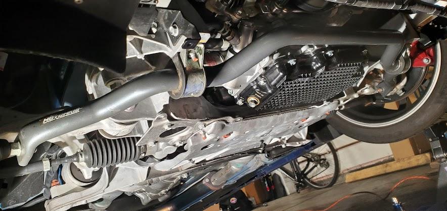

Why only the front sway bars?
A stiffer rear bar plus stiffer coilovers is a great recipe for inducing snap oversteer in the Z34 and RZ34.
Most of the Z track rats run a very soft rear bar (stock or slightly stiffer) or no bar at all.
The end result is usually something like this.
That was my first track day on coilovers, with the stock rear sway bar still attached. Needless to say, but that bar came off immediately after that.

are you planning to continue with the nismo esthetics around the rest of the car?

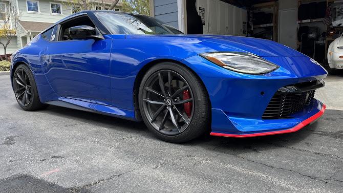

Unsure at this time, waiting for more options to become available for body kits. I'm still on the fence about the Nismo rear bumper but who knows it might grow on me more as time goes on.

I'm interested in a few additional details that may also help other members with this conversion. Did you need more than just the bumper to make this work? According to Z1 their kit has a number of additional pieces needed besides bumper and only has a few color selections. Was hoping maybe you could help clarify the parts and what not or where you sourced them please.

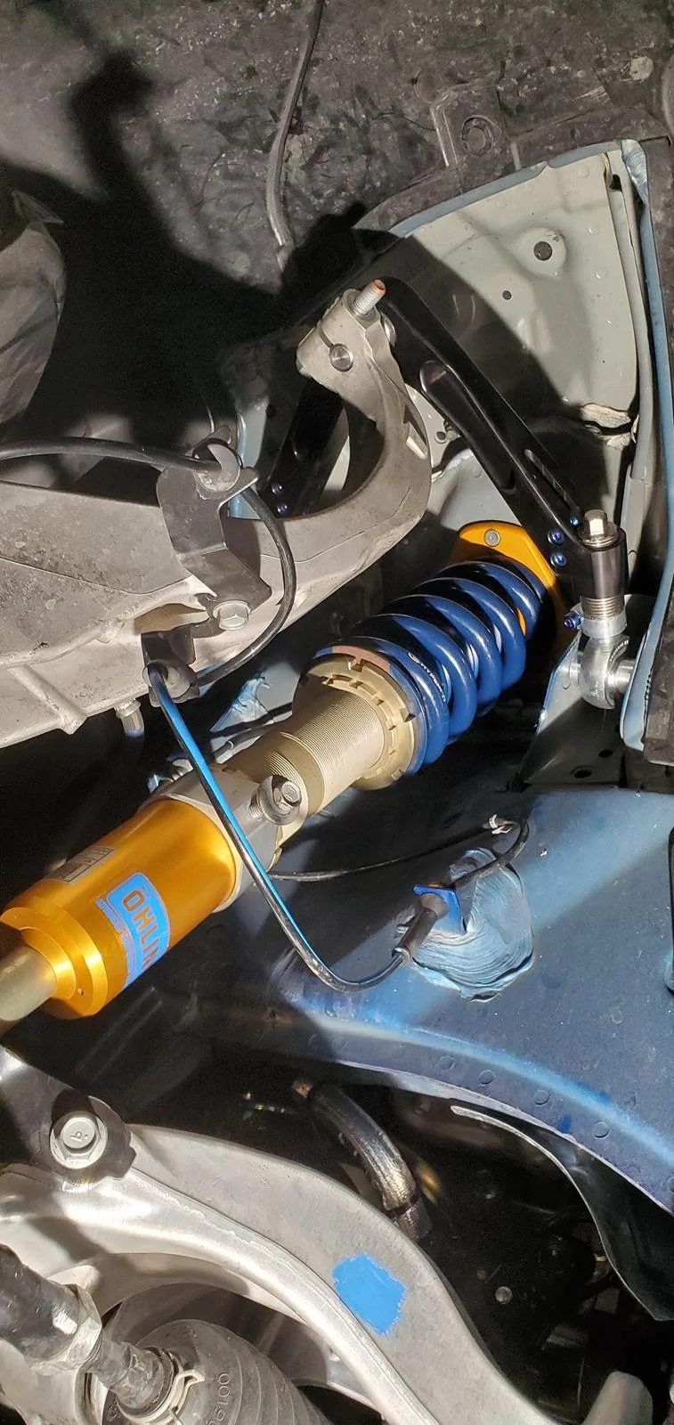

I'm actually not a mechanic. I'm a software engineer by day, togue/canyon carver by night and time attack driver on the weekends.
I learned a lot by researching forums like this, making friends with people who know more about cars then I do and getting their help whenever possible. Last time I did a coilover install on my 370z I had help from a group of friends and I learned enough by watching and doing to be able to do it all on my own this 2nd time around when I did it on my RZ34.
I'm going to give you a hint about this car, although it is very new, it shares a lot of similarities and common parts with the Nissan 370z. If you cant find what you're looking for here or on youtube, I recommend you try https://www.the370z.com or try searching for whatever you're looking for but for the 370z instead.
Spacers are very easy to find the right specs for and install. If you know how to remove and mount wheels, you're half way there. Spacers only go on one way, which is over the OEM studs pressed into your wheel hub. If they dont fit, then you have the wrong spacers. If they do, all you need to do is torque them down to the factory spec for your car which should be around 80 ft/lbs of torque. Finding this info online should be really easy.

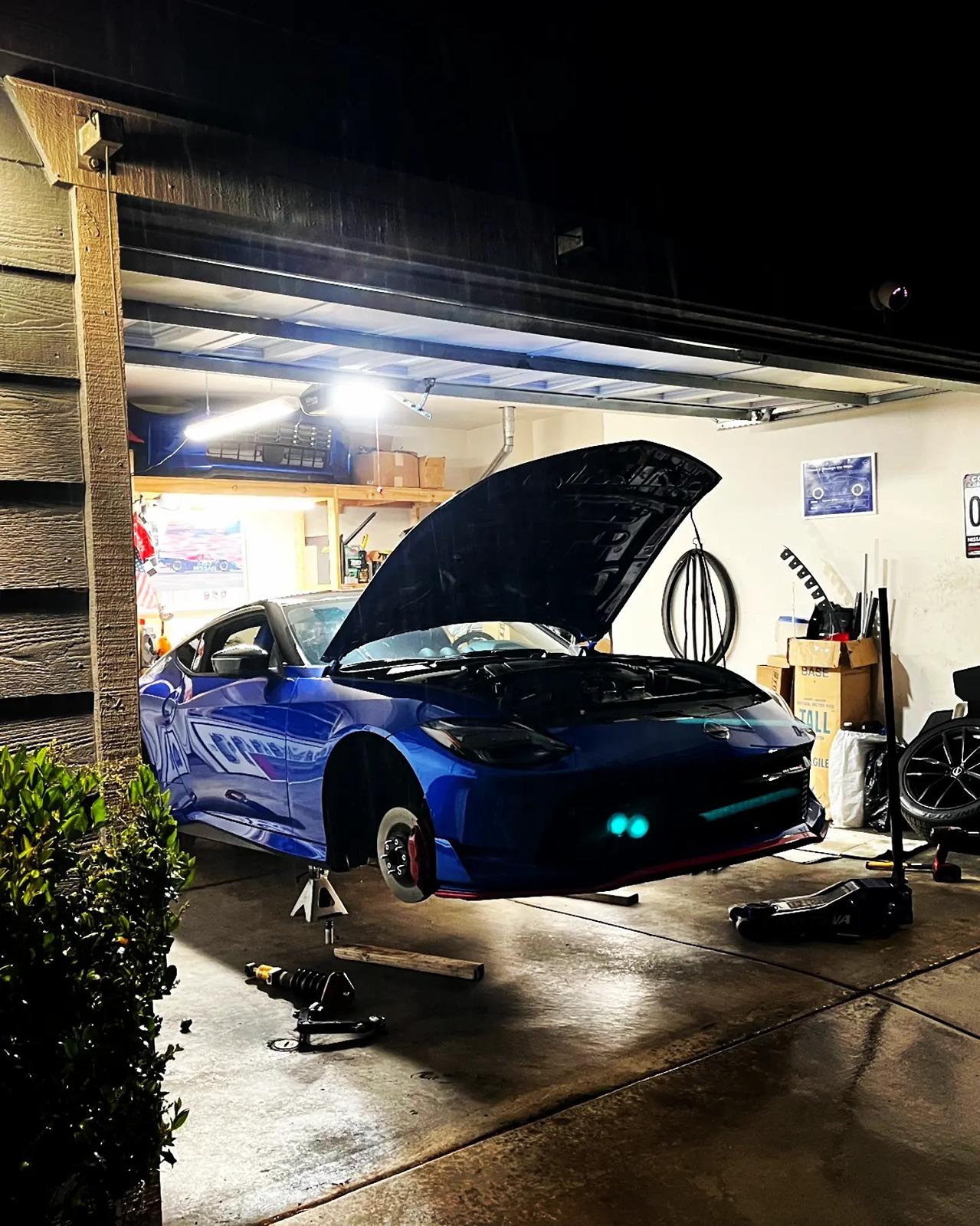

Replacing the front springs on a 370Z or a 2023 Z is a little trickier as you will have to compress the springs with a tool to remove them from the strut. Be warned this step can be dangerous because if those springs are compressed and they release suddenly it can cause death, serious harm, injury or damage to things/people around you. I've never done it before myself but know many who have and it is sketchy, if you don't know what you're doing please get help or take it to a shop.

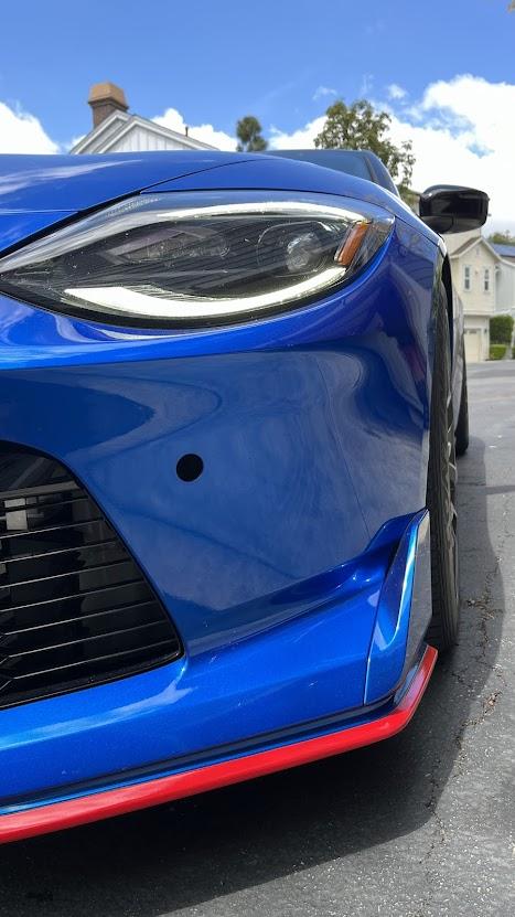

Thanks @chuckz, I appreciate the compliments! I don't have specific part numbers on most things but I can roughly break down what you need, there's a few more parts that need to be on this list but these are the major ones.
  • Front Bumper Fascia
  • Front Grill
  • 2 x Winglets (Front Bumper Moulding)
  • 2 x wheel well spats and rivets
  • 2 x headlight brackets and rivets
  • 2 x inner sensor brackets
  • 2 x outer sensor brackets
I recommend you reach out to John Capati at Corner 3 Motorsports, I ordered my parts through him.

Thank you! I have managed to get a list of most of the parts. Some listed here I'm unaware of from research. I was going off Z1's conversion list on the Z1 website. I may have to reach out to them. I appreciate the feedback.
