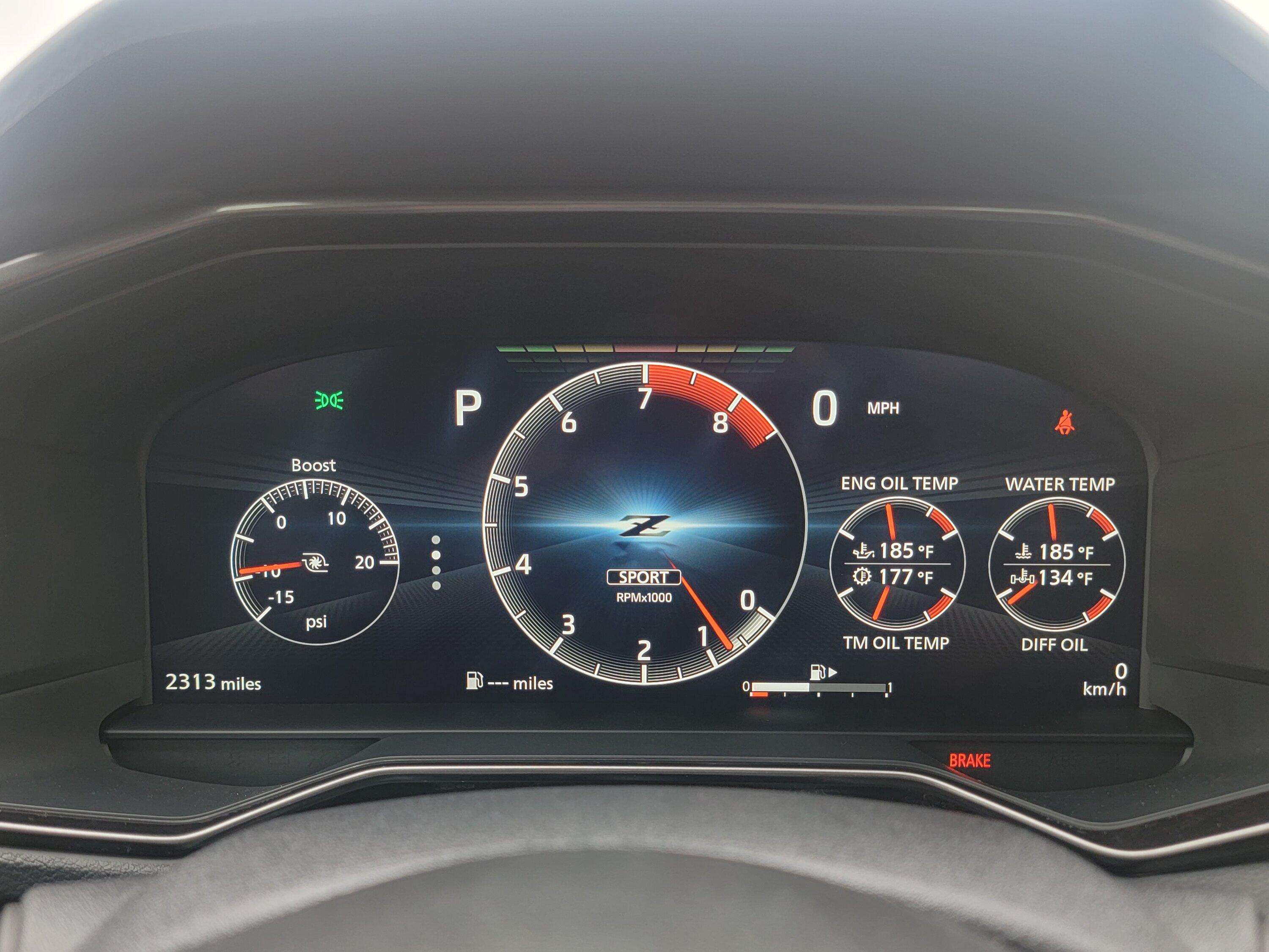

Yesterday I put in some gas and the fuel range monitor stopped working. The fuel gauge shows I have gas but the fuel range isn't registering. Anyone ever have this problem or know of a solution? I took it to the dealership and they said it might have been a sensor issue.

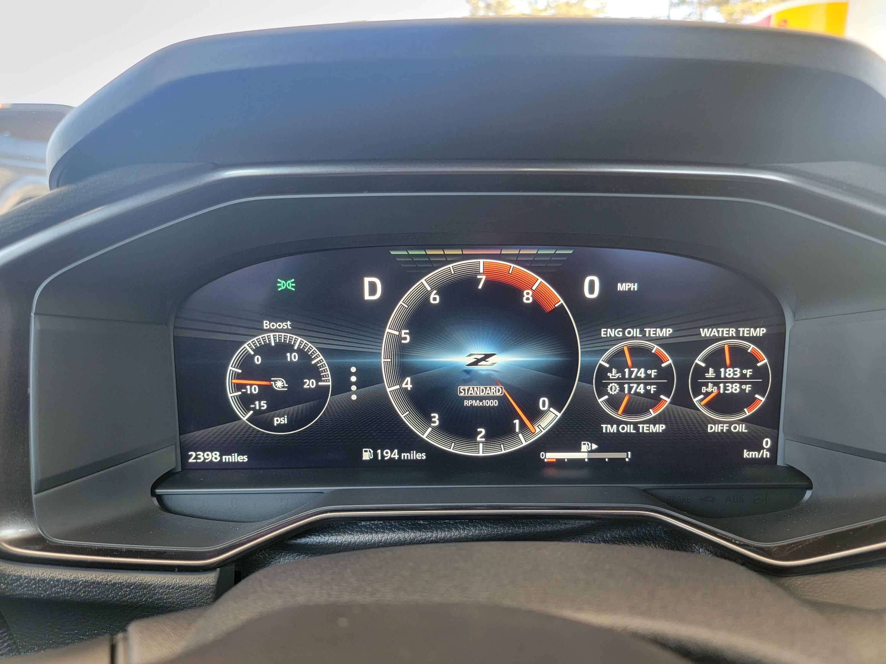

I had the car on when I filled up. I guess that's a no no. So the tech at the dealership said to fill up again with the car off and it should be fine. It's working well now.

The DTE display blanking out, especially when the car was left on during refilling, is totally normal.
The computer saw the level go up, so it has to wait until it stabilizes before it can display a new DTE. This has happened on my older vehicles too.
