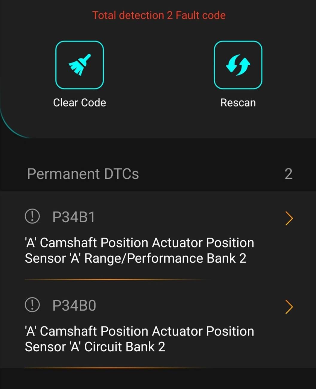

Purchased a brand new Nissan Z 3 weeks ago in Australia only have 500 kms on car check engine light on vehicle in limp mode my codes are P34B1 and P34B0 I have an appointment with Nissan on Tuesday next week.

Did you try to just simply clear the codes and see if they return?

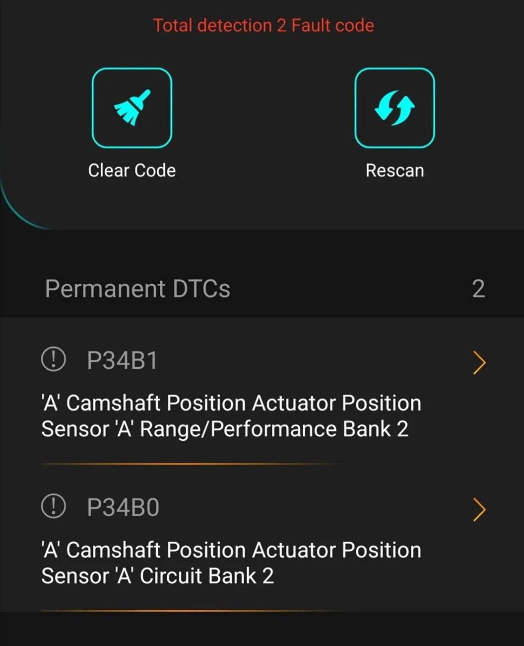

Yes clear code and started vehicle light was off turned off vehicle then code reappeared after I restarted vehicle thanks heaps for the reply

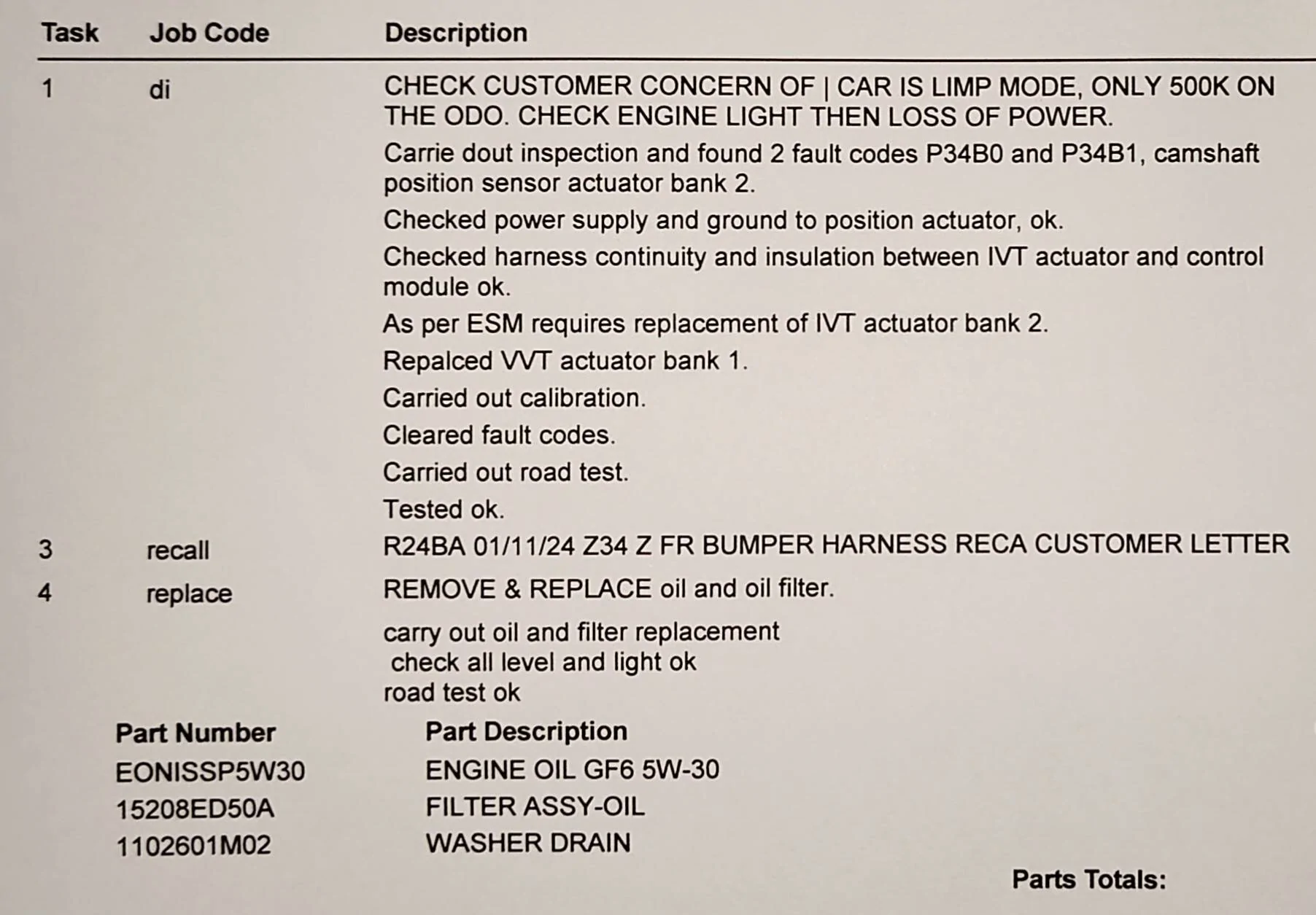

Glad to hear. I noticed they used 5/30 oil, was that by request or is that standard down there?
Ours has 0/20 in the states.
