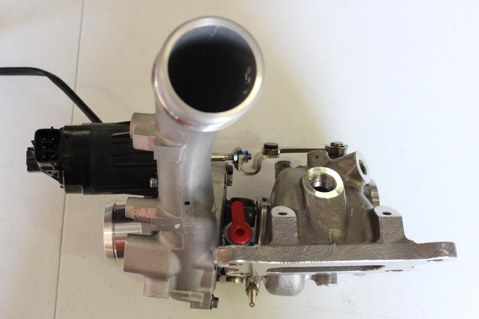

What you’re looking at is the FZ5t Turbo by Honeywell/Garrett. It is an MGT1446LKSZ. “MGT” is the current line of “Modern Gas Turbos,” and 1446 basically refers to the size. With no context, just know that that’s tiny. It’s smaller than stock Z32 turbos were. The MGT series also includes Garrett’s latest low-loss “Z” bearing CHRA. Nissan’s obsession with fast response certainly hasn’t changed!
These turbos have a couple of other tricks up their sleeves, too. First, like other MGT turbos (found on Ford Ecotecs and some other modern turbo engines), the rotating assembly is offset. Most likely for packaging.
Note that the CHRA is not perfectly perpendicular to the flange for the exhaust housing and compressor inlet coupler flange.

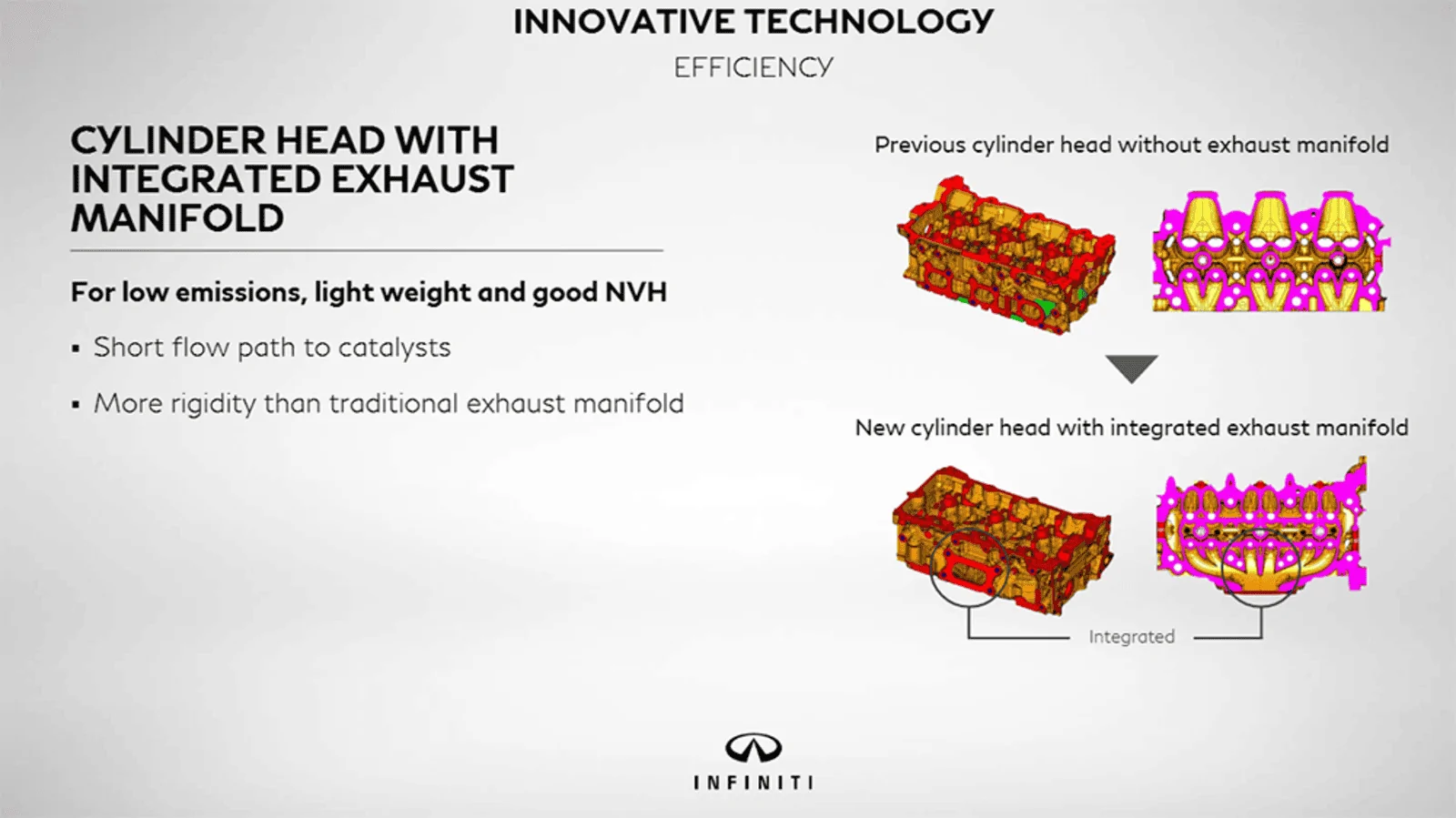

Next, can we talk about that flange? It’s absolutely massive. Which makes more sense when you understand how the turbo mates to the cylinder head. There is no dedicated exhaust manifold, but rather the runners merge inside the casting of the cylinder head, so the turbo bolts directly to the head.
Also in this flange Nissan has both an up-stream (pre-turbine) oxygen sensor as well as an EGT sensor.
The larger port is for the oxygen sensor, and the smaller offset port is for the EGT sensor.

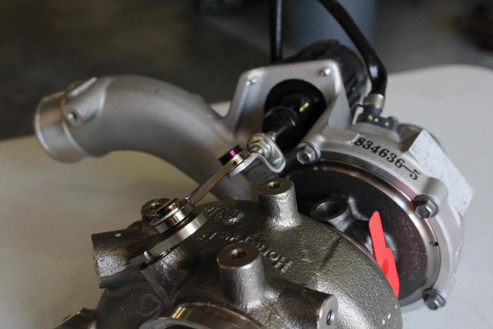

Moving on, check out the wastegate actuator. Gone are the oldschool pneumatic actuator-type, these are fully electronic.
Electric Wastegate Actuators
These give the ECU a lot more control over the boost level, which is one of the things that allows the RS to push these turbos to their limit. I also find it somewhat interesting that the “bracket” for the actuators is basically cast into the compressor housing. And it’s difficult to see, but the wastegate flapper’s resting position is open. Chances are this is a failsafe to prevent the car from building boost should something go wrong, and the ECU snaps them closed when the car is powered on.

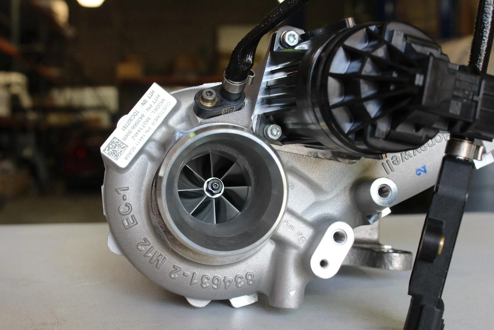

Finally, here’s the front of the turbo. There are two points of interest here:
First, check out that compressor wheel. Sure it’s tiny, but more importantly it’s billet. This makes it a hair lighter, and also increases the blade surface area without increasing overall diameter. This is what Garrett started doing with GTX turbos, so it’s nice to see this technology make its way to smaller, OEM turbos.
Also, just above the compressor wheel you’ll see the compressor wheel speed sensor so the ECU can monitor that as well.
