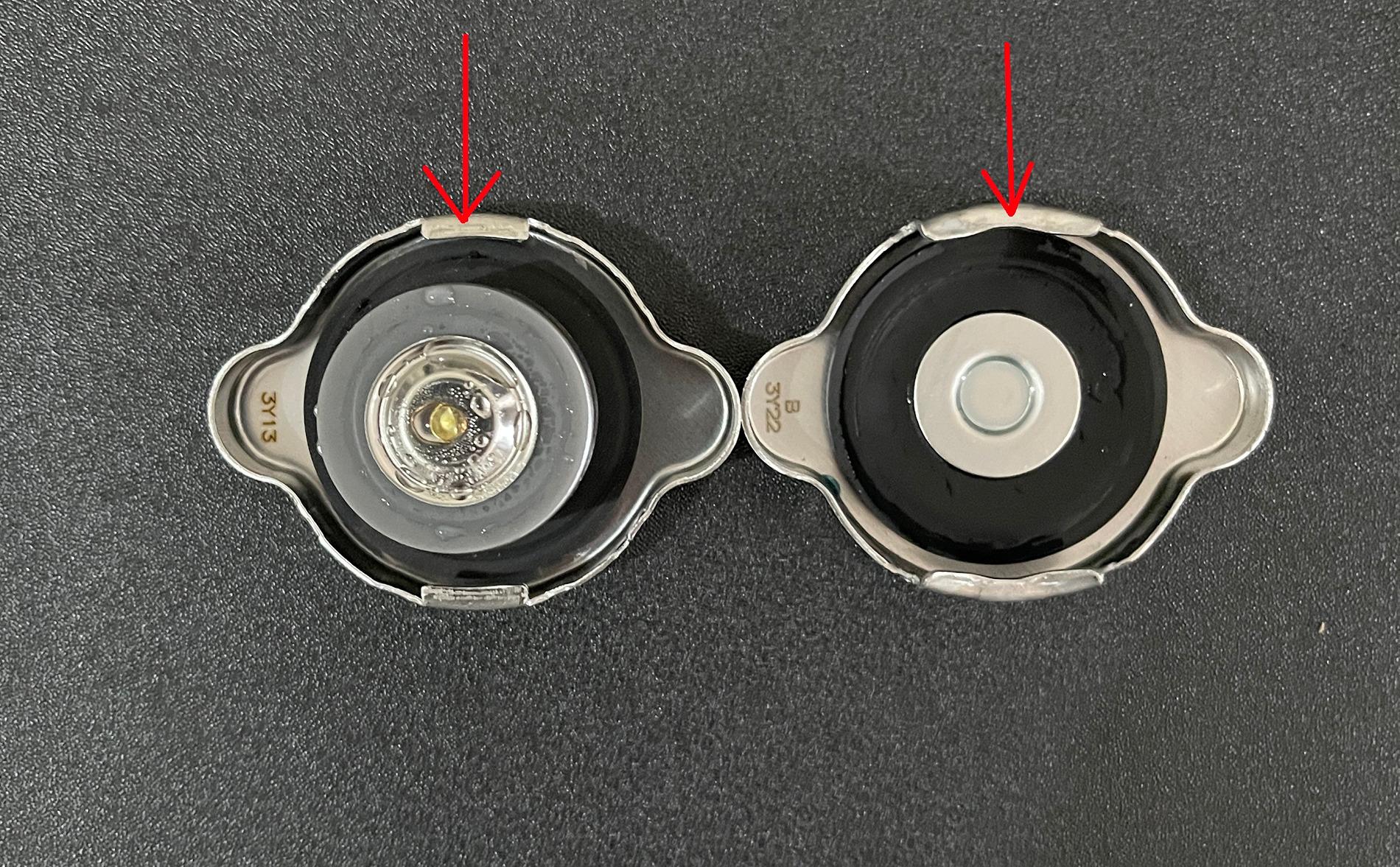

Quick question about the 2024 Nissan Z radiator caps. OK, so the 2024 Nissan Z got 3 freaking radiator caps???
Which radiator cap do you open to put new radiator fluid in? Or do I need to open all 3 radiator caps and put radiator fluid to all 3 caps?
Also, on the second picture the radiator cap on the LEFT got a smaller metal male groove than the RIGHT radiator cap. Why is that, does anyone know? The LEFT radiator cap is the same cap shown on the first picture (cap #1).
In the first picture, what is the top radiator cap called on the #1 radiator cap?

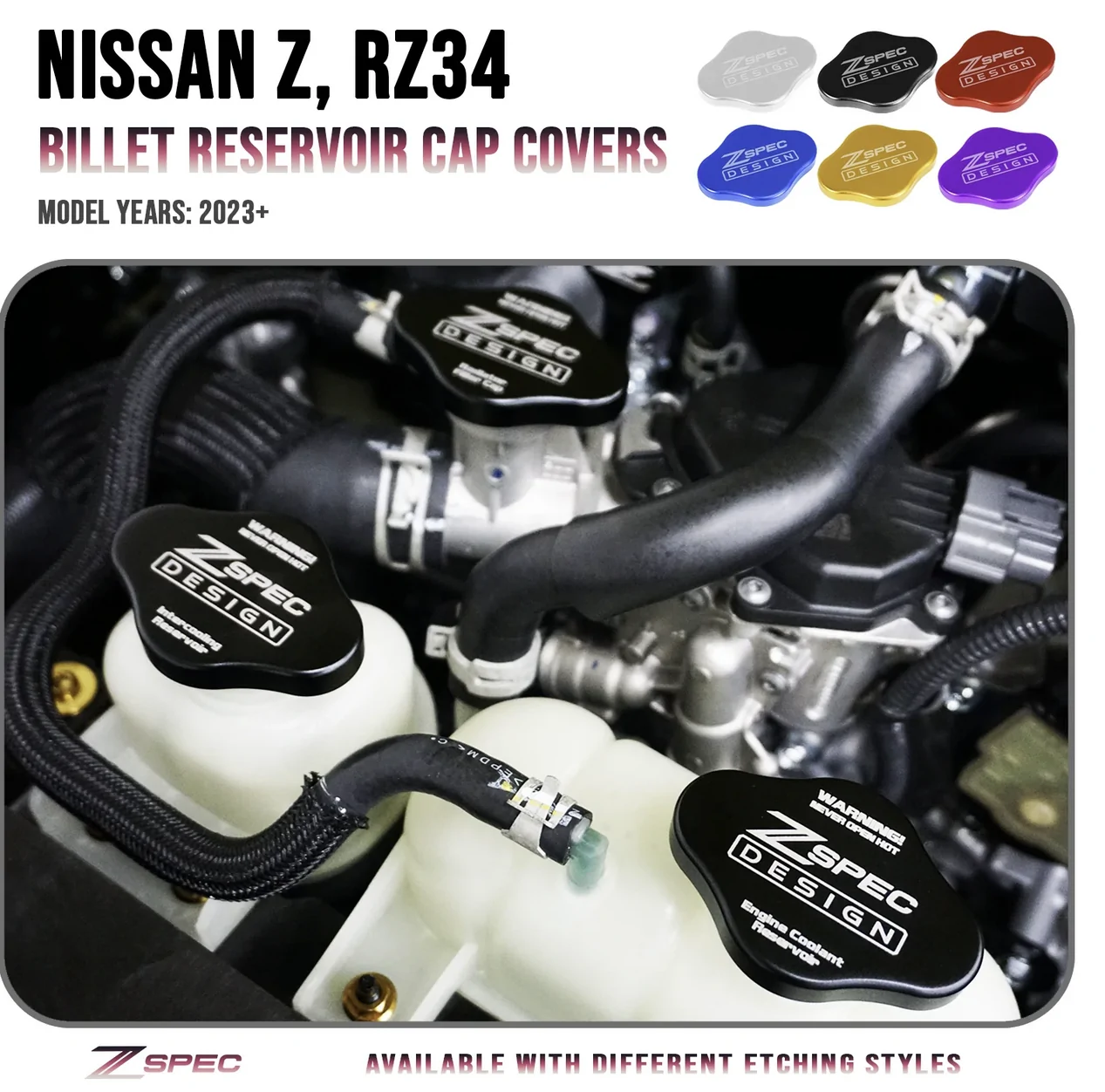

#3 is the main reservoir #2 is the sub tank for the heat exchangers. Both of those tanks are pressurized thus the spring cap
You don't mess with #1 leave it be and if you swap out caps for the higher pressure ones like NISMO you only put those caps on 2 and 3. 1 is just the line for the fluid and isnt pressurized so it doesn't have the spring cap

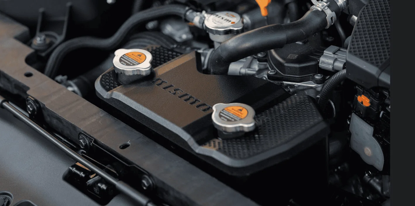

2 and 3 use the same coolant. 3 is your main reservoir when it is being serviced. 2 is just an additional reservoir tank for the intercoolers. you can add to it but you probably wont need to. im not sure why they did 2 tanks like that on the Z.. NISMO USA had a larger capacity tank they never came out with but it was just one single tank.

this never came out but you can see the idea of how it works
disregard the nismo cap in the wrong place in their own pic lol

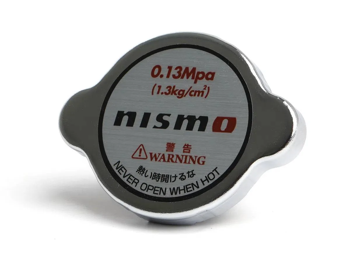

Looking at the Nismo radiator caps, it seems like the stock cap is 137kpa and Nismo is 130kpa/0.13mpa. Does that mean performance wise, it's better to just leave it as stock?
