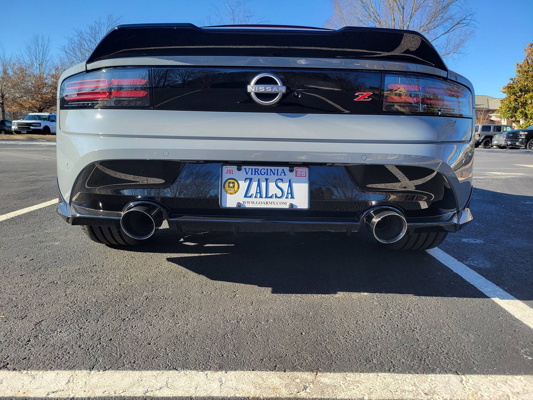

Bought and installed a Stillen Catback exhaust. Had to spend extra money to get it to fix correctly because the hangers and plate the holds the pipes are misaligned. So, there was no savings .... poor workmanship
I see you list your occupation as Team Lead QA..... Any pics?

No, because I took it back to the muffler shop and they told me that they would need to do some modifications to the brackets to get it properly align, because it could not be aligned properly as it was. Anyway, I bought it from Z1 back in November 2024 and didn't get installed until recently due to the Winter months. So, the return period is way past anyway ...

@papozalsa are the exhaust tips centered in the lower bumper? Might just be the perspective of your picture....

NOPE, the hangers and plate do not have any wiggle room to get them center.

I finally had a Shop straight/center the Stillen exhaust on the bumper outlets Happy with his work.
